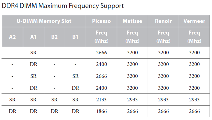

One every 4 hours sounds bad. Are you actually running them at 3200Mhz or the 2933 that the motherboard supports?
I copied (approx. 80 TB) data from one TrueNAS SCALE build to the other for the last two days. The errors occured even more, I guess about hourly on both systems.
The memory runs at 2666 MT/s. When using only 2 sticks they were running at 3200, when using 4 sticks they are automatically lowered to 2666 MT/s, which is also noted in X570D4U manual:
