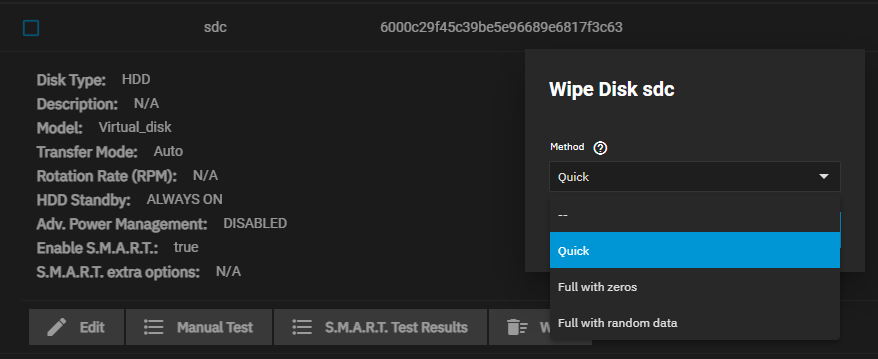

While it is certainly difficult to recover data from a single member of a ZFS vdev, I wouldn't say "impossible" especially in the case of mirror vdevs and very small files. If you're interested in protecting your data, I would suggest performing a "full wipe" before returning it - this can be done through the TrueNAS UI for disks that aren't a member of any pool under Storage -> Disks
Disks that are members of an encrypted pool or are SED (Self Encrypting Drives) with an active password are a different story, and are cryptographically secure.

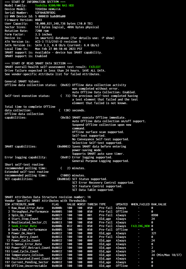

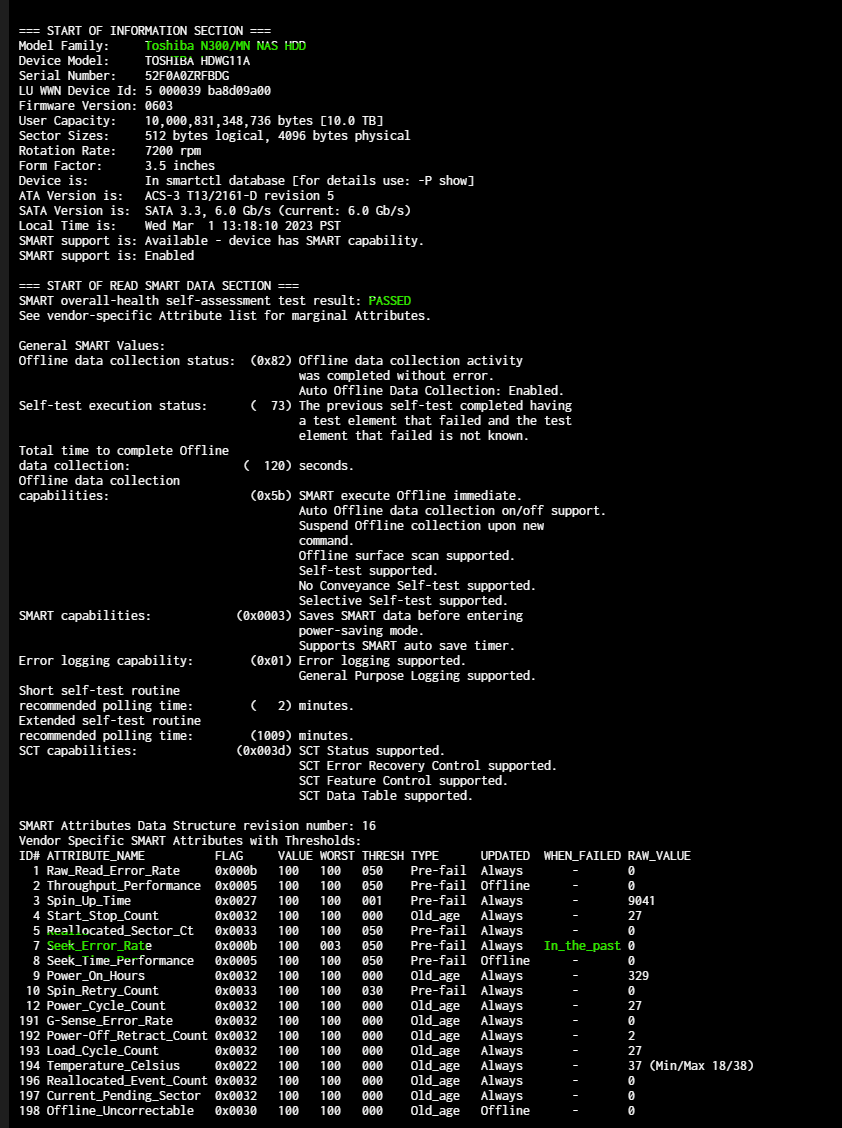

So I've already replaced one of my Toshiba N300 with WD Red Plus and after the replacement I noticed the smart test for both of the bad drives passed. The bad drive that is still in the pool (going to resilver that one soon) and the one that was just replaced. Does it seem strange that the messages went from 'failing now' to 'in the past'?
Either way they are being sent back this weekend, but thought it was interesting that things changed.
Also I should mention the replacement/resilvering process is pretty straightforward. The first drive took 3 hours to resilver (Pool size is 18TB(raidz1) and used is 2.8 TB). I wasn't sure what the time was going to be, but looks like they both will get resolved today.
systract
Oct 7, 2022
32
Was it long or short S.M.A.R.T test?
Treddit700
Jan 25, 2023
12
It was a short SMART test. I didn't even bother running a long one once the RMA was issued. I instead just added 1 WD RED plus at a time. Once the new WD RED was in and had replaced the Toshiba N300 I ran the short SMART test as I was curious.
