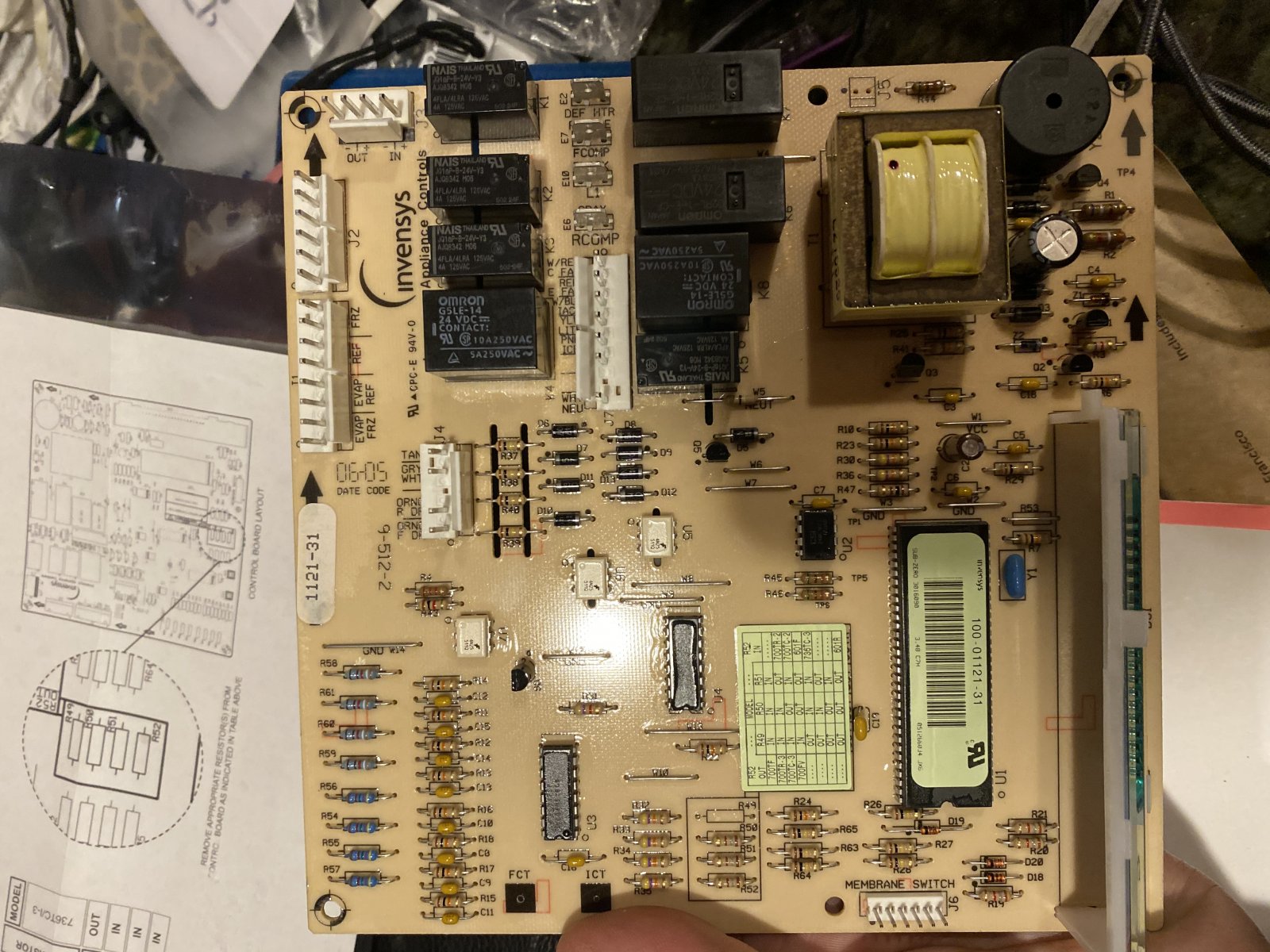

  • .... discovering a refrigerator with a mind of its own after a recent electrical fire next door (kids, don’t play with backhoes near overhead power lines).
  • Calling the OEM, speaking to humans, getting directed to the right help on the first try, and better yet, a competent professional! Whoohoo!
  • Diagnosing the issue together in a matter of minutes and getting the local service company dispatched
  • Having the local service company follow up by telephone within a day, attempt to schedule a repair, realize they cannot come out before Jan 20, and so now what... I don’t want to wake up to rapidly decomposing food.
  • Well, the door alarm beep location suggests that the controller lives inside the fridge... so take a look, find the controller under the light cover, order the part, receive same next day, install, and all is well.
    now the spouse is happy, the fridge no longer turns off randomly and we can enjoy Christmas.

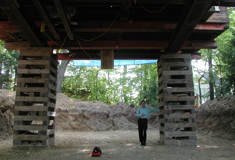

I do turn off power consistently, but I'm also aided in that when we rebuilt this house, I went whole hog re: power outlets. We have a 400A service not because it's a big house but because I had them put in three full-size circuit breaker panels as I wanted all lights and outlets to be on separate breakers... and that takes up a lot of panel space! I love good infrastructure and a gut job gives you the blank canvas. Thats the core of the house above me after we pulled out the old foundation. The tool bag next to me was for the 5-axis self-stabilized laser to "fix" the house corners on the ground below.
The new foundation is reinforced with #4-60 rebar, 12-14" COC. Phillip Brooks, our wonderful structural engineer laughed when he saw the specs and and observed that the commercial foundations he usually worked on weren't built that strongly. May he rest in peace, the 2017 Halloween spider crab was dedicated to him. I wired a bunch of the rebar in that foundation.

@Constantin That is a lot of cribbing in that photo! Impressive to say the least.
Constantin
Vampire Pig
May 19, 2017
1,829
By then we had gotten used to a house in the air and backhoes below. Was really scary in the beginning watching guys sledgehammer gaping holes into a sick foundation and needle 9 sideways I beams and 2 larger front to back I beams through it all. Then Jenga blocks from below and then the lift began, 17” at a time. Two towers per main I beam, 4 towers in total.
once the house was up 4’ 11” we called it a day and watched as some of the remaining foundation walls collapsed on their own without the house compressing them from above. Between clay soil, bad water management, and a rubble foundation below ground, there was little in the way of failure.
also instructive was pushing the mud sills back together as the joists for the ground floor had fallen out of the main beam. That was done as soon as the lift was complete. The house jumped when the joists and the main beam finally got back together. No nails had been used for the joists way back when, they relied on gravity. It’s a bit different now.
Plus, the main beam no longer has anything but a compressive load as the LVL below it carries all other loads.
