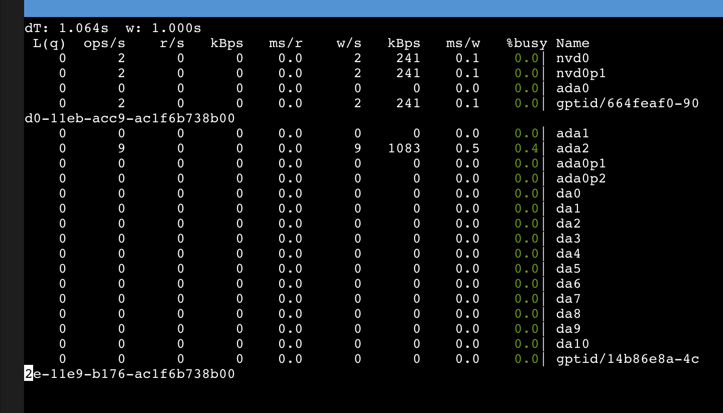

The posting below is what also happened this afternoon.
I/O suddenly slowed to a crawl. renaming files takes 10+ seconds, even deleting empty files in a share takes over 5 seconds each. My CPU utilization for one core is consistently 100% (SMBD) yet I don't know why the I/O should be slow considering a 10GbE connection, a Optane SLOG, a sVDEV metadata/small files pool, and oodles of free HDD space (pool is 25% full).
Where should I start looking?
Only thing that comes to mind is "gstat" - but it sounds totally strange that it has dropped like that
It doesn't look terribly busy. Pool health is good also.
