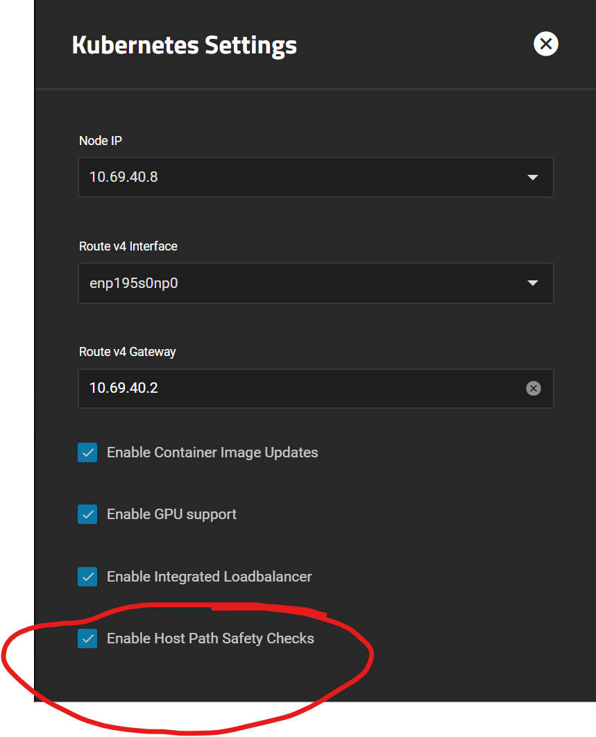

Your biggest problem most likely is the hostpath validation which prevents apps from launching if a smb share and hostpath use the same path.
You can disable that hostpath check in the advanced options of your apps pool.

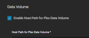

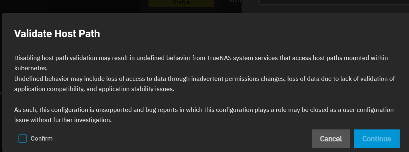

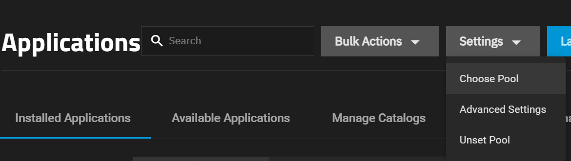

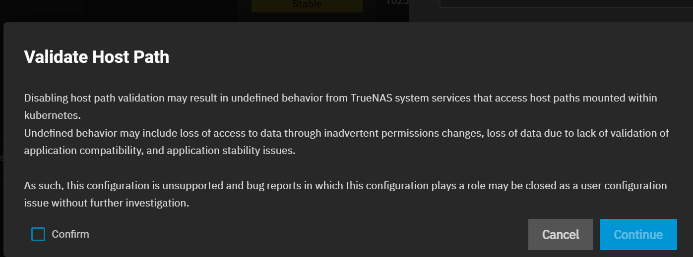

This forum post describes the problem you are experiencing and why it does not work out of the box how you intend to. Read that thread before proceeding.
If you understand and accept the risks in the above post you can make it work by doing the following:
In applications, Click on Settings, Advanced Settings
Uncheck this box:
And accept the warning here:
Good Luck!

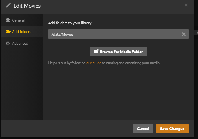

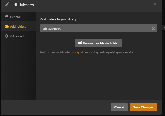

Ive had no issues doing it this way, other than on a restart. I have to disable the share, restart plex, then reenable share.
In plex library setup, i use the following path.
The movie folder is a sub of what i configured in Plex app settings of
Uncheck this box:
Good Luck!

I already did this, but no luck
Not sure of you just clicked the wrong path in config, but your pointing to the wrong folder. You selected Pconfig when you should of selected media. Im just looking at the pic you posted. As for ACL settings, Here is what mine look like. User = My login for Truenas, and when i mapped the network drive on my windows pc i used my Truenas login info.

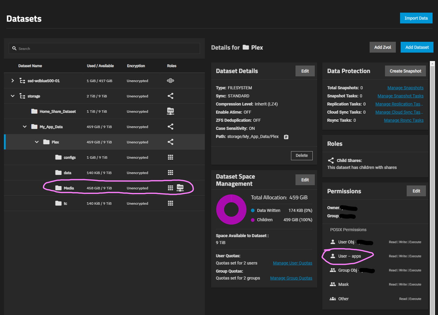

I know I wrote I was giving up but I couldn't let it go.
I gave it at last try, and behold I got it working.
It all comes down to ACL and SMB
I created 3 datasets ,
The first dataset for plexdata: "Host Path for Plex Transcode Volume" and "Host Path for Plex Config Volume" and the second dataset for plexmedia "Host Path for Plex Data Volume"
The third dataset is for VMs
All are set up to "Open POSIX Permissions" as I am the only one accessing the computer (at least for now)
All are the set up as SMB shares using the "Shares/WIndows SMB Shares"
I then created folders i needed and copied all the files I needed
Deactivated all SMB shares and ran the Official plex setup
Plex installed without any problems, and started successfully. I could then setup the plex libraries and voila I could se the video folder, music folder and photo folder.
Plex seemed to work very fast as did the VM i created. (The Vm was somewhat slow on the core version on the same computer)

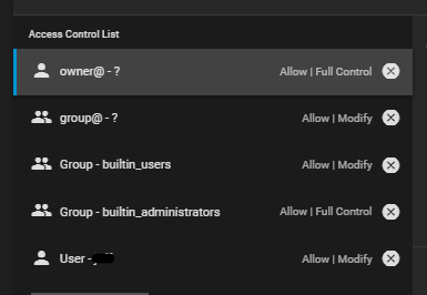

  • General ACL permissions for app access to shared folders (i.e. a "Media" folder where you're keeping your Plex media libraries which you also want to access through an SMB share)
Consider adding the built-in "Apps" user to the ACL for your Plex media folder(s). This is what I've done, and I have had no issues getting Plex to see all of the media in my various folders and libraries.
Ultimately, you should not have to stop SMB shares in order to start the Plex server and have Plex recognize media in your libraries.
