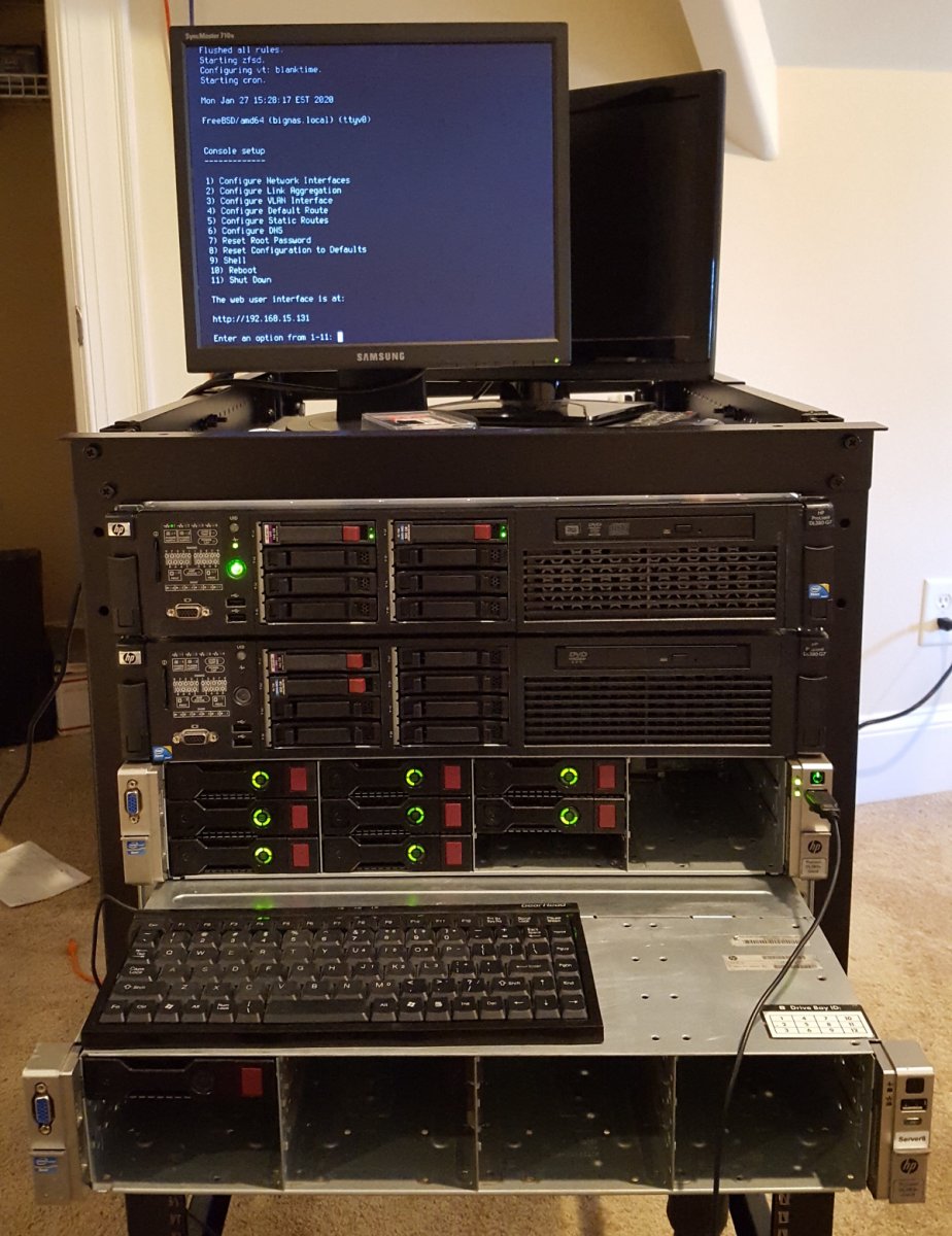

According to the changelog for 11.2-RELEASE, the boot process was changed - so there could definitely be an issue with thumb-drives. If I were you, I would try two things: 1) try re-creating the boot drive while it is plugged into a usb2 port. Don't create mirrored boot drives - just create a single drive and see if that makes any difference, and 2) try a different brand thumb-drive (a different drive will have a different controller).
When I used to boot off of USB flash drives, I always used Sandisk thumb-drives. Often, one went bad when I tried to update FreeNAS. Sometimes, I could take the bad thumb-drive and reformat it for windows - but usually not. After I switched to booting off a small SSD, all these issues went away. I did not look into the matter any further once I started using an SSD for boot.
I'm using a Patriot 8GB thumb drive (just one) to boot up my HP Proliant DL380e Gen8 and it works like a champ. I have another using a different Thumb drive and it works great as well. Both machines are using Seagate ES2 or ES3 SAS drives for storage. One having a dozen 3TB drives and the other with five 3TB drives. System performance seems tip-top to me... I put the boot drive INSIDE the case on the motherboard in a socket meant for boot drive. I also have a SATA boot disk in another DL380p Gen8 and notice no difference in boot performance... other than speed... I used it because of an experience with a IBM/Xyratex HS-1235 which had a USB conflict causing extremely poor USB boot speed. Perhaps your boot issues are USB related!
