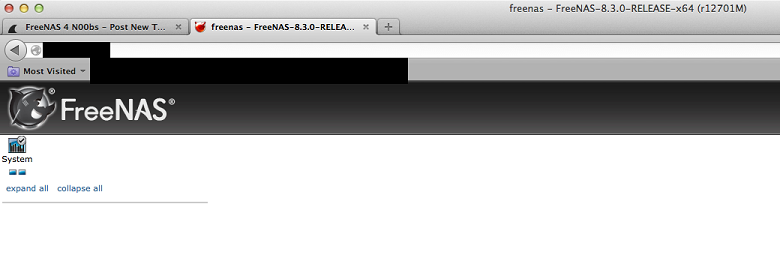

For some reason when I open the web gui to my FreeNAS 8.3 device the logon page works but the main page after that only partially appears.
There is nothing I can click on and no real data comes up. (See Attached Screen Shot)
What I have tried…
No matter which browser (IE, Firefox, Chrome) or platform (MAC, Win7, Win8, Win2K8, or Win2K12) I use I get the same results.
I have rebooted the FreeNAS device
What I’m wondering…
Is there some sort of device cache or log I might need to clear out to reset the web gui?
I’m not quite sure how to fix this any advice is most appreciated.

reset web credentials on the machine?, I think its number 7 or try updating it to FreeNAS-8.3.1-RELEASE-p2

Thanks for the suggestions...
I have tried resetting the web credentials, I missed listed it earlier, and the results were the same.
I have thought about upgrading, but is there a specific fix listed in the upgrade that resolves this issue?
If not its not worth the bother.

It might be because your USB key got corrupted, but it is impossible to say for sure.
Only way to know is using the webbrowser in developer mode and check the console.
Best course of action would be get the config you've saved or install it again in another USB and try it out.
