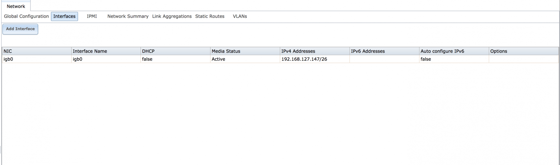

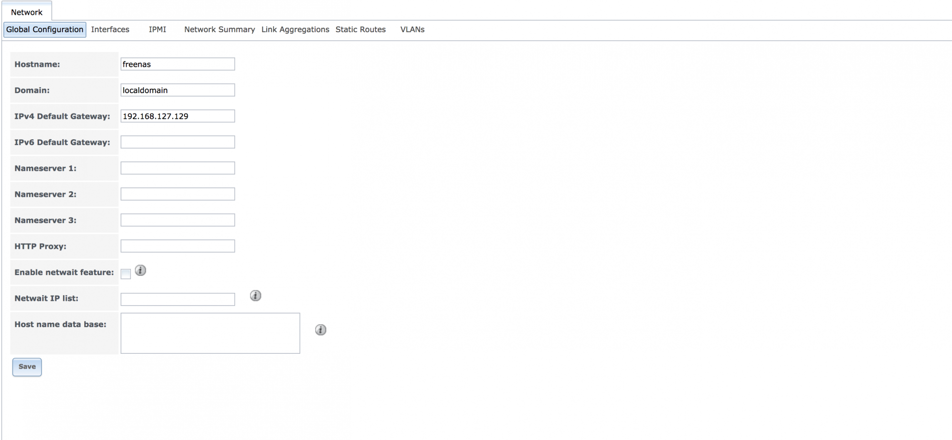

Okay, if this isn't confusing enough....
I deleted the network interface configuration and set it for DHCP, then I restarted the server and my switch. When everything was back up, the server said that there were no interfaces configured. I set the default gateway and I was still not able to access the web gui. I go to the network switch and see there is an ip address assigned, so I configure the ipv4 for the same address with the correct subnet mask and I am able to gain access to the web gui AND the jails all have ip addresses. I feel like this is unstable because I'm statically assigning the ip address when it should be configured under DHCP, like all of the jails seem to be doing now. I've attached my settings.
Thanks for all your help so far, and for sticking with me through this.
Why would you feel assigning an IP to a device on your network is unstable? Your best bet would be to give up this notion that your FreeNAS box HAS to have it's IP address assigned via DHCP. Set a static IP address for the web gui outside your routers DHCP range and be done with all the hoop jumping you've been going through.
You're making this a lot harder than it needs to be.

Please let's use proper terminology, your pfSense netgate sg-2440 is a router, this
hands out the IP addresses on your network. I need to know what IP address you use to access the pfSense box's GUI? What ever THAT address is, is considered your Default Gateway and that IP address should be entered in your server's Global Configuration and then saved. Do that now please.
Oh, I was using the ip address on the interface that connected directly to the freenas server. Let me try the pfsense gui ip.

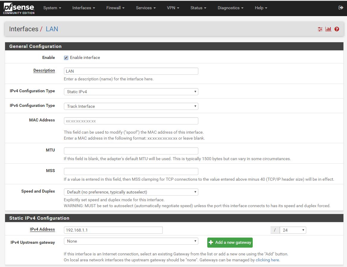

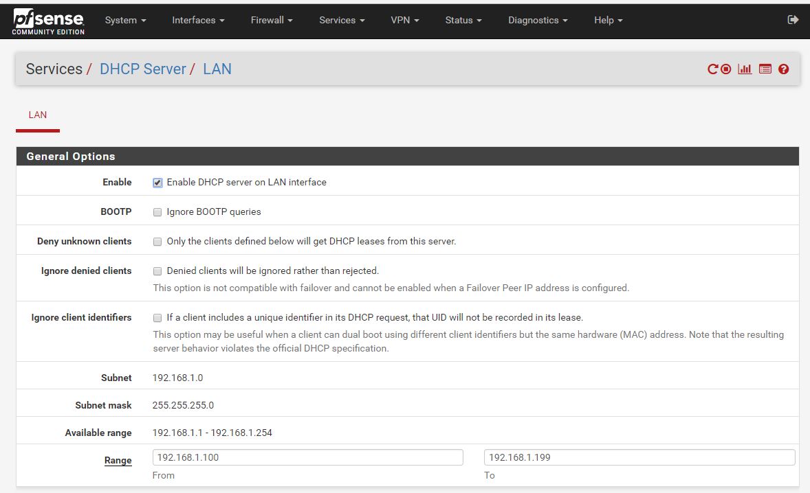

This is an example for a simple home network.
Your pfSense router has a range of available IP addresses it can hand out,
my router has a static IP of 192.168.1.1 (see the screenshot below).
My router is enabled as a DHCP server on my LAN, it's configured to give out
a range of IP addresses on my LAN starting at 192.168.1.100 thru 192.168.1.199
The 99 addresses available for my home LAN is overkill as I will never use that many.
My servers and their ipmi consoles all have static IP addresses that are set up
in the same subnet of 192.168.1.0
BUT the static IPs fall outside the range of 100 to 199.
You can set up a static IP within a FreeNAS server as 192.168.1.20 and pfSense will
give that machine NIC (and that machine NIC only) that IP address because that IP address
is "outside" your configured IP range of 100 thru 199.
