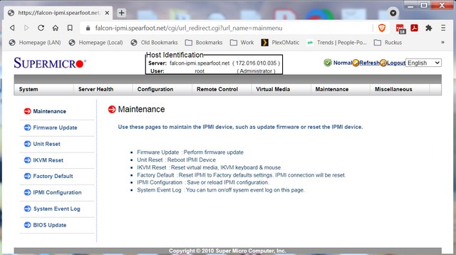

Your X9SCL-F is probably very similar to my X9DRi-LN4F+... and it sounds like you need to re-configure your BMC.
Shut down the OS on your X9SCL system. Then navigate to its IPMI web interface, under 'Maintenance': you should see options to reset the BMC to factory default, and to do unit and iKVM resets (see attached screenshot). Be sure you know the default BMC credentials -- probably ADMIN:ADMIN on these older systems -- and save a copy of your IPMI configuration. Then reset the IPMI to 'Factory Default'. After the BMC 'reboots', see if you can change the fan mode. If so, you can restore your IPMI configuration and start tinkering with fan modes to find the optimum setting for your system.
Good luck!
