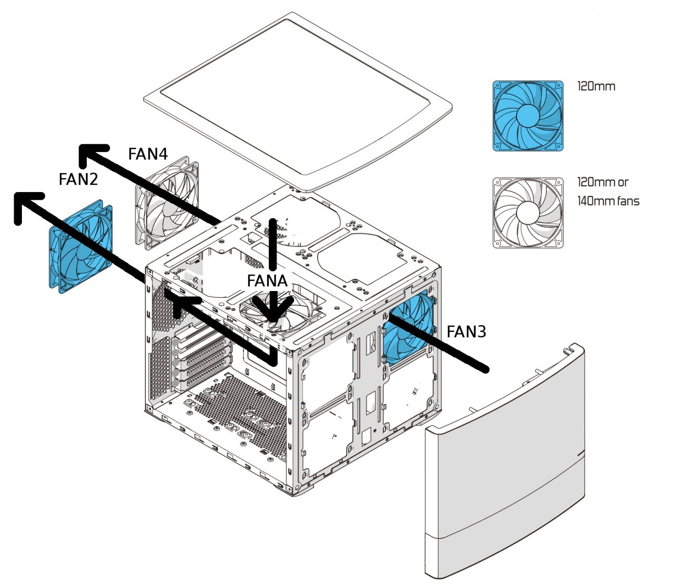

I recently bought 3 Noctua NF-F12 and one Noctua NF-A14 PWM (fan 4 is 140mm in my set up). Wen I set the up i ipmitool, they turned out quite loud, So I suspect I did something wrong, mostly likely with the sensor thresholds. Any one have any idea ?
Fan 3 and 4 are connected to the fan a header on the mobo via a y-cable, where one of the connectors only seems to have 3 pins (does that matter?) (a bit confusing with the image, I know) While fan2 and the top fan are connected to one of the other headers each.
Sensor data from ipmitool

My gut feeling is that I need a script to control them adequately. I seems to remeber @Kevin Horton (among others) had one for a similar setup.

What fan mode are you using? It appears that all fans are running full-speed so you either have the fan mode set to "Full" or the thresholds are wonky and the BMC has panicked and is running all fans at full.
Looks like your running in a Fractal node 804. This case is a "Dual-Zone" case with a zone for the system (main) board and another zone for the hard disks.
One issue is that, if the X11SSL has two zone cooling, it is likely setup like similar boards in that FAN1-FAN4 are controlled by CPU temperature as is FAN-A except in "Optimal" and "Heavy-IO" modes where the FAN-A header is separately controlled by an additional thermal sensor usually located on the system-board close to the PCIe slots. This seems to be designed so that you can have a separate cooling zone to accommodate expansion cards that get hot such as GPUs or HBAs/RAID controllers. So the dual-zone controller on the motherboard is unlikely to work well in the dual zone case you have.
4-wire fans have 4 leads; 12V, Ground, TAC & PWM. The first two and the last are outputs and provide power and the speed signal to the fans and so can have multiple fans connected to them. The third line, TAC, is the tachometer signal, and is input from a connected fan that tells the motherboard at what speed the fan is rotating. This can only be extended from a single fan. That is why one of the fan connector on your "Y" connector has three wires and the other four. The one with the four wires is the one which will provide the connected fans speed to the motherboard.
Yes, you need to adjust the FAN thresholds more. I would use 1800, 1900 and 2000 for your upper thresholds as you already have one fan running at 1500 rpm so that may be causing the BMC to panic (see the alerts in the IPMI management) and force the fans to full speed.
Your lower thresholds should likely be fine but I'm not certain if zero is a valid value.
Have you tried rebooting your BMC from IPMI? - this will sometimes fix things.
The Noctua NF-F12 PWM fans as well as the Noctua NF-A14 PWM fan are both rated for:
300rpm +/- 20% so 240-360rpm minimal speed
1500 +/- 10% so 1350-1650rpm maximum speed OR 1200 +/-10%, so 1080-1320rpm maximum speed with the Low Noise Adapters (LNA)
Take these values with a healthy dose of salt and look at how they actually perform.
If I was using that case I would likely:
1. Put your "FAN-A" in the lower left position and not in the top of the case. Why? Because you have an LSI HBA chip on that board, at the bottom front, and it WILL get hot and is, aside from the CPU, the only thing in the hot zone you need to worry about keeping cool. Yes there is the PCH, VRM, DIMMs etc. but they will all survive most ambient temperatures and can, in normal circumstances, just be ignored. Try to visualize the airflow through the case as if you pass smoke through it so you could see it (don't do this please, I've looked inside cases of smokers and it's nasty) The best airflow is a direct path, in the front and out the back and this is the assumption most cases are built with. Top fans positions are usually meant for water coolers for gaming rigs and bottom fan positions for providing airflow for hot GPUs and I/O Cards.
The exception may be for the hard drive area where the fans might work better pulling hot air out from above the hard drives. Again - test while your system is under load.
2. Connect all the fans in the hot zone to FAN-1 through FAN-4 and run them using "Optimal" then they will be controlled by the CPU temp and should run slowly. If they are too loud then use the speed limiters provided with the Noctuas to drop them down a notch.
3. Connect the fans in the HDD zone to the FAN-A connector and use a script to monitor the HDD temperature from the SMART info to control the fans and tweak as necessary
OR just use a Y connector and connect them to the case's voltage-controlled fan speed controller. Start at the lowest setting and run a scrub or other utility that makes the disks run hard for at least 20 to 30 minutes for the heat to soak in and check the SMART data and see how hot the disks are. If there mostly at or below about 40C (season to taste here) then your good. If there still a little too hot then try the next higher speed setting and repeat until satisfied.
My Define R4 case is so silent under load that you can't tell that it is running especially since I disconnected the annoyingly bright blue power LED from the power lead and connected it to the FAN Fail/Pwr Problem LED. This works for me but I'm not certain what your design goals are. My NAS is buried in my basement and serves media to the house so it doesn't have to be pretty or quite. I assume that most people who buy the smallish cases are space-constrained and need to have to NAS situated in a livable space in the house and thus are willing to trade-off function to get form.

Hmm, Thanks, an bunch! Will ponder! Currently set them in optimal mode through ipmiview. I'll see what I can do as sonn as i have someone to help med with the tinkering. (Disabled, so practical execution om these thins can sometimes be hard, as my fine motors are not up to it.). I need to learn how to pusetup scrips on the nas. Nay good reasorece where i can learn the basics?
Not knowing your level of experience with Linux or other Linux like variants (i.e. FreeBSD) I'm not certain where to point you to learn how to use scripts. My background is Solaris (a really long time ago) and Linux over the last 20 so years so FreeNAS involved some learning for me but it is similar enough to Linux that I manage to muddle through. Learning scripting is probably not something you should do on a system you need to rely on so you might want to see if you can get access to another FreeBSD system (or install one in a Hypervisor under Windows or Mac) to experiment on. Someone else, more knowledgeable in FreeBSD/FreeNAS would be better to give you some pointers here.
I'm assuming that your disabilities do not make it as difficult to use a keyboard so with that in mind you might prefer options that don't involve too many adjustments to the hardware.
Your existing setup should work. It might not be the most efficient but might be a good compromise.
If it is running really loud then likely the fans are running at full speed. Try changing the fan mode from "Optimal" to "Full-Speed" in IPMI and see if you notice a difference. Try the other fan modes too and see if you notice any differences.
If you don't see any differences then there is likely an issue with the thresholds and you should try adjusting them. These thresholds are just for the system to detect when the fans might be starting to fail (lower and upper non-critical; i.e. the fans are running close to their minimal or maximal speeds) or have failed (lower and upper critical). The Baseboard Management Computer (BMC) monitors the TAC input from the fans to determine what action, if any, to take. At the non-critical thresholds it should just send an alert view able in IPMI log but at the critical limit the BMC is programmed to "panic" and run all the fans at the highest speed (100% PWM). See Eric Lowe's guide on setting the thresholds on these forums.
There are two opposing design goals usually at play here; the desire for system to be as quite as possible, and the need to keep the CPU and the drives adequately cooled. A little effort will yield an acceptable balance. Much more effort is required for close to perfection. This is some times referred to as the 80/20 rule. It takes 20% of the effort to get to 80% of the goal and 80% more effort to achieve the additional 20% to the goal.
@Kevin Horton
uses the same chassis and a similar motherboard and has written a script to control the temps in the fan bay.

I have read about people managing to running The node 804 very silent but if worst comes to worst and might have to change Chassis.
I've got a Node 804 case, and it is very possible to have it be almost inaudible. It is noisy if the fans are running full speed (as yours are). The trick now is to figure out why your fans are running so fast.
I initially used my own dumb script, which checked HD temperatures, then set the fans to one of three different duty cycles, depending on the temperature. This worked, but it by design had the temperature cycling up and down a bit, which is far from ideal for HD live.
I then started using the PID fan control script created by @Glorious1. The exact version of the script I'm currently using is below:

The above script is placed at /root/bin/spinpid.sh. Make the script executable by running "chmod +x /root/bin/spinpid.sh".
I created a startup task that runs that script: in the FreeNAS web interface, go to Tasks -> Init/Shutdown Scripts, and click the "Add Init/Shutdown Script" button. For Type, select "Command". For Command, enter "/root/bin/spinpid.sh". For When, select "Post Init".
Connect the CPU fan to the FANA header, so that it will be modulated by the motherboard in response to CPU temperature. Connect the chassis fans to FAN1, FAN2, FAN3 and/or FAN4 - they will be controlled by the script.
After doing all the above, restart FreeNAS, and see what happens. You should see a log at /root/spinpid.log. You can check fan speeds by running: ipmitool sdr | grep FAN.
Set up email warnings about excessive HD temperatures: In the FreeNAS web interface, go to Services. Enable "S.M.A.R.T.", and click the wrench icon to the right of the SMART service. Put the following values in S.M.A.R.T. Settings:
Check Interval: 30
Power Mode: Never - Check the device regardless of its power mode
Difference: 0
Informational: 40
Critical: 41
Email to report: enter your email address.
Set up email: in the FreeNAS web interface, select System -> Email. Enter appropriate values and then click the "Send Test Email" button at the bottom. Adjust as required until you actually receive a test email.
Do all the above and report back. We'll get this sorted out.

What can I say, FreeNAS has an awesome community :smile:. A minor update: I move the fan as per grumpybears suggestion. While having that done I naturally unpluges the computer. When I turned it back on, it was running super quiet. It has been doing so ever since. As has been suggested above, I think the BMC was panicking. Now it's running so quiet it's creepy. One thing I'm worried about, is with the fan in the lower left position rather than the top, is the airflow impeded by me having an SSD there? That's where I put the boot drive.
I'm certainly going to have a look at that whole script Kevin posted.
Dec 2, 2015
726
What can I say, FreeNAS has an awesome community :). A minor update: I move the fan as per grumpybears suggestion. While having that done I naturally unpluges the computer. When I turned it back on, it was running super quiet. It has been doing so ever since. As has been suggested above, I think the BMC was panicking. Now it's running so quiet it's creepy.
Pay close attention to your hard drive temperatures. The fans are very quiet at low rpm, but they aren't moving much air either. I found during my burn-in testing that hard drive temperatures would be well over 40C if the fans were running too slowly. The system is still very quiet if the fans are running fast enough to keep my average HD temperature at 36C, so don't worry about noise.
Ceetan
Apr 29, 2016
139
Yeah, I actually encounters the issue of overheating. Found out that the drives have been running at about 40° (some 41) for two days. Unfortunately the email alerts hadn't been working, so I'll have to look into that. I shut the machine down, and it will remain so until I can implement countermeasures. Fingers crossed nothing too bad happened. I have a question. I've been getting some different advice regarding the fanA Header. From what I understand it is originally intended for Peripherals such as hard drives. Stuxes script seems to use them that way.
The one that Kevin directed me to use is the fanA Header for CPU, correct? I assume this is simply dependent on what the script is written to do ( what sauce do you use as temperature inputs, and what headers/fan to send the resulting command to. Am I understanding this right?
Dec 2, 2015
726
41C for a couple of days won't have done any significant damage to the drives.
I wrote fanA, as that lines up with how my board works, if I recall correctly. It may be different for different boards. You can tell by testing - hook up the CPU fan to a header, check the rpm of all fans using ipmitool sdr | grep FAN and CPU temperature using sysctl -a |egrep -E "cpu\.[0-9]+\.temp". Then, put a load on the CPU, wait a minute or two, then check again. Figure out which fan header responds quickly to CPU temperature.
Stux
Jun 2, 2016
4,257
At least on my board FANA is the fan driven by the HeavyIO setting.
When using my script it doesn't actually matter as it takes total control over the fan zones.
If you want you can swap the zones around by editing the settings.
Ceetan
Apr 29, 2016
139
That midnight require more scripting acumen then I currently posses, though I have not dug into it, so I am not sure.
A little update: I tried running both scripts of the suggested script yesterday yesterday, starting with @Stux s'. That one did run, but seemed to run incorrectly. Output below.
My guess is that need I better fan thresholds. What's also confusing is that when i alter the threshold of FANA, FAN3 (CPU) goes haywire. Why might that be? Of note is that from what I can glean, all headers in my mobo are listed as System/CPU-headers, according to the manual.
