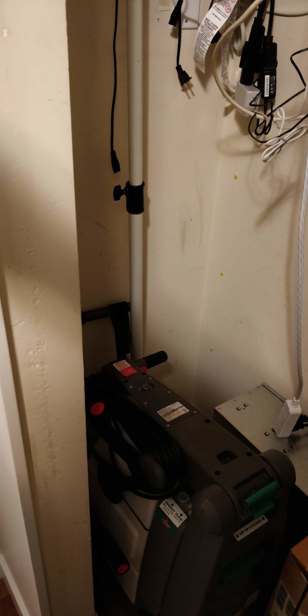

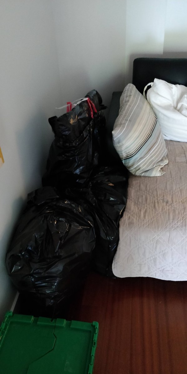

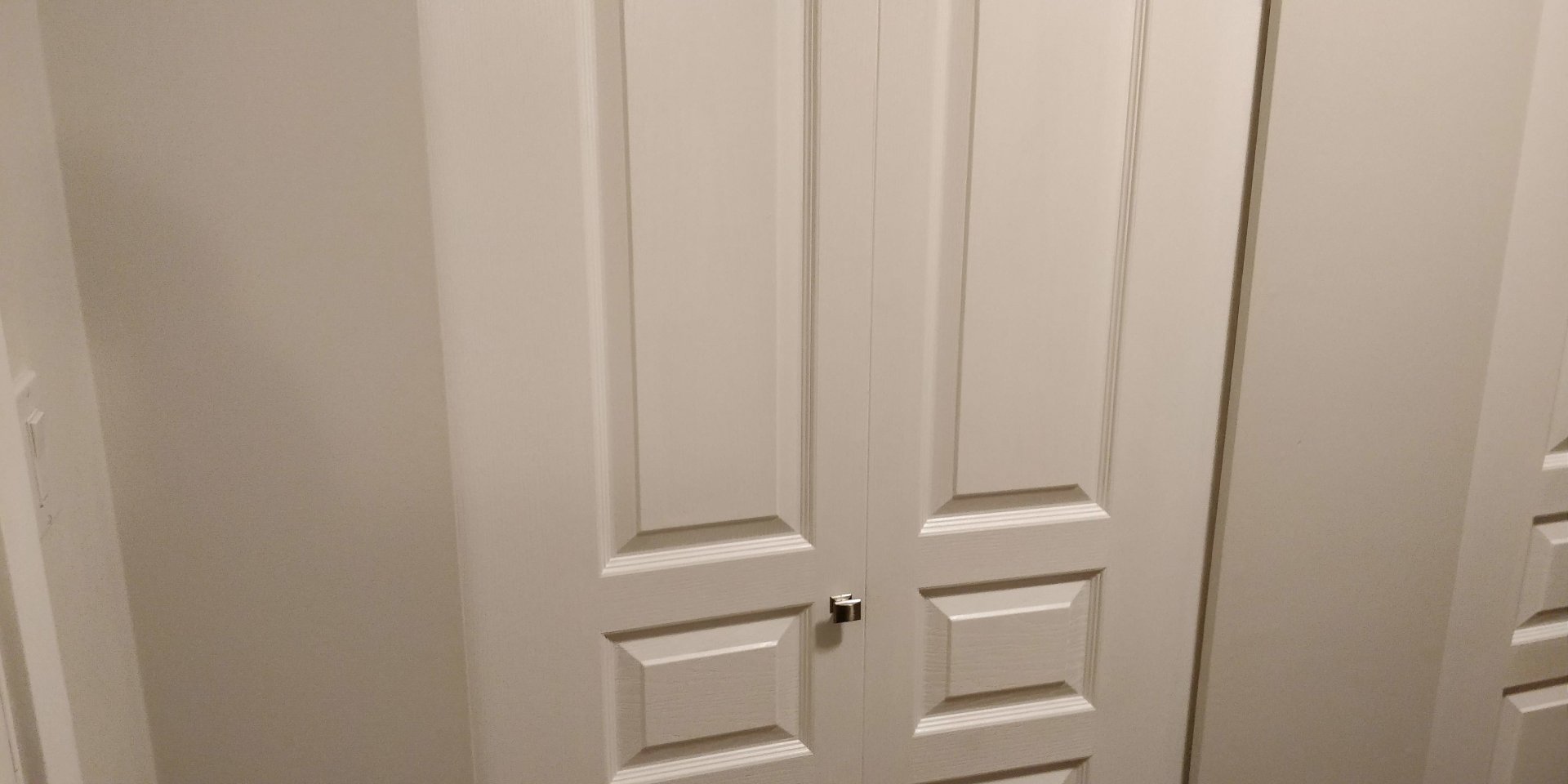

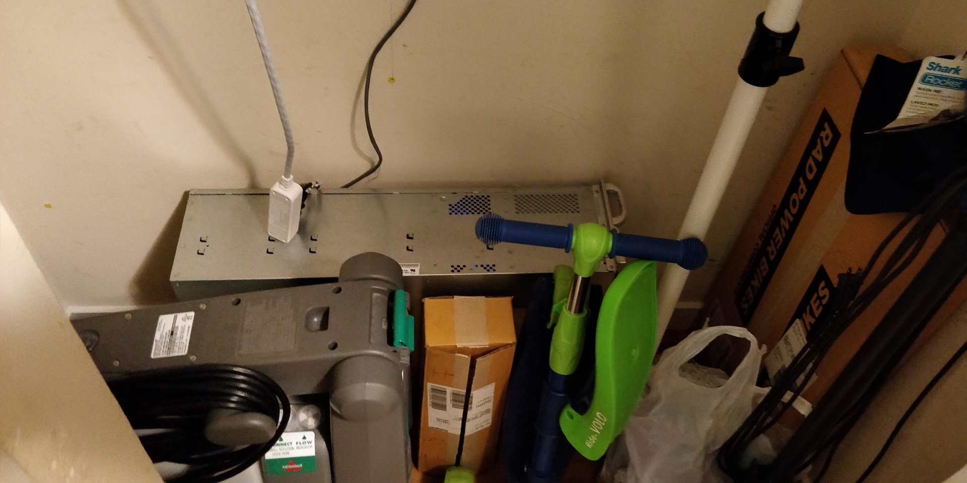

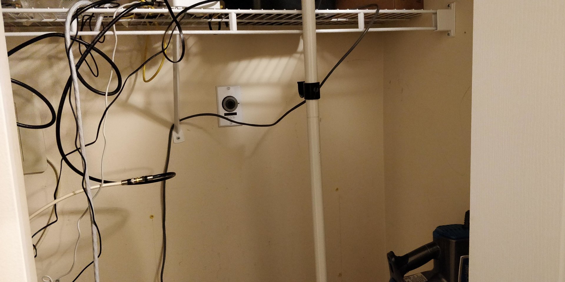

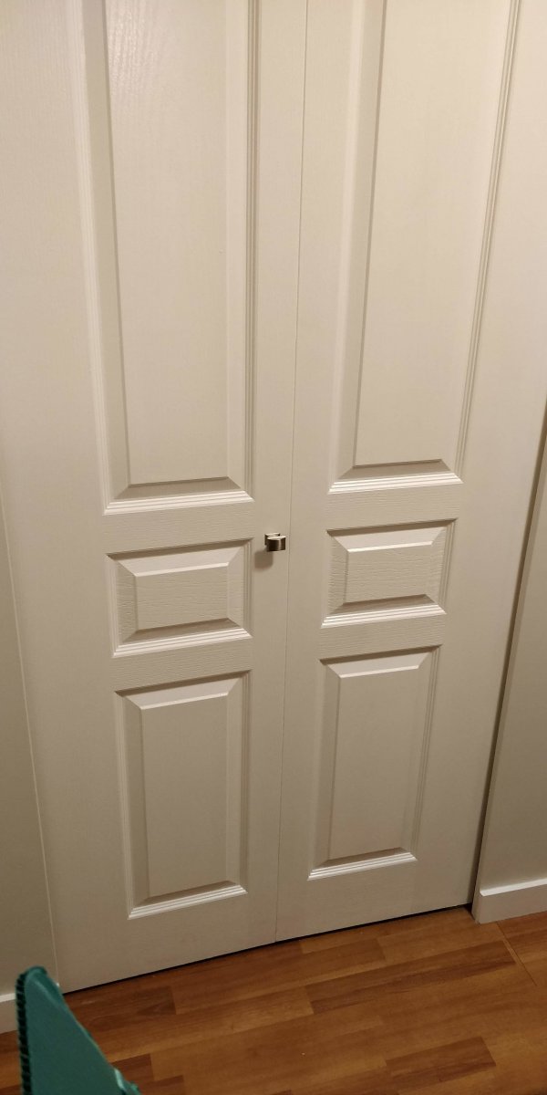

Attached the photos of:
- The side of the couch, where the server would be if I moved it into the livign room. Ignore the big black plastic bags, I just moved in, those will be gone. It's 47cm wide and length could be whatever I want it to be
- Photos of the wardrobe where it's currently located. Forgive the mess, again I just moved in, many things shouldn't be in here and cables are definitely not going to stay as is.
