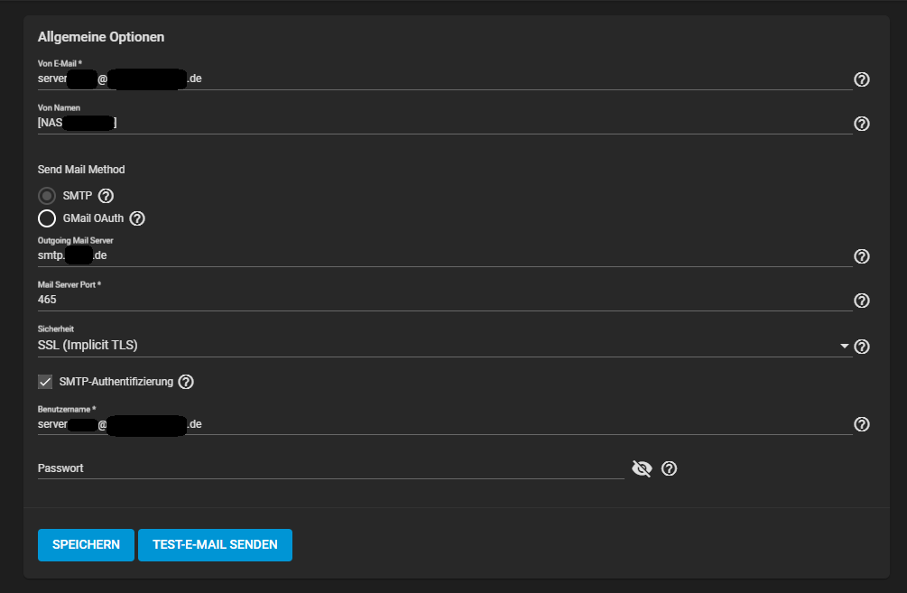

lukazy88
Jul 7, 2021
13
Setup is pretty standard and sending test mails works fine (sry for it being in german xD):
I would think the content of the log file does not correctly get put into the sendmail command (if that makes sense to you)
dak180
Nov 22, 2017
310
Try changing logfileLocation="/User-Scripts" to logfileLocation="/tmp"; as a general rule your user scripts should be in a dataset (somewhere in /mnt/{pool name}/{dataset}) not at the root level, nothing on the boot pool should be expected to survive updates.
