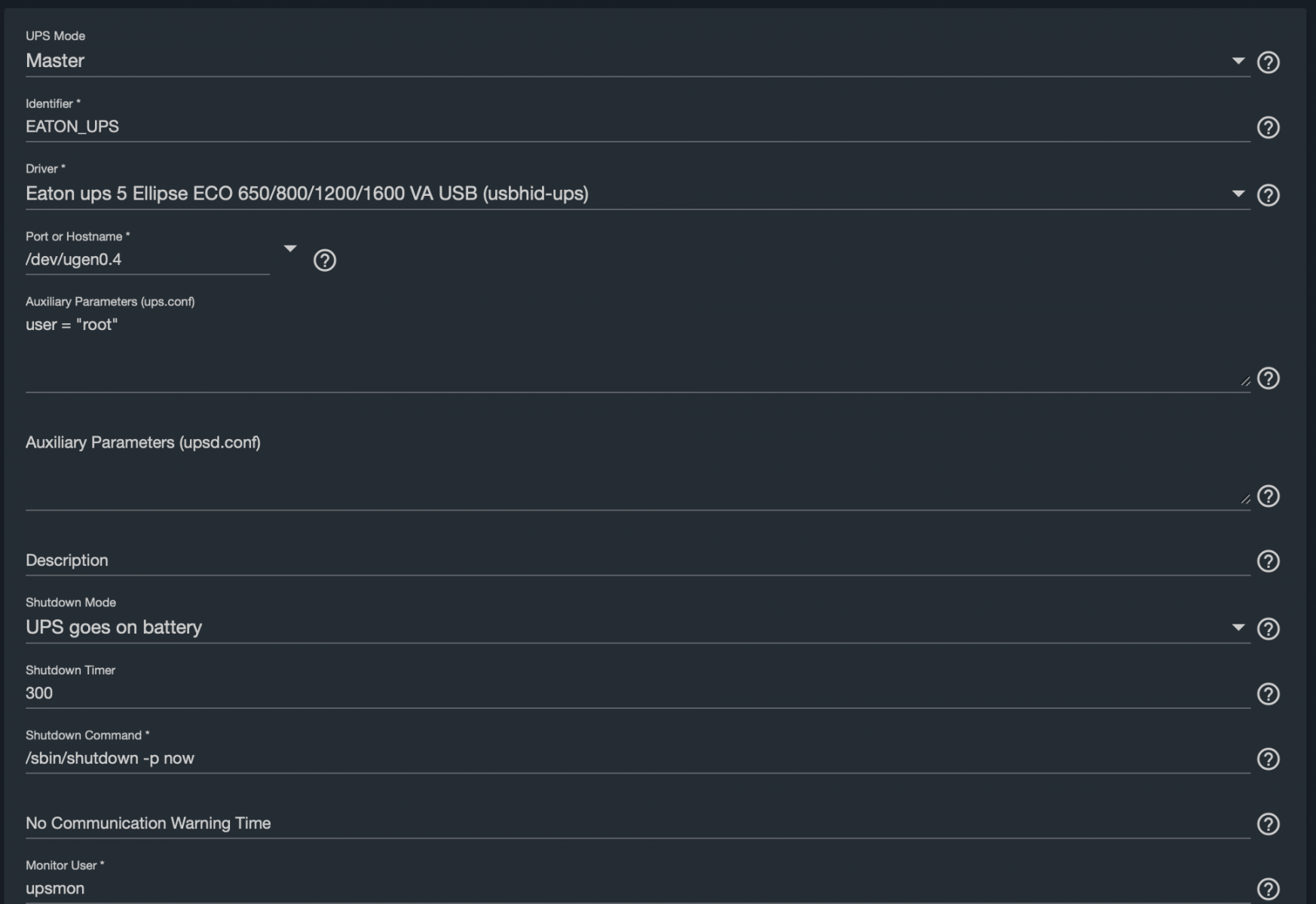

Hi guys,
I'm trying to get my Eaton UPS Ellipse ECO running. According to the NUT project, the device is supported.
You can see my system specs in my signature below, FreeNAS 11.2 running on ESXI 6.7.
  • The UPS ist connected to the USB 2.0 port of the board. Yes, I tried different ports/cables.
  • In ESXi I added the USB device to the FreeNAS VM in the VM config. I also tried to pass through the hole USB controller to the FreeNAS VM, then it works, but that is not an option, because I boot ESXi off an USB stick.
Heres the basic UPS configuration in FreeNAS, ignore the Aux Parameter user = "root" for now:
I get the following output errors:
Dec 30 12:13:58 freenas root: /usr/local/etc/rc.d/nut: WARNING: failed precmd routine for nut Dec 30 12:13:58 freenas upsmon[4895]: UPS [EATON_UPS]: connect failed: Connection failure: Connection refused Dec 30 12:13:58 freenas upsmon[4895]: Communications with UPS EATON_UPS lost Dec 30 12:14:03 freenas upsmon[4895]: UPS [EATON_UPS]: connect failed: Connection failure: Connection refused Dec 30 12:14:03 freenas upsmon[4895]: UPS EATON_UPS is unavailable Dec 30 12:14:08 freenas upsmon[4895]: UPS [EATON_UPS]: connect failed: Connection failure: Connection refused Dec 30 12:14:13 freenas upsmon[4895]: UPS [EATON_UPS]: connect failed: Connection failure: Connection refused Dec 30 12:14:18 freenas upsmon[4895]: UPS [EATON_UPS]: connect failed: Connection failure: Connection refused Dec 30 12:14:24 freenas upsmon[4894]: upsmon parent: read
Seems to me like a permission problem. When I add 'user = "root"' to the NUT config, I get the following output errors:
Dec 30 12:15:34 freenas upsd[5720]: Can't connect to UPS [EATON_UPS] (usbhid-ups-EATON_UPS): No such file or directory Dec 30 12:15:34 freenas upsmon[5738]: Poll UPS [EATON_UPS] failed - Driver not connected Dec 30 12:15:34 freenas upsmon[5738]: Communications with UPS EATON_UPS lost Dec 30 12:15:39 freenas upsmon[5738]: Poll UPS [EATON_UPS] failed - Driver not connected Dec 30 12:15:39 freenas upsmon[5738]: UPS EATON_UPS is unavailable Dec 30 12:15:44 freenas upsmon[5738]: Poll UPS [EATON_UPS] failed - Driver not connected Dec 30 12:15:49 freenas upsmon[5738]: Poll UPS [EATON_UPS] failed - Driver not connected Dec 30 12:15:52 freenas upsd[5721]: mainloop: Interrupted system call Dec 30 12:16:00 freenas upsmon[5737]: upsmon parent: read
Thanks in advance for your help!

I would have expected the port to be either just USB or /dev/TTY0 (or TTYx)
Based on the message "No such file or directory", I would play around with the port information until something works.
