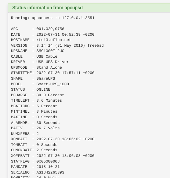

Same problem UPS Nut is not working. Neither the report page is working did new install, then recovered configuration, from backup of 12.x

What made you make that conclusion. pfsense is connected to it TrueNAS is slave configuration. I think TrueNAS is bad !

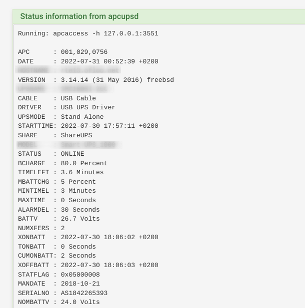

I did no such thing. Also pfsense is reporting fine ! Again TrueNAS is nut slave to pfsense so cable is bad for TrueNas while that same cable is ok for pfsense. Did you actually read my responds?
You should pay more attention to what some people say. TrueNAS 13 is just broken. Not sure why nothing on the report page is reporting anything. And i constantly get emails from nut, "statistics could not be recovered"
Again so you understand. It's an IP slave there is no cable ! It's slave to pfsense which reports fine ! So hardware is fine !!!!!!!

As for access, NUT on TrueNAS is probably trying to access the default port 3493 on the master, instead of 3551, which could be the cause of the comm issue.
