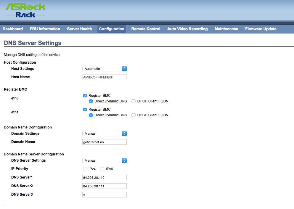

I'm appreciating this help, I am - but I'm painfully lost.
I can login to the ASRock Rack panel, no problem.
Is this where you're talking about? (image attached).
I've already declared networking is not an area I've studied much.
It looks like the networking variables shifted away from DHCP.
Should I (the self-admitted noob) try and correct what my router did in this configuration area?

depasseg
FreeNAS Replicant
Sep 16, 2014
2,874
If you've gotten to that screen I wouldn't change anything.
Go to the remote control tab to get access to the FreeNAS screen.

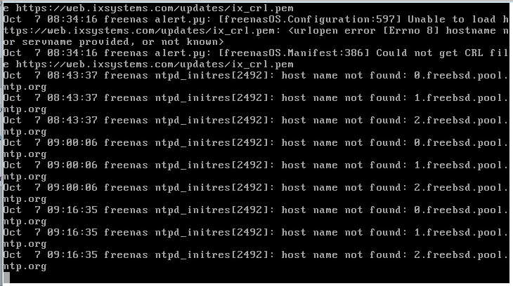

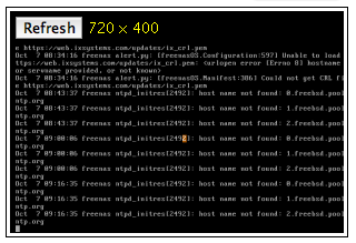

Here's what I can discern from the magical 720x400 squeezed down into my window:
2x:
https://web.ixsystems.com/updates/ix_crl.gem
freenas_alert.py: pfreenas<?>.Configuration:5971 Unable to load https://web.ixsystems.com/updates/ix_crl.pem <urlopen error |Errno 81 hostname or servname provided, or not known)
3x (these three, three times):
freenas ntpd_initrez12492I: host name not found: 0.freebsd.goo(????)ntp.org
freenas ntpd_initrez12492I: host name not found: 1.freebsd.goo(????)ntp.org
freenas ntpd_initrez12492I: host name not found: 2.freebsd.goo(????)ntp.org
I've attached a screen cap, in case you're able to draw more from it than I can.

Oct 7, 2016
12
Took a while to convince OSX to let me open viewer, here's a bigger look
Awesome! that's the console logging that you see. just hit enter to refresh the menu.

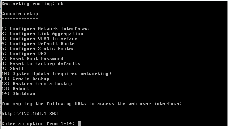

Great!
It's showing that my old route is still it's preferred location.
I've tried to reconfigure/reset a few things, but it's held on so far.
Can you advise which setting I should focus on?

depasseg
FreeNAS Replicant
Sep 16, 2014
2,874
Start with #1 - you need to get a new IP address compatible with your new router. Then fix #4,5 and 6. again be compatible with your new ISP and router.

My configurations don't seem to be taking.
I'm left with:
No configured interfaces were found. Try to do it manually.
Wondering if a factory reset makes sense?
How broad are those effects?
