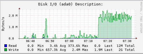

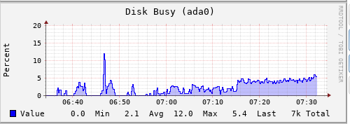

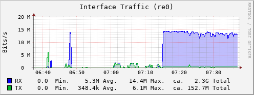

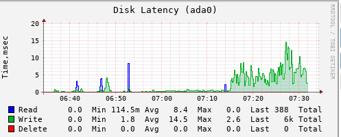

Just built my first NAS...I am curious as to whether I am experiencing typical speeds of my configuration and network. Right now, its painful, as I am in the process of transferring all my files to the NAS via wifi...
Here is my setup:
-2.4GHZ wifi
-FreeNAS box connected directly to router via Cat 6 ~25 feet from router
-Client machine unable to receive wired connected, as its 1.5 stories away from NAS and has no feasible opportunities for wired connection.
-Client machine reports wifi speeds using online Xfinity test of ~22mbps/upload , 6mpbs download
Attempting to transfer 40GB of data to NAS box. Box reports the attached speeds/reports - I'm the only client on the network right now.
Im just curious if anyone can tell me if my speeds are normal, whether they suck or not, and any other tips that are applicable to improving my network.
Thank you

Based on the data in your posting your FreeNAS machine is doing fine. As you noted, WiFi is not a great way to conduict fast transfers. You could make these faster if you had 5 GHz WiFi and enabled 80 MHz bandwidth, and had a radio on both ends capable of 800 Mbps or better. My system can go up to 1.3 Gbps via WiFi but it rarely will go much beyond 900 Mbps.

As you have discovered this is going to be a lesson in futility. Find a way, any way, to get that client on a wired connection at least until the data transfer is complete.

Realtek nic and WiFi.... You should be happy it even works. Anything more than that is just a bonus.
