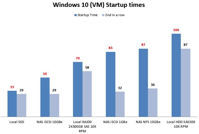

I just finished setting up my ESXi server to use my FreeNAS for storage.
I can’t really justify a 10GBe switch, so I just installed a couple of second hand SFP+ NICs and am running peer to peer on a unique subnet.
Below is the results of my speed tests booting up a Windows10 VM including the auto login.
You can see the caching of the NAS really making a difference on the second startup.
So with these results id go for iSCSI via 10GBe.
