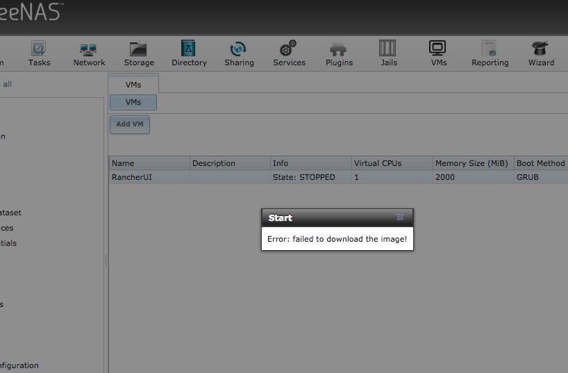

KrisBee
Mar 20, 2017
1,288
codybarr
Apr 6, 2018
Yes you would, but the OP included an img file as his screen pic shows. The other thing the OP should check is that the rancheros img has downloaded correctly. It should reside in a hidden folder, e.g. :
root@freenas:/ # ll  /mnt/NasPool/.bhyve_containers/iso_files
total 45861
-rw-r--r--  1 root  wheel  49363679 Dec 14 11:51 rancheros-bhyve-v1.1.0.img.gz
I was also getting hung at the 'Connected' prompt. And this turned out to be my issue as well. I ended up having to wget the rancheros-bhyve img manually since I kept getting an error when trying to download through the GUI.
Was able to start the VM after and connect successfully to finish the rest of the guide. TYVM!
