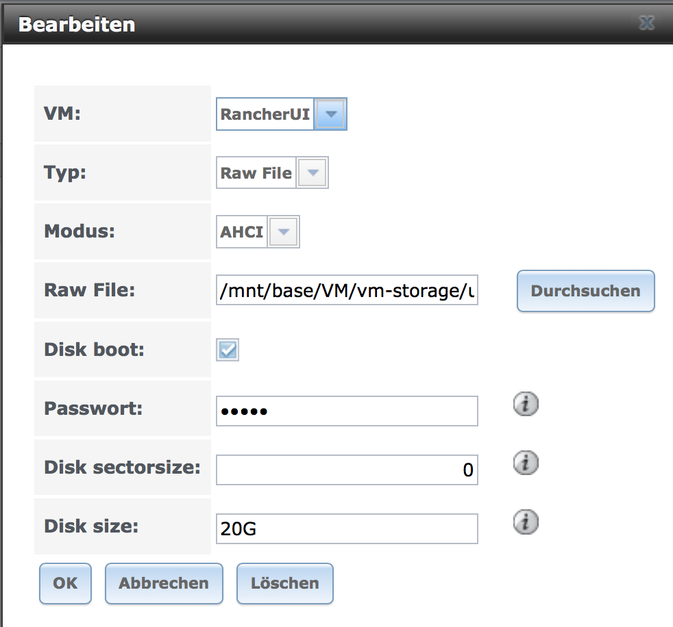

OliverF
Dec 16, 2017
7
Here is a picture from the Dataset
Dataset is empty :
root@freenas:/mnt # cd base/VM/vm-storage/
root@freenas:/mnt/base/VM/vm-storage # ls -al
total 1
drwxrwxr-x 2 root wheel 2 Dec 18 13:44 .
drwxrwxrwx 4 root wheel 4 Dec 18 13:44 ..
Image name was given (ui.img) but after starting the VM no image is created.
A window opens with let the magic begin ... Then after pressing yes a window flashes up, but to fast to have a chance zu read or react (2 Buttons on the bottom) and than it hangs.
Stopping the VM with the GUI is impossible. I kill the process in a terminal.
Cut and Paste of pictures is not possible ...
KrisBee
Mar 20, 2017
1,288
I cannot reproduce this error. Would suggest just deleting the docker VM and starting again.

I got this symptom when I failed to include /rancherui.img at the end of the chosen RAW FILE path.
KrisBee
Mar 20, 2017
1,288
Yes you would, but the OP included an img file as his screen pic shows. The other thing the OP should check is that the rancheros img has downloaded correctly. It should reside in a hidden folder, e.g. :
