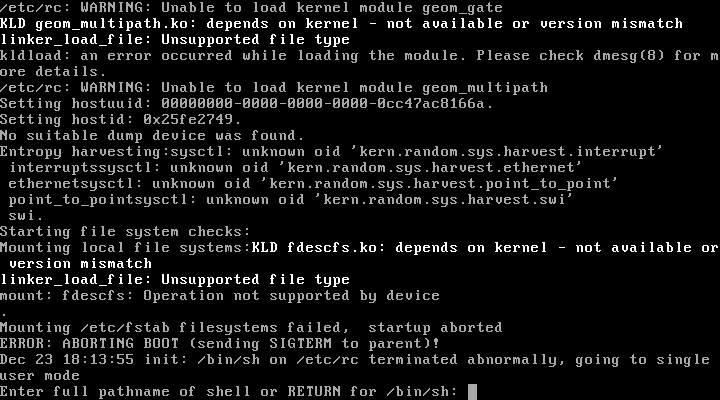

FreeNAS 11.1 missing kernel modules
tigloo
Aug 23, 2016
53
I tried upgrading FreeNAS 11.0-U4 to FreeNAS 11.1. The upgraded boot environment refused to boot, so I tried with a fresh installation, which also refused to boot. I finally replaced my boot USB stick and did another fresh installation - also refuses to boot.
It complains about missing kernel modules and then stops asking for the shell.
What can I do?

Verified the checksum, the file has been downloaded correctly. I assume that many others have downloaded the same file - most likely there would already be more reports by now?

As mentioned, did clean install on new USB boot stick to rule out any upgrade or USB stick issues.
Still fails with the same message, cannot load the kernel modules during boot and gets stuck.

Yes, I re-installed 3 times following the documentation to ensure that everything should be setup correctly.
My hardware is as following:
Case U-NAS NSC 800
SuperMicro X10SDV-4C-TLN2F (Xeon-D)
8x WD Red 3TB
32GB DDR4 RAM
tigloo
Aug 23, 2016
53
Well, I figured it out myself.
The system had an unused SSD installed which I eventually wanted to use as ZIL but never activated.
FreeNAS choked on the SSD being there. Removing it from the system allowed FreeNAS to boot. Seems to be a bug though.

The SSD was not part of the boot sequence. Also, FreeNAS was already booting from the system drive. How is this related to the BIOS boot order?
I had a similar problem that I solved by removing my unused SSD, see this thread.

Thanks for the confirmation!
The system is running stable now for a couple of days, so I can confirm that this really was the issue.
