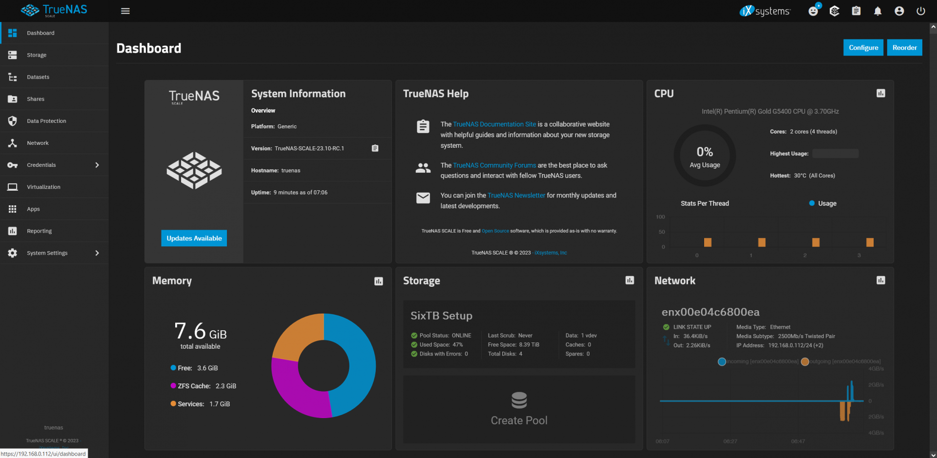

Sorry for reviving an old thread but I hit this roadblock after building a truenas system this week and hit this roadblock. The instructions posted here already are usable for someone but not me without spending weeks learning things I dont need to know.
Instead I just installed truenas scale 23.10-RC.1 it recognised my USB 3.0 ports I saw my windows transfer speed hit 266MBps and mostly stayed at 255MBps which was a massive stepup from 1Gb.
