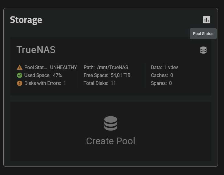

So, two days ago I received the following email:
New alerts:
Pool TrueNAS state is ONLINE: One or more devices has experienced an unrecoverable error. An attempt was made to correct the error. Applications are unaffected.
Current alerts:
Dashboard shows 'Pool: UNHEALTHY' and 'Disks with Errors: 1'
The disks looking icon (pool status) in the top right does nothing for me.

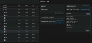

'Storage > Topology -> Manage disks' shows 1 disk with 1 read error:

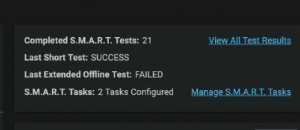

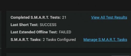

Note that it did fail its last long test:
joeschmuck
Old Man
May 28, 2011
10,996
Then it should be listed in the drive test log and saying it failed. Maybe it was test #2 that is missing for some odd reason?
Test was 'interrupted (host reset)'. 2 long test before that ran without issue.
SMART Self-test log structure revision number 1 Num Test_Description Status Remaining LifeTime(hours) LBA_of_first_error # 1 Short offline Completed without error 00% 8038 - # 2 Short offline Completed without error 00% 8032 - # 3 Extended offline Aborted by host 90% 8032 - # 4 Short offline Completed without error 00% 8010 - # 5 Short offline Completed without error 00% 7991 - # 6 Extended offline Completed without error 00% 7976 - # 7 Short offline Completed without error 00% 7919 - # 8 Short offline Completed without error 00% 7895 - # 9 Short offline Completed without error 00% 7871 - #10 Short offline Completed without error 00% 7847 - #11 Short offline Completed without error 00% 7823 - #12 Extended offline Completed without error 00% 7807 - #13 Short offline Completed without error 00% 7748 - #14 Short offline Completed without error 00% 7724 - #15 Short offline Completed without error 00% 7700 - #16 Extended offline Interrupted (host reset) 30% 7698 - #17 Short offline Completed without error 00% 7652 - #18 Short offline Completed without error 00% 7628 - #19 Short offline Completed without error 00% 7619 - #20 Short offline Completed without error 00% 7604 - #21 Short offline Completed without error 00% 7580 -
