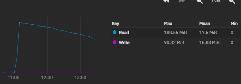

This is the disk I/O for the data pool:
As you can see it was at < 10 mb/s for a long time, then it got to speed and dropped again.

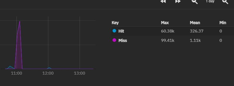

I did some investigation and saw the following correlation between the disk I/O and ARC Requests demand_metadata:
If it's not clear from the color scheme: violett is miss, blue is hit. So apparantly there are missed ARC Requests demand_metadata and when they drop / reduce the I/O increases.

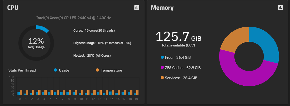

TrueNAS-SCALE-22.12.4.2 Supermicro X10SRi-F Xeon 2640v4 4x Samsung 32GB 2Rx4 PC4-2400T RA1-11-DC0 Server RAM ECC HP M393A4K40CB1-CRC0Q running at 2133 MHz, tested with memtest for 48 hours prior to installation Seasonic PX-750 Data pool: 4*4TB WD RED PLUS (CMR) raidz2 VM pool: 2*500GB SSD (Samsung Evo 850 / Crucial mx500) mirror Pool is 50 % full
