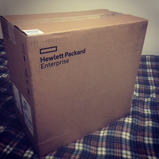

Update: the HPE ProLiant ML10 Gen9 is scheduled for delivery on Friday. Everything else is scheduled for delivery on....Friday. Looks like I'll start putting this server together over the weekend.

Well, the deliveries have begun:
