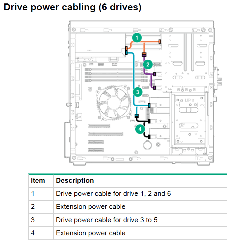

You'll probably need 2 SATA power splitters.

120GB SSD option, if you go for it, is way too big. Buy a 32/64GB SSD instead. Although I use a USB drive for my boot, because my board doesn't have anymore SATA ports and buying a PCIE card just for the boot drives seems like a waste to me. When providing power to the drives, try to use a molex cable and molex to SATA adapters instead of using any splitters, if possible. I don't know how many cable runs your power supply has. Is it modular/semi-modular or non-modular?

The power supply is not modular/semi-modular, and has no Molex connectors, only SATA (and perhaps a fan? can't recall). It's designed for that specific case/board/drive configuration.
Try to find crimped, not molded, adapters/splitters for safety.
