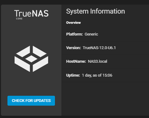

1. What time does TrueNAS say it is on a freshly refreshed dashboard?
Mine gives me the correct local time (as above).

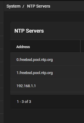

2. What do you have specified for servers at System>NTP Servers?

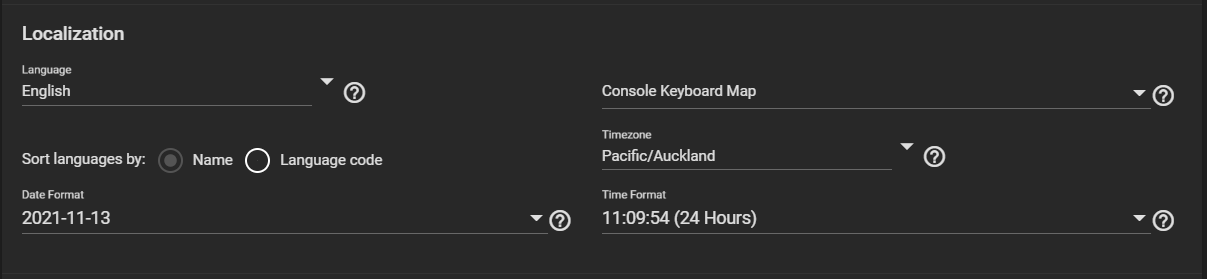

So I never noticed the time on the dashboard, and that is actually giving me the incorrect time. But in the system/general settings it's set correctly. See below.
So I guess the question here is, if the dashboard doesn't get it's time from what's set in the general settings, Where does it get it's time from?
