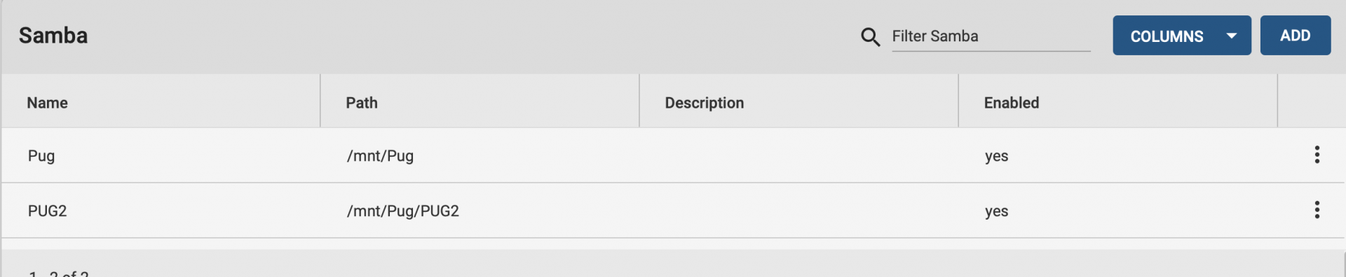

I apologize for not previously stating clearly what I am trying to do (which I should have in the first post - but it was late and I was super tired).
Yes, the pool is named Pug (I have a share called Pug, with path /mnt/Pug - which is what I want to change as I do not like having a share that points directly to the pool and not a dataset). The new dataset is inside Pug, named PUG2. The share PUG2 has the path of /mnt/Pug/PUG2. I am trying to move all the files and directories (and sub-directories) in the Software folder located in the Pug share to the Software folder in the PUG2 share. I have already created the Software folder on the PUG2 share.
With this in mind, will the suggestion to use
mv /mnt/Pug/Software /mnt/Pug/PUG2/
create a new Software directory in the PUG2 share (meaning I would need to delete the Software directory I have already created on that share)?
Also, with my shares and datasets being named the same (I thought might be less confusing), does the mv command refer to the share path or the dataset path (in case in the future I have a dataset named differently from the share)?
Jan 7, 2015
1,153
The above commands are perfect. Do it for each folder you want inside of PUG2. (Notice the trailing slash on the destination directory, its important.)
mv command refers to the absolute path, you can name the share whatever you want.
Also yes will "create" software inside of the PUG2 directory.
This process should be almost instant.
