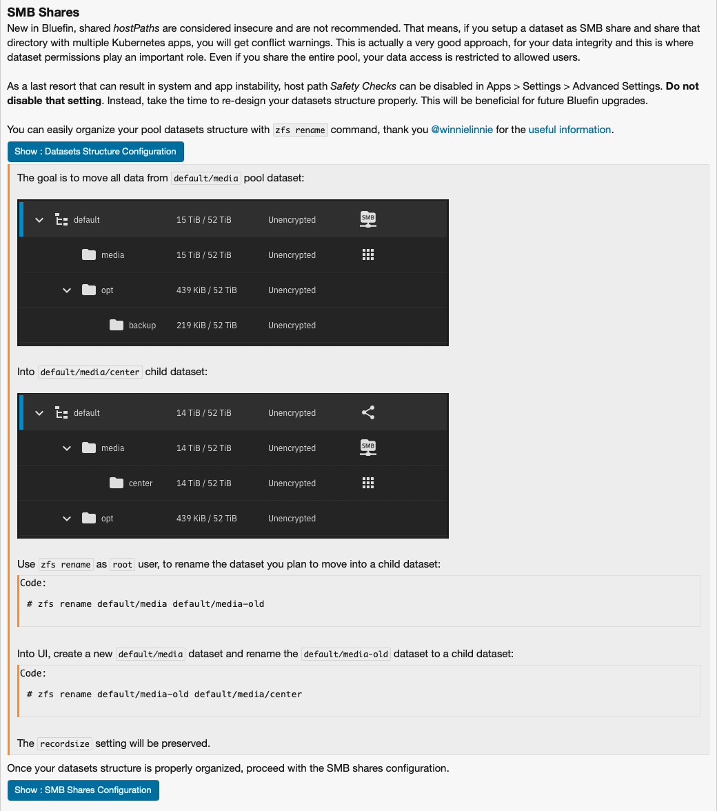

Amazing info, 30 seconds later:
I'm going to add this into Bluefin Recommended Settings and Optimizations thread. I also opened NAS-119755, to have gcp added into Scale.
Edit: Guide updated, as usual, credit and link provided. :smile:

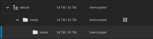

When I renamed the media to media-old dataset, it was reflected immediately into UI. Related to dataset options, they are all preserved. In my case, they all showed as inherited, except the recordsize, which kept the previous 1M custom value I've set (new media dataset was created with 128k recordsize). This reassured me the dataset rename did not affected in any way how data is stored inside the dataset. It was a pain when I moved all files from a 128k recordsize dataset to another 1M recordsize dataset. All this is explained into guide.
