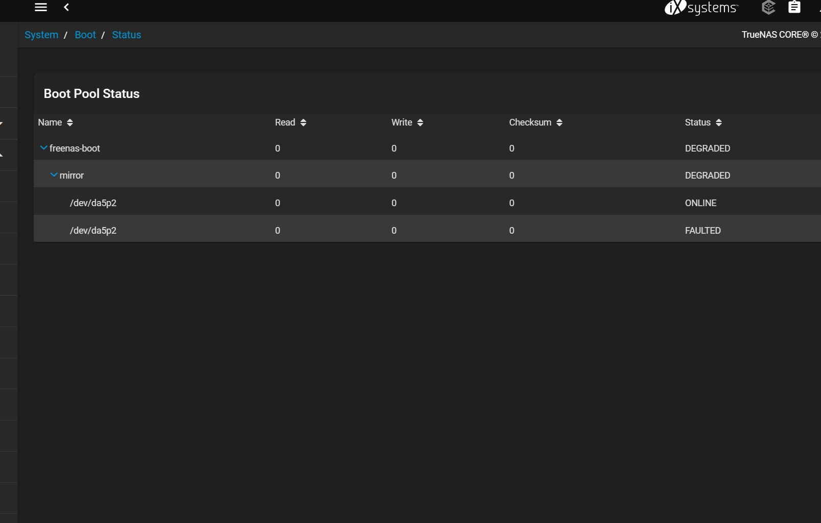

Been burning through flash drives this last year and went to replace the failed one again. However, this time after i unplugged the bad one and rebooted. The remaining good drive shows up like this, as both ONLINE and FAULTED. It won't give the option to mirror. I can detach or replace but it won't let that happen since this is the only replica. How do I get out of this situation. I've tried a reboot. anything else?

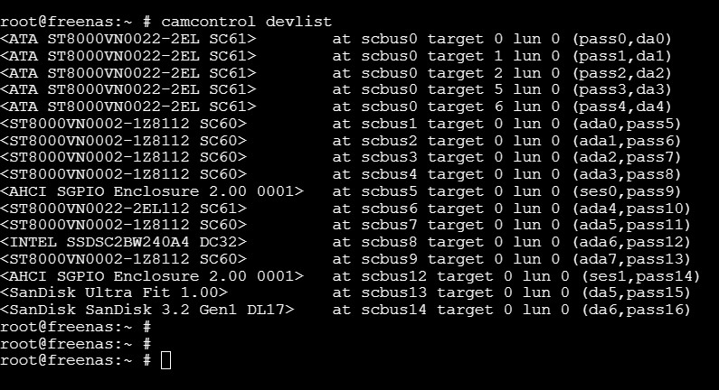

eddie200112
Mar 17, 2015
190
NugentS
Apr 16, 2020
2,947
Davvo
Jul 12, 2022
3,222
Try saving your config, re-installing TN on the correct drives (BOTH), then importing back your config.

if i try to detach the second drive in the list i get this message.
