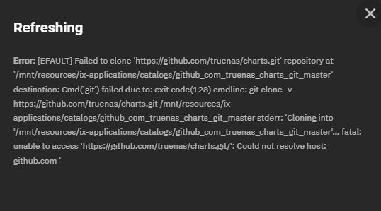

Here is the error message that comes up in notifications:
Failed to sync OFFICIAL catalog: [EFAULT] Failed to clone 'https://github.com/truenas/charts.git' repository at '/mnt/Main/ix-applications/catalogs/github_com_truenas_charts_git_master' destination: Cmd('git') failed due to: exit code(128) cmdline: git clone -v https://github.com/truenas/charts.git /mnt/Main/ix-applications/catalogs/github_com_truenas_charts_git_master stderr: 'Cloning into '/mnt/Main/ix-applications/catalogs/github_com_truenas_charts_git_master'... fatal: unable to access 'https://github.com/truenas/charts.git/': Could not resolve host: github.com '

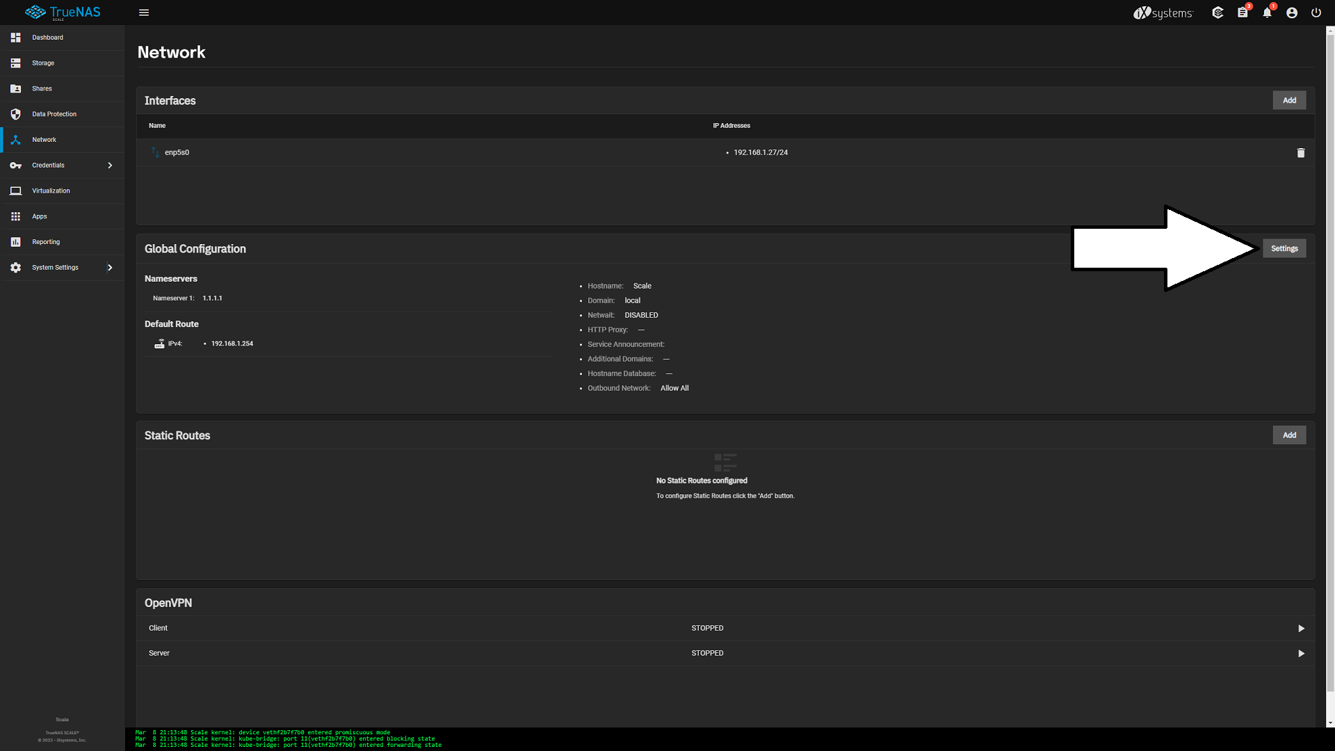

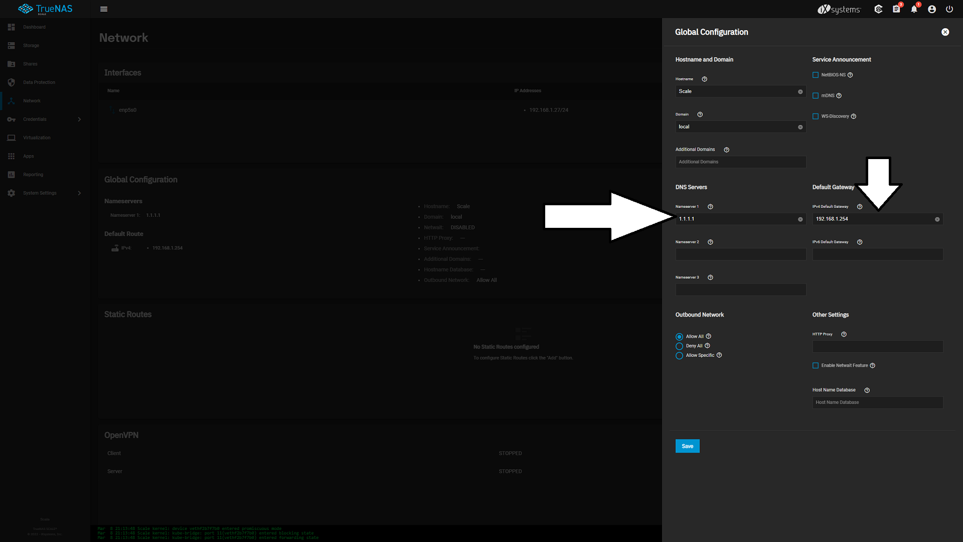

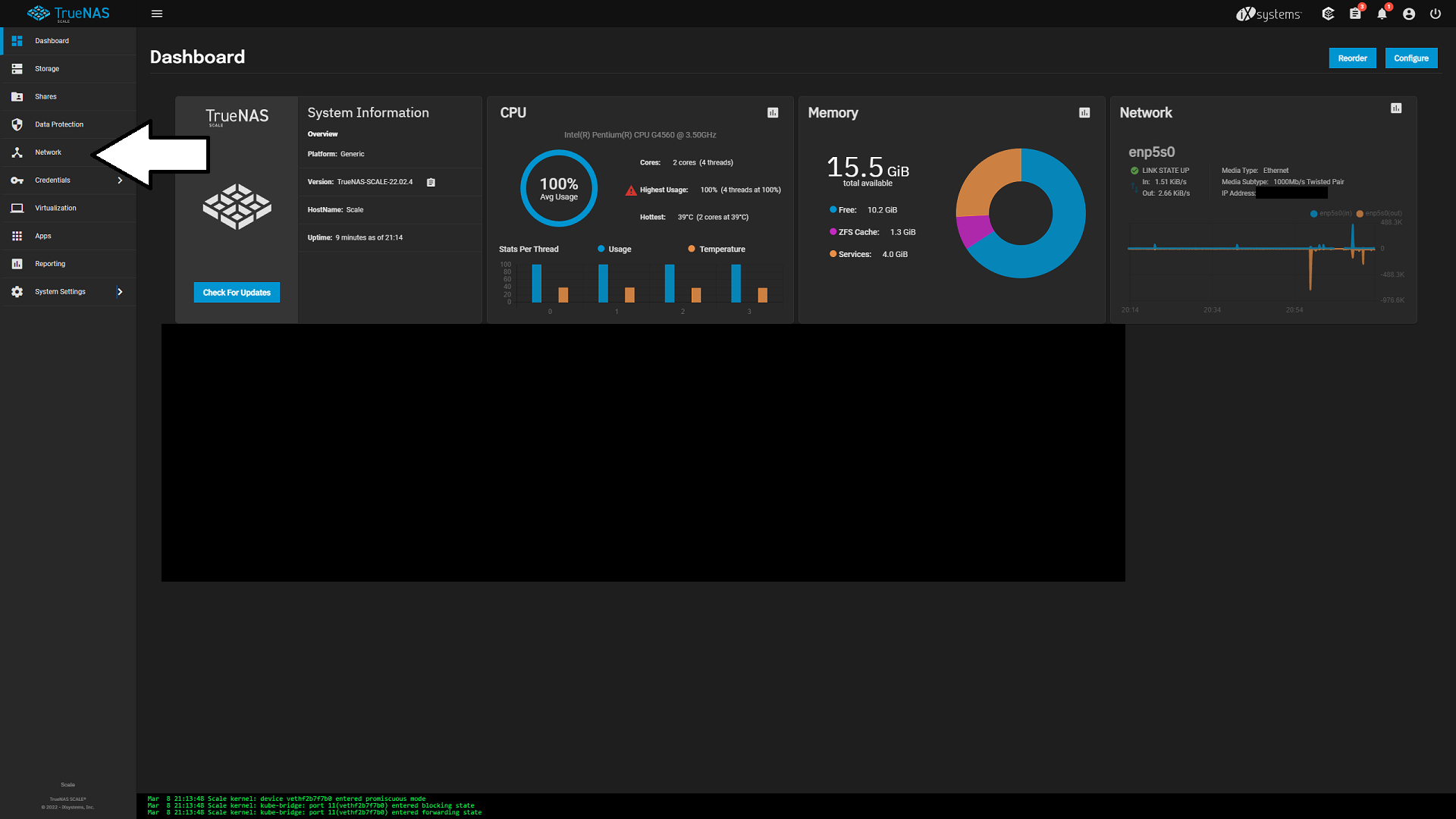

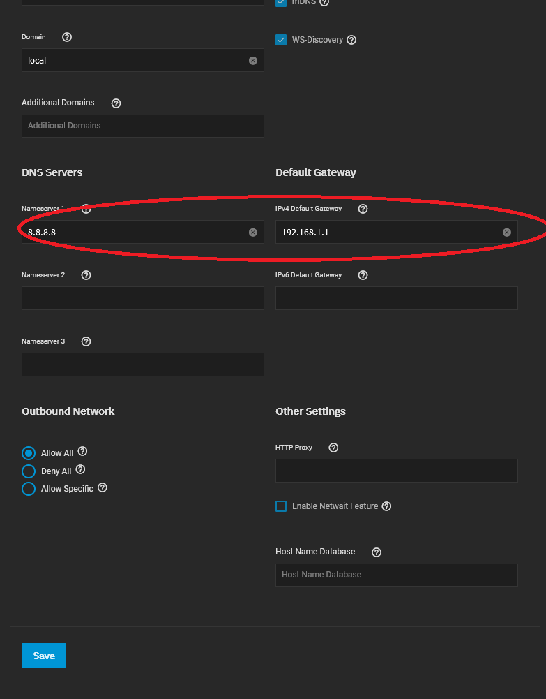

tarheelbandb
Feb 10, 2022
For the visual learners.

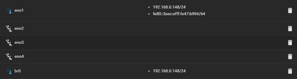

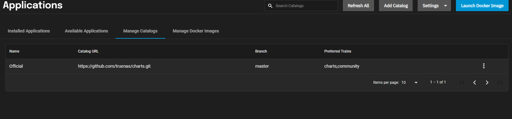

I am having this issue on an otherwise working install of TrueNAS-SCALE-22.02.1. I have tried the advice in this thread, but I can't seem to resolve it with any of the advice. I set my nameservers to 8.8.8.8 and 8.8.4.4. My default gateway is correctly set to my router IP. I have VMs running which can access the internet, so I do not think its a larger networking problem. Does anyone have any other ideas for setting up a connection for my applications? If it helps, I have additional onboard NICs on my system I could use. The error I am getting, as well as my networking interface is attached as screenshots. Thanks for any help you can provide.
