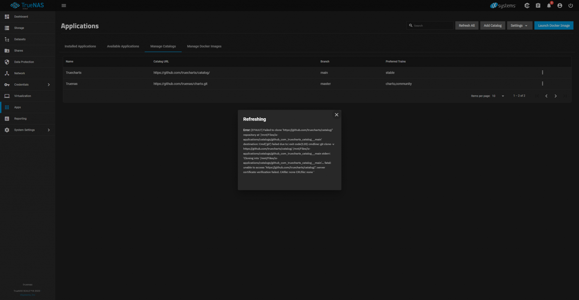

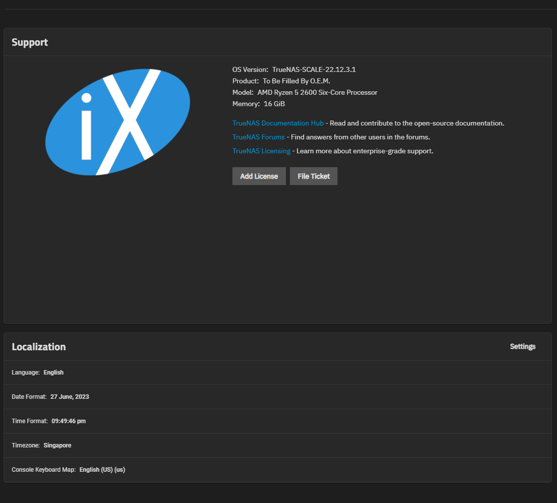

I have an issue with connecting to the official catalog, every time i attempt to connect to the catalog it shows this error
Failed to sync TRUECHARTS catalog: [EFAULT] Failed to clone 'https://github.com/truecharts/catalog/' repository at '/mnt/Files/ix-applications/catalogs/github_com_truecharts_catalog__main' destination: Cmd('git') failed due to: exit code(128) cmdline: git clone -v https://github.com/truecharts/catalog/ /mnt/Files/ix-applications/catalogs/github_com_truecharts_catalog__main stderr: 'Cloning into '/mnt/Files/ix-applications/catalogs/github_com_truecharts_catalog__main'... fatal: unable to access 'https://github.com/truecharts/catalog/': server certificate verification failed. CAfile: none CRLfile: none '​
Even after choosing all the recommended DNS servers like 8.8.8.8 8.8.4.4 1.1.1.1. I've also checked if my ethernet was the issue and changed my ethernet cable many time and testing it with devices to check if the cables were working.
Also made sure that the date and region of the system is correct.

VenomX
Jul 19, 2023
Worked, added Secondary and Tertiary DNS on top of my Primary PiHole DNS
Thanks

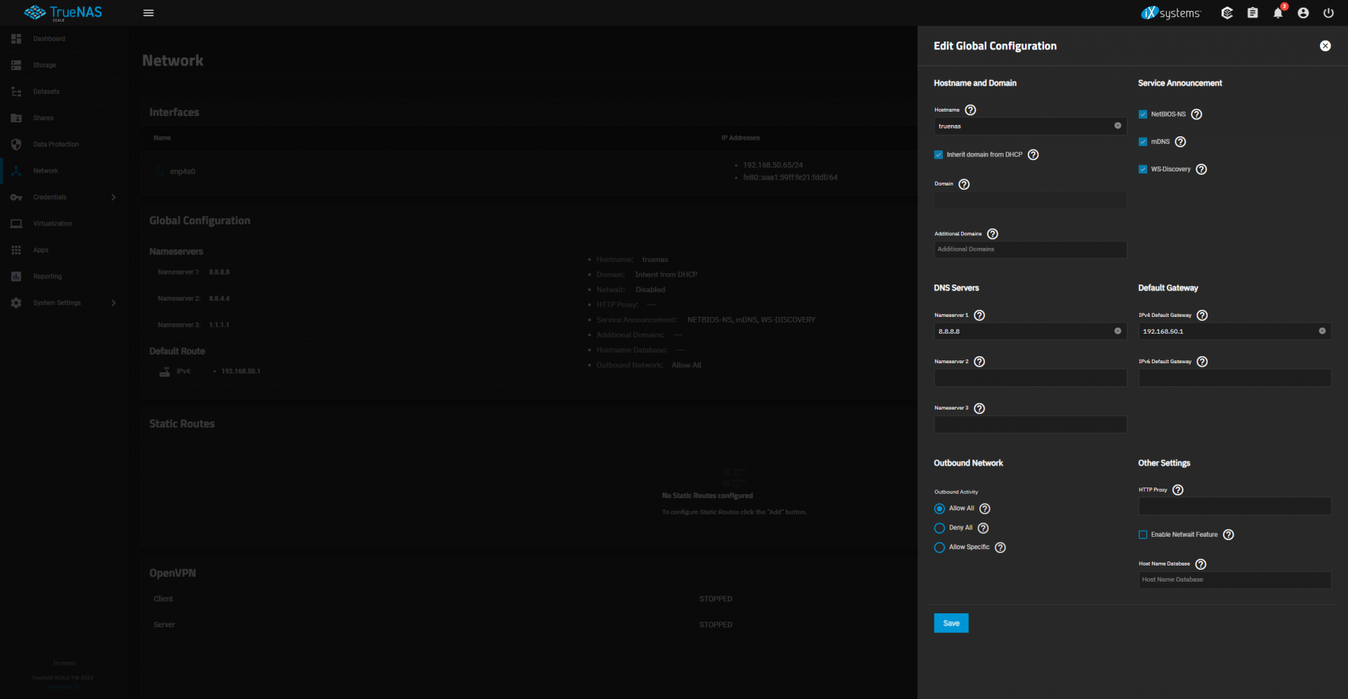

embain14
Dec 16, 2023
I know this thread is a little older but I figured I should just share what I learned. I was running into the same error message and once I removed the IPv6 gateway (mine had a mac address in there for some reason) from the global configuration everything started working great
