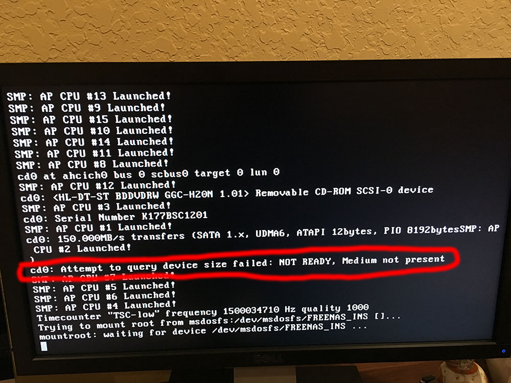

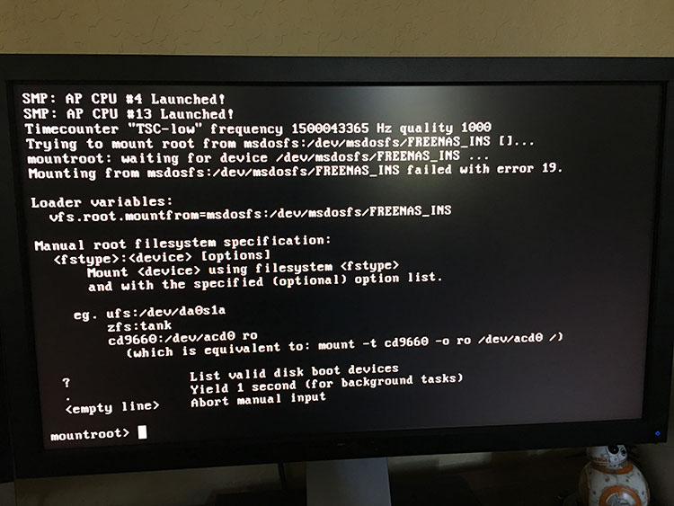

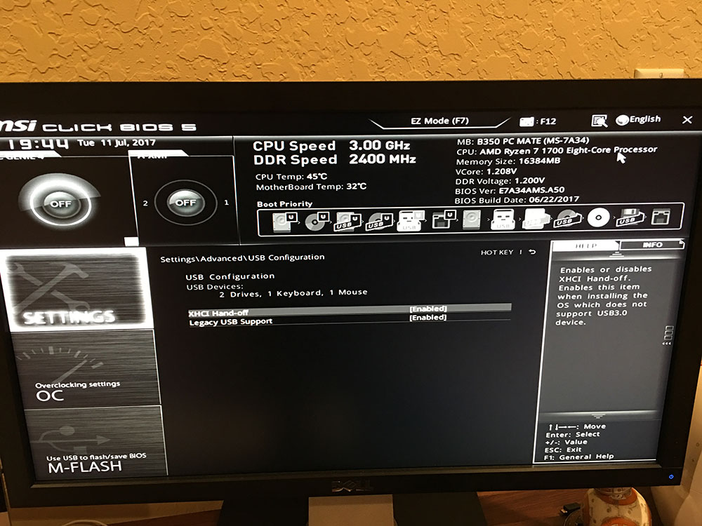

Hi, so I have a Ryzen 7 1700 cpu, MSI - B350 PC MATE ATX AM4 Motherboard and simply can not get FreeNAS 9.3 to mount to my other usb thumb drive. I keep getting an error 19, mounting failed error. I can see the 2 usb thumb drives when I go into the bios, but no matter what I do nothing seems to solve my problem. Does the line that I highlighted in the 2nd pic mean it's not finding a usb drive to mount to? Do you guys have any suggestions? I've attached some pics for you to see my bios and what happens when FreeNAS tries to install.

The second screen just shows there is no CD in the CD drive.

I did try v11 first but had problems mounting in Plex my folders which I read has an issue with v11. Then tried reinstalling it again, but didn't finish the install process. After that, I tried v9.3 thinking that might give me better results in Plex and mounting my folders. After that, couldn't mount on install and error 19. So I'm wondering if I should try v9.10 next to see if I have better results with that.
9.3 has an approximately zero percent chance of even booting on Ryzen, and 9.10 is not much better (maybe if it gets an update to FreeBSD 10.4 when that is out).
