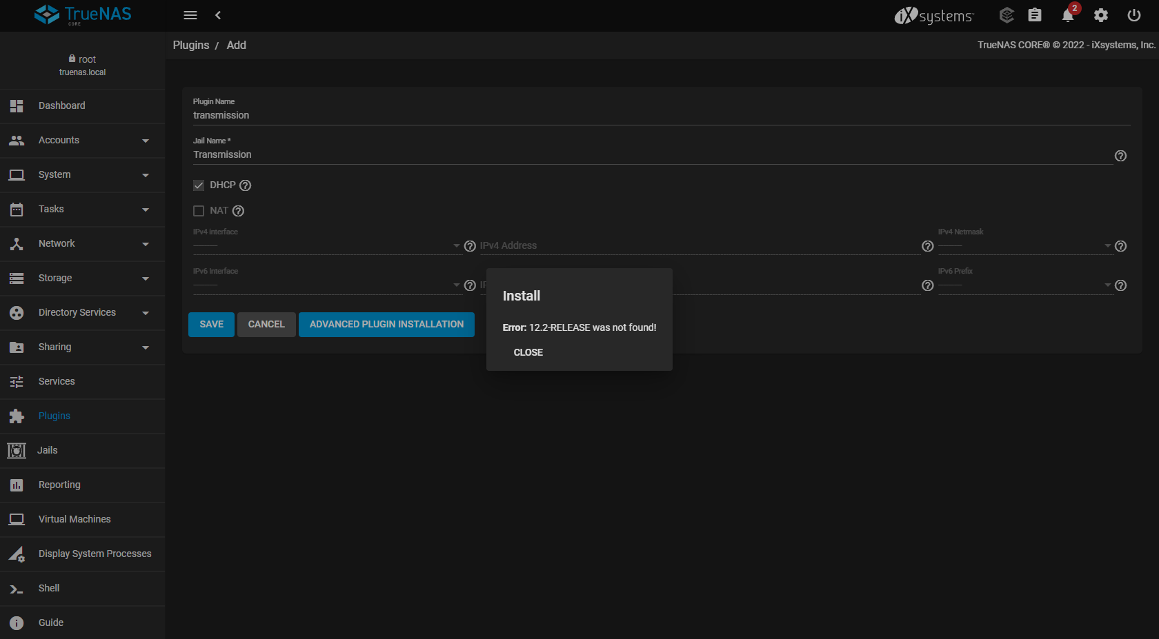

Hello! When installing any plugin from the Community collection, an error occurs: "Error: 12.2-RELEASE was not found!"
Installing from the iXsystems collection is ok.
What could be the problem?

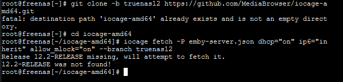

Same here. I just updated from FreeNas 11.3 to TrueNAS CORE 12.0-U8.1 today. I was able to move everything over including my plugins like Emby. I figured I would go ahead and uninstall Emby and reinstall the newer version available. But I am getting "Error: 12.2-RELEASE was not found!," whether I install it from the Plugins menu or the Shell.
It seems that iXsystems Collection works with no issues, I was able to install Plex successfully with no issues.
