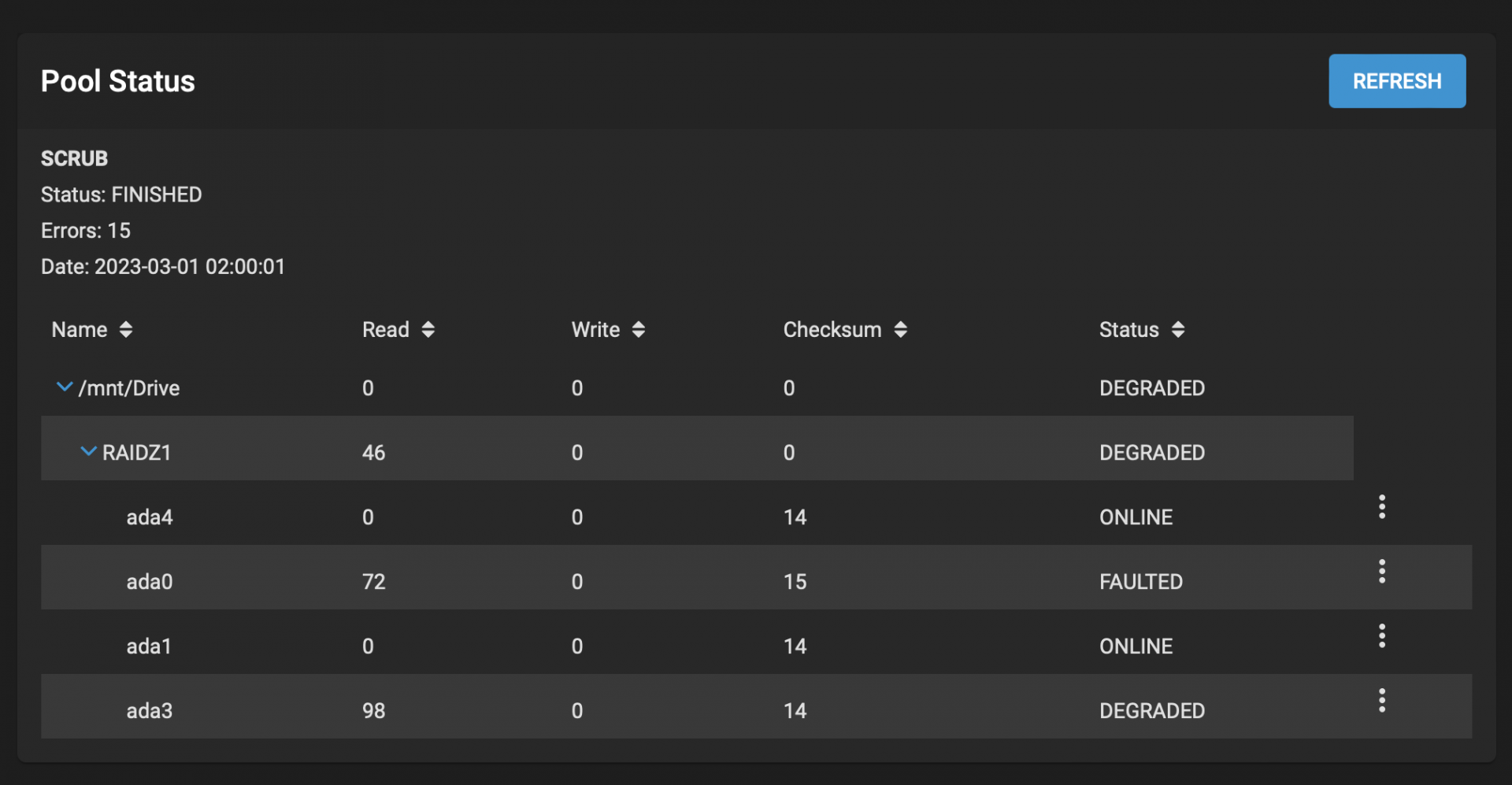

I recently purchased two new drives for my aging Freenas Mini (it is such a champ!). In the attached screenshot you will see 2 of the 4 drives are troubled (fault and degraded). I just got two new WD Reds, but I'm curious if the order matters in how I replace them. When I click replace, it is looking for a new drive but I don't have a spare slot so the dropdown is blank. Any recommendations?

What is your pool layout? Any smart errors? What does zpool status show?

With a RaidZ1 and 2 drives down I think you should restore from your backup after recreating your pool with the the replacement drives.

@awasb this doesn't show a faulted drive now, but I'm guessing that drive is on the fritz because it pops up occasionally. This Freenas mini has been running since Dec 2015 and this is the first issues I've ever had, these drives are getting tired after 8 years
