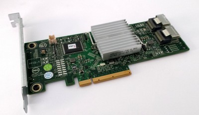

something like this seems feasible...
or this:
prices seem ok
Someone please verify these choices, or link to what is right.
Yes, this is an HBA. Buy it, reflash (or "crossflash") with the official LSI firmware, install, be happy. Note that you'll have to recreate your pool if you created it on the P410i already.
RAID controller, nope. Anything that says "BBU" or "cache" on it is typically no good, and even if it works is usually more expensive than a regular HBA.

Yes, this is an HBA. / snip /. Anything that says "BBU" or "cache" on it is typically no good, and even if it works is usually more expensive than a regular HBA.
Ok, thanks. Considering I got those servers for next to nothing I guess I can spend a bit to get them "right".

Only thing to do is to check physical cables and slots and stuff just in case...
Measure the internal cable length and ensure that it will reach to the PCIe slots, with the understanding that the ports are on the "back" of the H310. The ones included with your DL380 G7 may have only been long enough to reach the onboard SFF ports rather than an add-on card.
