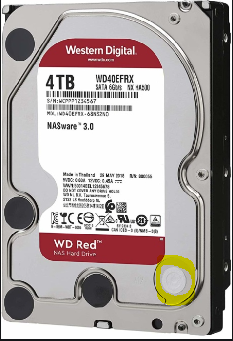

I mentioned for you to post the complete model, the difference is the rest of the model after this, e.g. for the Blues, which also are available in the same different models:
WD40EZRZ-00WN9B0 - 4 platter model
WD40EZRZ-00GXCB0 - 3 platter model
You can also tell by looking at them, old one is missing the highlighted part:

ok ... I will pull the drives and have a look at them.
Or just run a smartctl -i against them ...
First 3 are the new ones from Best Buy
ada2 ... Device Model: WDC WD40EFRX-68N32N0 <-- this is the one that 'looks' slow
ada3 ... Device Model: WDC WD40EFRX-68N32N0
ada4 ... Device Model: WDC WD40EFRX-68N32N0
ada5 ... Device Model: WDC WD40EFRX-68WT0N0 <-- this is a much older drive
May 10, 2017
838
This one is 4 platters and slower, all the other ones are the newer model, so that's not what's causing the difference, it might be a disk with one or more slow sector zones, is the SMART attribute #1 Raw_Read_Error_Rate still 0? That can be a clue for the existence of slow zones.
