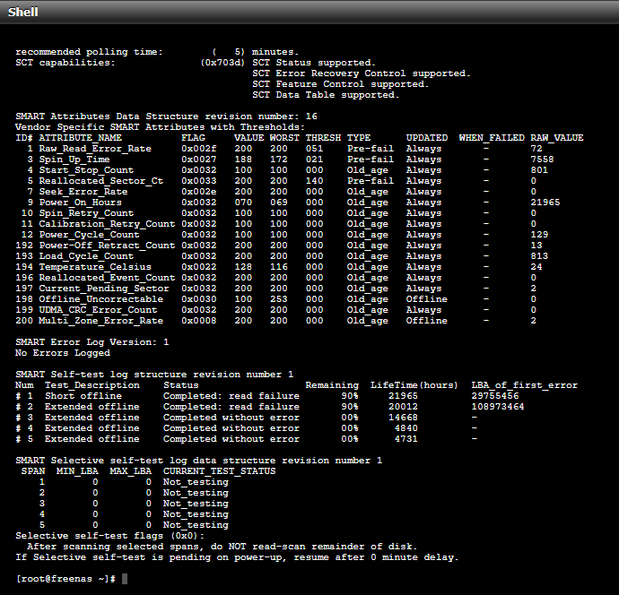

captclearleft
Oct 27, 2019
21
I know this is old, but...
I have the same issue. Thinking it's time I change out this drive.
If someone can read this short test, and tell me their thoughts - I'de greatly appreciate it.
