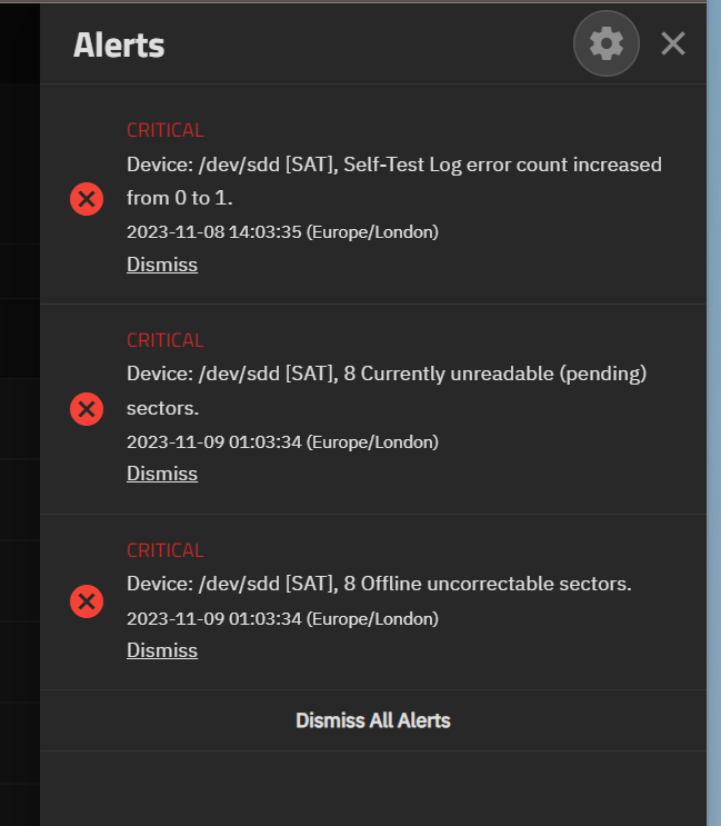

Hi All
I had a failing disk that I replaced. When I did this all the red alerts for the disk were cleared. Since then I have had to revert to an old backup and the alrets came back. I now have a new disk with the same name as the one that had failures (sdd). The drive is fine with no issues but the alerts won't go away.
How do I get turenas to realise that the drive is fine and to clear the alerts (I don't want to just dismiss the alerts)
Thanks

I'm sorry if my question was unclear. I will try to be more clear. I had this sequence of events:
  1. Drive began to fail and gave me 3 critical alerts (self test log increased from 0 to 1, 8 currently unreadable sectors, 8 offline uncorrectable sectors)
  2. I replaced the drive, resilvered ect
  3. Alerts all went away
  4. An unrelated issue happened and I messed up my boot disk
  5. I re-installed my boot disk
  6. I reverted to older backup from when I had the drive failure alerts
I am now in the situation where I have a brand new disc and the alerts that appearing in the UI are for a disc that has already been removed. I expected these alerts to clear when Truenas realised that the disc was no longer present.
I would like to remove the alerts (not just dismiss them so that they are still there but hidden)

If you are about the alerts in the top right chime menu, you can only dismiss them (they disappear after a set amount of time I believe) without fiddling with the CLI.
Clearing your browser's cache might help.

Yes, I am talking about the alerts top right:
so I just need to wait? They are 5 days old already. Does anyone know how long until they disappear?
