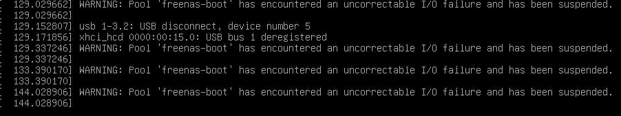

Hi team,
Due to a mistake configuring my VM, TrueNas Scale is now refusing to boot.
This is because my system disk is on a USB drive and I shared the USB controller it sits on with my VM.
Now, everytime TrueNAS starts, it kicks in the VM, set as Auto start and throw the following error message:
I have a plan on how to solve this strategically (go SSD!) but i would like to not have to reinstall TrueNAS.
Is there a way to simple disable the VM autostart from the recovery mode CLI?
I believe these must be a configuration file I can edit with VI? What is the path?
Regards,
Florian

I can't use the CLI with a keyboard plugged into the server because I passed through the USB controller to the VM and it auto starts. My network config is screwed up so I was gonna fix it but I can't.
Nicholas Flamy
Feb 25, 2023
28
I'm gonna either see if I can blindly shut down the VM (MacOS) or disable virtualizatiin in the BIOS so that the VM won't start.
