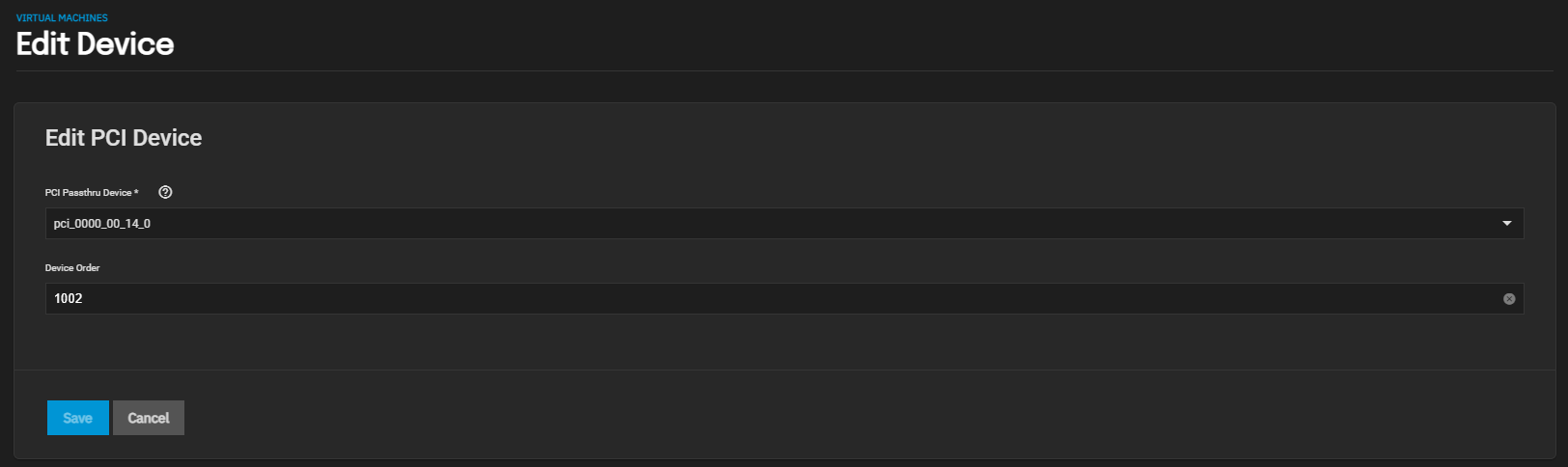

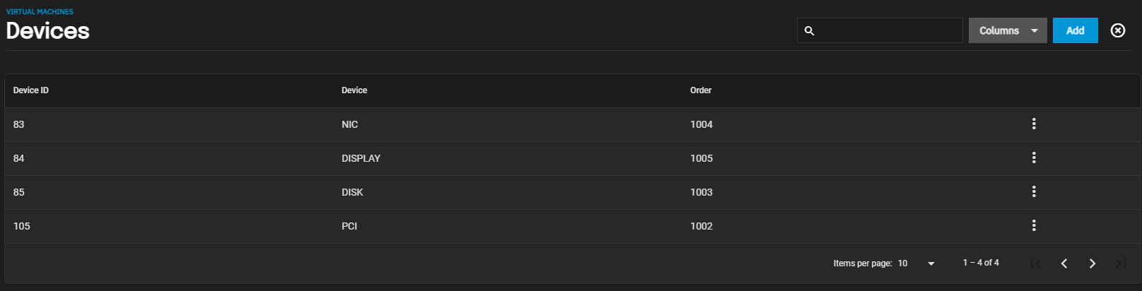

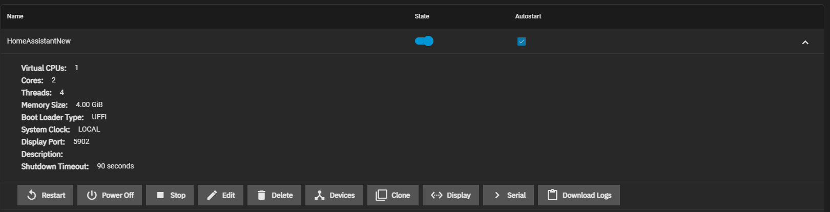

Here is my config:

Could you let us know what the specific PCIe device is. Vendor & model.
Not clear whether its a generic PCIe pass-thru issue or a specific one. Has anyone else had issues?

I did some further testing: If I don't autostart the VM, the VM boots normally (manual start), as soon I autostart the VM with truenas, the VM won't boot.
My pci-device:
00:14.0 USB controller: Intel Corporation Cannon Lake PCH USB 3.1 xHCI Host Controller (rev 10)
