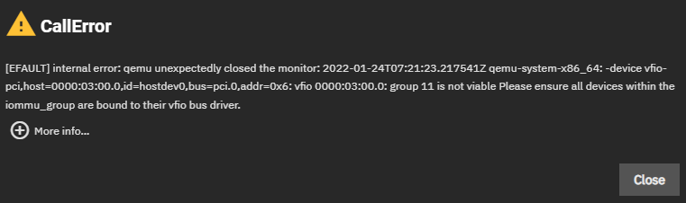

If i boot the VM with no PCI device it works fine, however as soon as I add either of the NIC's as a PCI Pass through device and try to start the VM I get the below error:

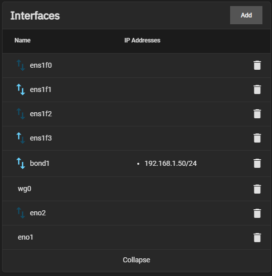

I have a 4-port 1GB PCI card with a bonded interface that i'm using for access to TrueNAS, the two devices i'm trying to pass through are eno1 and eno2 (as per the screenshot below)

This is the full error:

libvirt.libvirtError: internal error: qemu unexpectedly closed the monitor: 2022-01-24T07:29:55.219660Z qemu-system-x86_64: -device vfio-pci,host=0000:03:00.0,id=hostdev0,bus=pci.0,addr=0x6: vfio 0000:03:00.0: group 11 is not viable
Please ensure all devices within the iommu_group are bound to their vfio bus driver.
