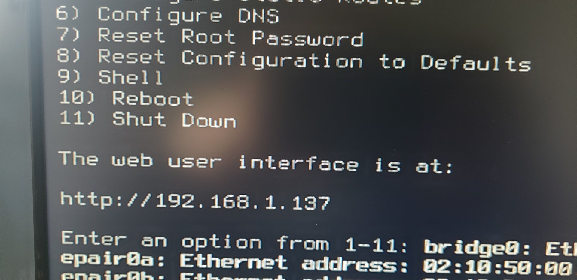

Can you confirm that the IP address of the FreeNAS server is 192.168.1.137? How did you establish it?
Unless I'm misunderstanding something, these points appear to contradict each other.
How do they contradict? Before I moved things around, I had the second router connected via ethernet to the main router upstairs (the one currently connected to the main PC, which is the PC that I CAN grab the files off the server from). I had the second router which was downstairs at the time basically set up as an AP. Then I had him the server plugged into that. The original setup worked that way, I could connect to the main router via my own PC wirelessly, and connect to the server that way.
To answer your questions:
- Nope, neither of those shares work.
- What do you mean by that exactly?
- I already shared a picture of that, on the first page. That's the error I get when attempting any share, even the ones I know are actual shares.
- I can confirm. On the console of the server it shows that's the IP. It set it up by itself when first installing the FREENAS software. It's the same IP as before I reset configs so I am guessing when it set it up again it just used the same IP as before, if you get what I mean? Also, it was the same IP I used when I mapped the share previously about a month ago when I first set everything up (back when it worked before I moved everything.)

Image.

Are you on Freenas 11.1 or something?
I have noticed your screenshot show bridges of Ethernet ports. I think those are iocage jails address you assigned, such as OpenVPN and the like.
I suspect one of your jail IP was made the default IP to Freenas causing issues with you Share.
Well it's working now, but yes I am on 11.2. Also, I didn't make any jails or OpenVPN, so... I wouldn't know. But it's working now.
