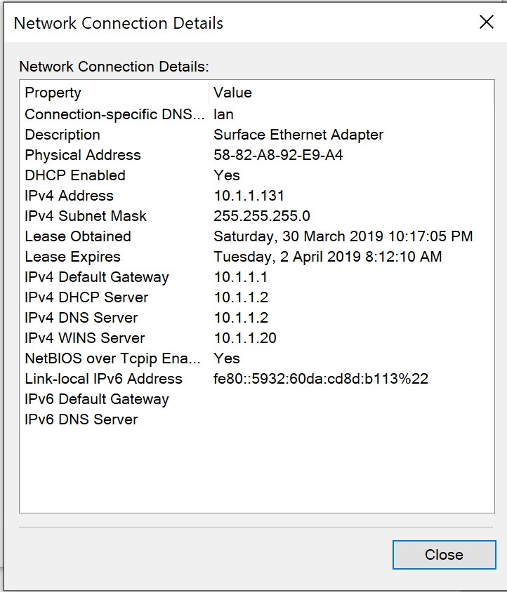

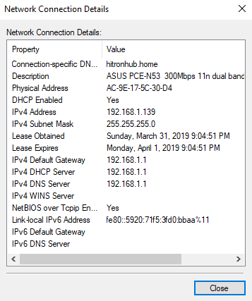

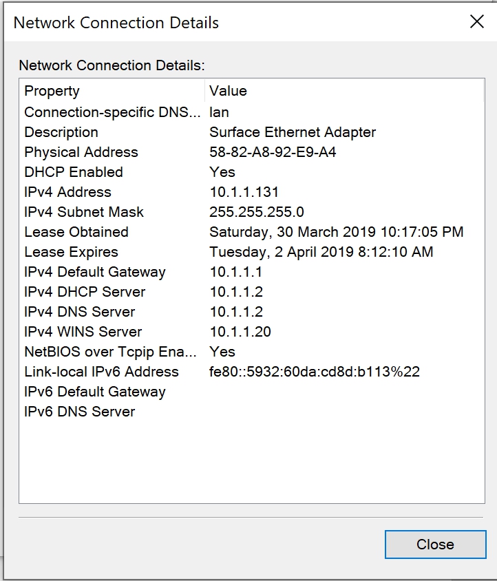

Can you provide screenshots of the Network Connection properties on both the main computer and your computer?

Can you provide screenshots of the Network Connection properties on both the main computer and your computer? eg.
I can't provide one of the main computer just yet (I can in maybe 45 mins?) but on my personal PC I can. Here ya go. (Would it be maybe because I have DHCP enabled? Possibly? I didn't think of that before.)

That looks okay. You're saying you can't access the server from this PC, your personal PC. I assume you're currently on your home network?

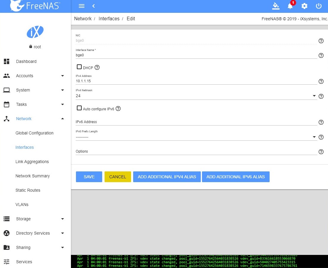

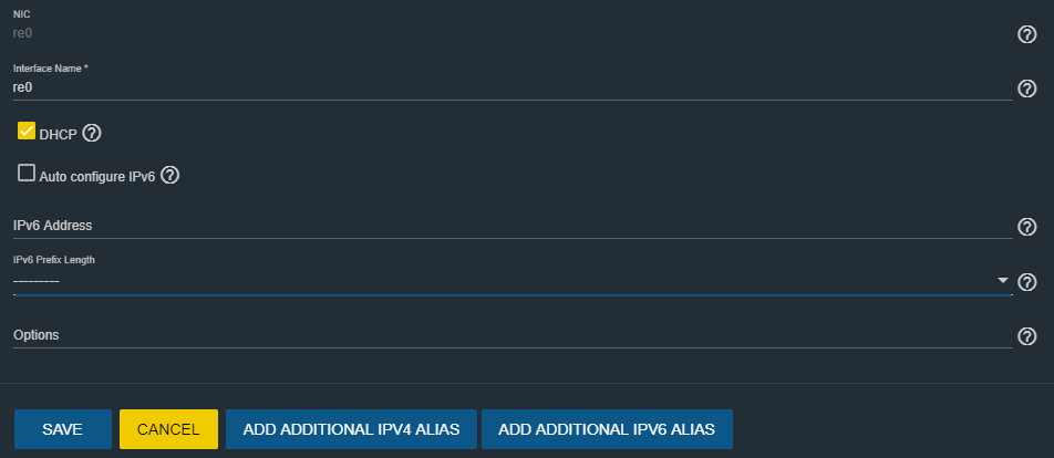

Ouch! You do need to configure the server network properties. Let's start with a screenshot of the network Interface details.
Jan 4, 2014
1,644
While that's okay atm, it's preferable to fix the IP address for the server. If the IP address keeps changing, as it will with DHCP enabled, it will make life difficult for you when mapping by IP address. We'll get to this later.

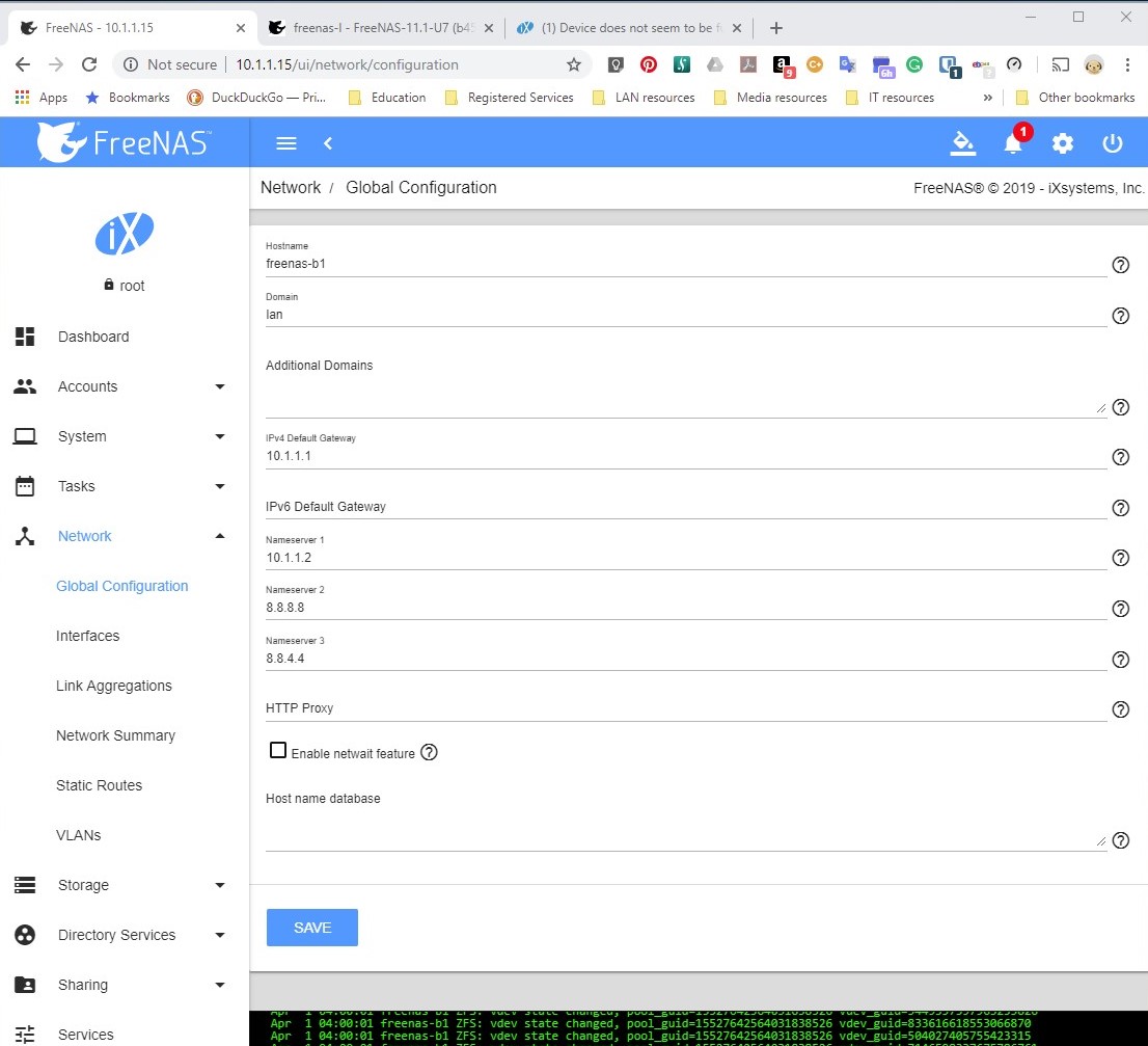

Next a printout of Network > Global Configuration.

There's nothing in global configuration, nothing is set. What should I set that to?
Jan 4, 2014
1,644
At the very least, is a hostname defined? Anyway, set the IPv4 Default Gateway and Nameserver 1 to the LAN address of your router, which I believe, from an earlier screenshot, is 192.168.1.1.
Chesse
Jan 7, 2019
56
Yeah it's got a hostname but all the IPs and stuff aren't set, until now of course. I've done that now

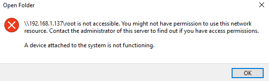

That's the issue. I have the share set up, however, the only thing that Windows will accept is \\(IP address)\root , and it will let me map that, but as soon as I try to access the folder, it gives me an error telling me a device attached to the system is not functioning, or something along those lines.

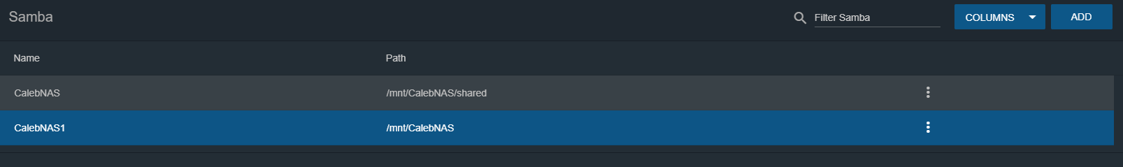

Is root a share? Can you please provide a screenshot of Sharing > Windows (SMB) shares under FreeNAS?
Chesse
Jan 7, 2019
56
I don't think so. Here's the screenshot (I tried multiple when troubleshooting)
