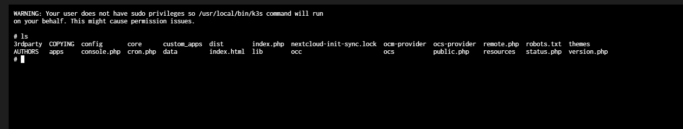

So that's telling you why you can't run it... there's no PATH variable, so you need to specify the full path to php also.
But as is already mentioned by @sfatula the cron service isn't there in the container, so what you're trying to run won't work even when you get it to run.
You'll need to work out where php is in the container.
You can go to the shell of the container and typewhich php(assuming the shell gets a good path), or maybe you'll need to find it withfind / -name php

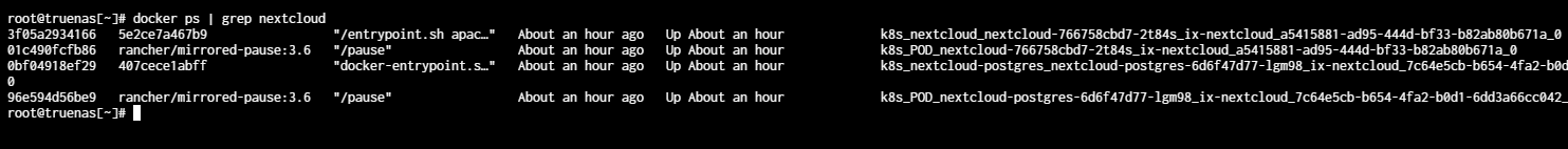

But now... the command "docker ps | grep nextcloud" does not work for me, when updating I would like to know what the new one would be and how to configure the new cron for nextcloud
Scale 22
docker exec --user root `docker ps | grep "nextcloud_nextcloud" | awk '{ print $1; }'` php cron.php
Scale 23
docker exec --user www-data `docker ps | grep "nextcloud_nextcloud" | awk '{ print $1; }'` php -d memory_limit=-1 -f /var/www/html/cron.phpk3s kubectl exec -n ix-nextcloud -c nextcloud -i `k3s kubectl get -o wide -n ix-nextcloud pods | grep 'nextcloud-[0-9]' | awk '{ print $1; }'` -- su -s /bin/bash www-data -c 'php -d memory_limit=-1 -f /var/www/html/cron.php'docker exec --user www-data `docker ps | grep "nextcloud_nextcloud" | awk '{ print $1; }'` php -d memory_limit=-1 -f /var/www/html/occ preview:pre-generatek3s kubectl exec -n ix-nextcloud -c nextcloud -i `k3s kubectl get -o wide -n ix-nextcloud pods | grep 'nextcloud-[0-9]' | awk '{ print $1; }'` -- su -s /bin/bash www-data -c 'php -d memory_limit=-1 -f /var/www/html/occ preview:pre-generate'-i
