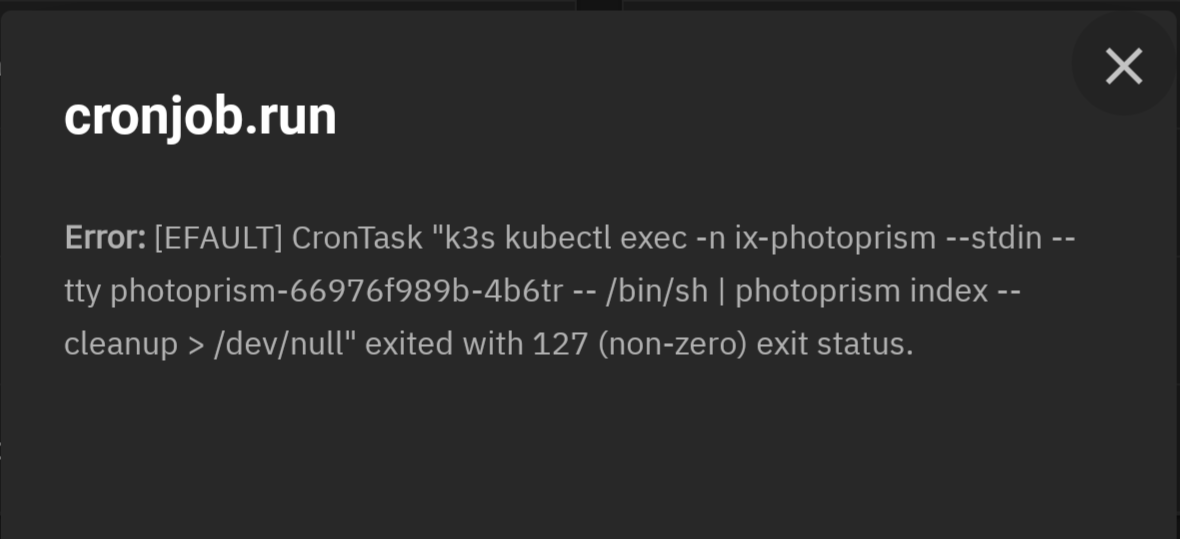

I tried this as my Cron command: "k3s kubectl exec -n ix-photoprism --stdin --tty photoprism-66976f989b-4b6tr -- /bin/sh | photoprism index --cleanup" but get the attached error.

Ah please disregard my last post! some further reading, I just needed to remove the /bin/sh | from my line and all working. thank you!
