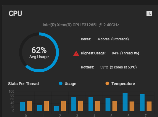

Good evening.
I just added a further NIC to my Truenas Scale server, restarted and CPU utilisation was very high. Thinking this was related to the new NIC I downed the server and removed the NIC. Restarted. CPU utilisation is still very high

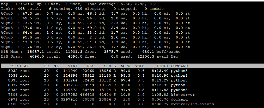

From top
Oddly enough it's just settled down to it's usual relaxed self, after about 10 minutes.
Though I really would appreciate some pointers of what may have been causing the issue. I think I've attached everything that's needed. Wanting to resolve this due to wanting to virtualise my firewall onto it (hence the new NIC)

One of the first things scale does after a reboot is syncing the apps catalogues, which cause high cpu usage.
If you've added truecharts it can take up to 5 minutes.
