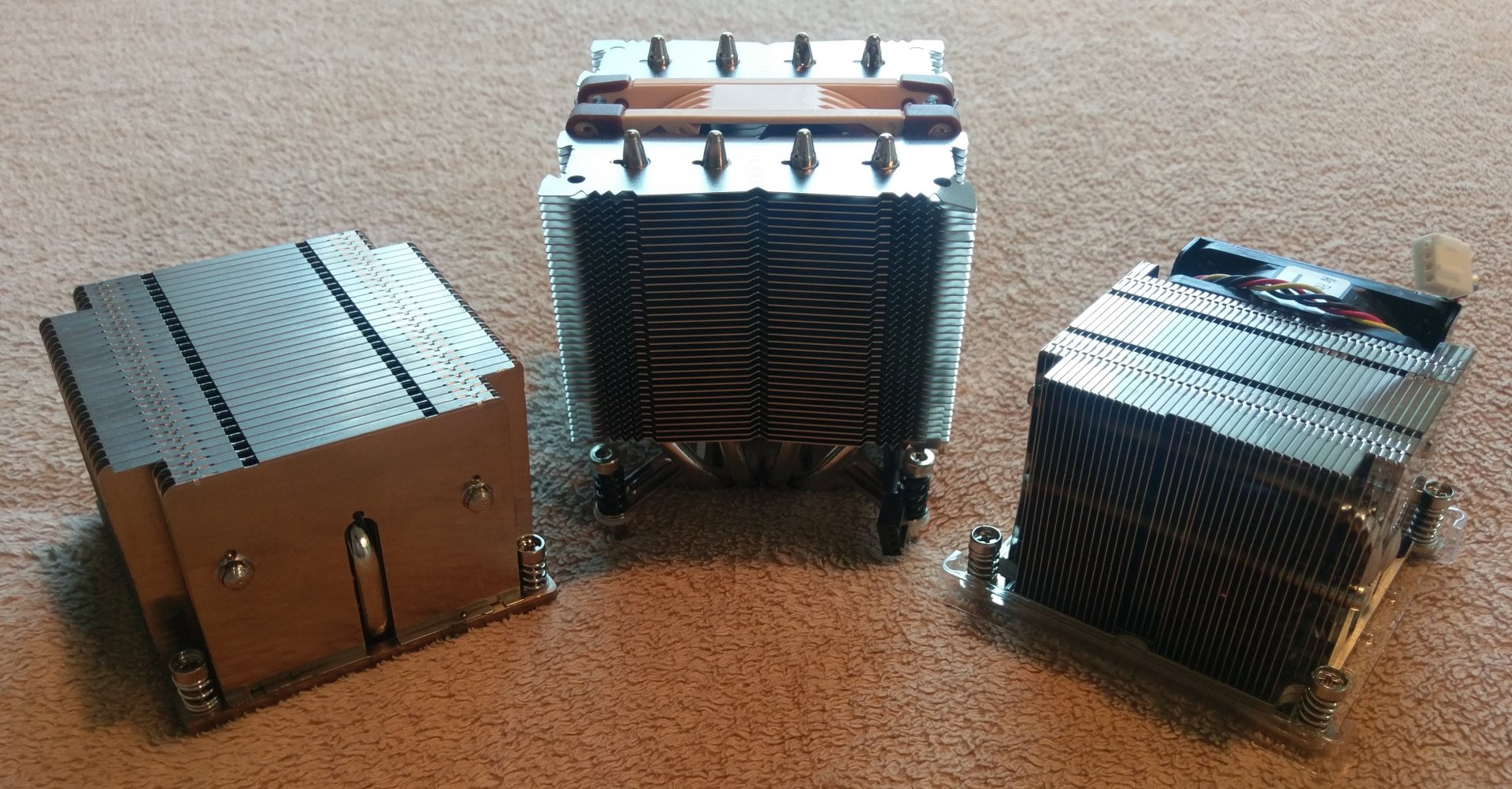

Compared CPU Cooling Solutions

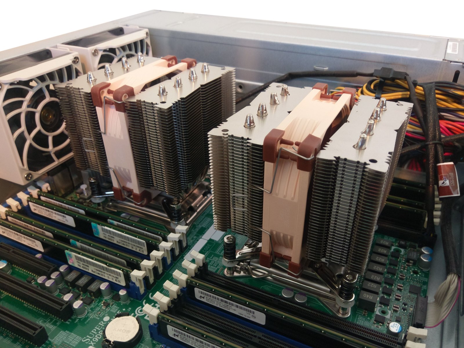

  • Noctua NH-D9DX i4 / NH-D9L
    • Fan: Noctua NF-A9 PWM (92 x 92 x 25 mm / Current = 0.1A)
    • Speed: Min = Speed: 400 RPM (+/-20%) / Max = 2000 RPM (+/- 10%)
    • Performance: Max Airflow = 46.4 CFM / Max Static Pressure = 0.09 in H₂O / Max Sound Pressure = 22.8 dB(A)
    • Note: The Noctua NH-D9DX i4 comes with LGA 2011 Narrow ILM brackets, but the NH-D9L does not, which is the only difference between the two models.

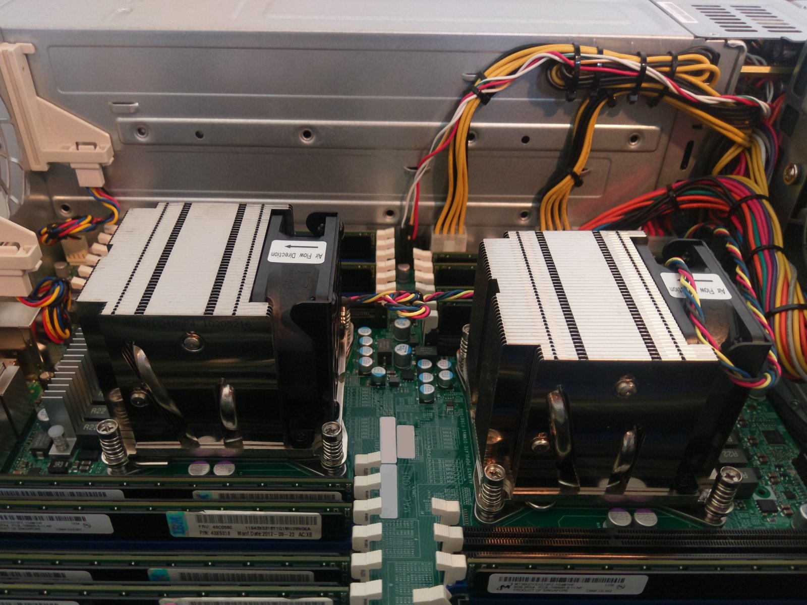

  • SuperMicro SNK-P0048AP4 - 2U Active CPU Heat Sink
    • Fan: Nidec UltraFlo H60T12BHA7-57 (60 x 60 x 25 mm / Current = 0.57A)
    • Max Speed: 8400 RPM
    • Performance: Max Airflow = 43.1 CFM / Max Static Pressure = 0.83 in H₂O / Max Sound Pressure = 52dB(A)
  • SuperMicro SNK-P0048P - 2U Passive CPU Heat Sink

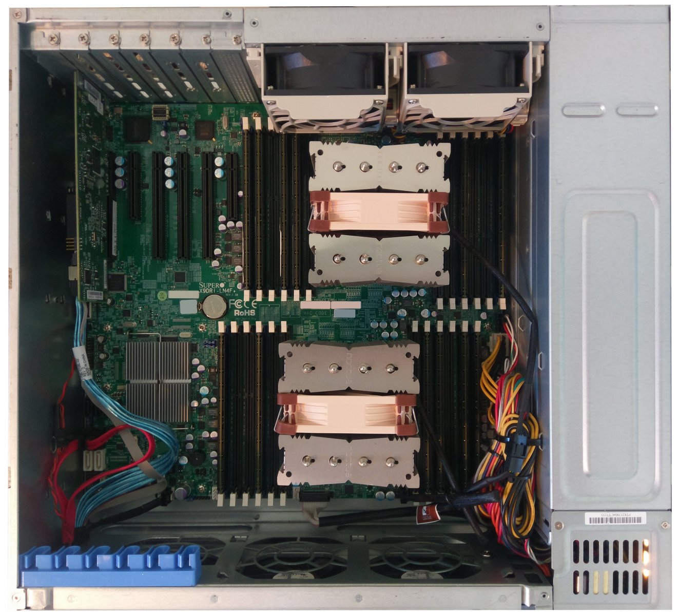

Relevant Test Machine Specifications
  • Chassis: SuperMicro SC836E16-R1200B
  • Motherboard: SuperMicro X9DRi-LN4F+ | 2 x Intel Xeon E5-2670 | 96GB Micron DDR3 ECC 1333 MHz VLP RAM
  • Rear Exhaust / Chassis Middle / Fan Header Configuration:
    • FAN1/2 = CPU1 Fan / CPU2 Fan
    • FAN5/6: 2 x FAN-0125L4 Rear Exhaust Fan
    • FANA: 3 x FAN-0126L4 Chassis Middle Fan via splitter (allows Zone 0 and Zone 1 fan control, see "References" section)

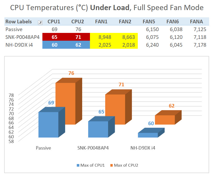

  • Having researched the two CPU cooling solutions, I walk into the test knowing that the Noctua NH-D9DX i4 / NH-D9L [46.4 CFM @ 2000 RPM, or 22.8 dB(A)] is rated for higher airflow at a significantly lower sound pressure level than the SuperMicro SNK-P0048AP4 [43.1 CFM @ 8400 RPM, or 52.0 dB(A)], so the only real question becomes: How important is static pressure to the equation and will that provide the SuperMicro SNK-P0048AP4 with an edge?

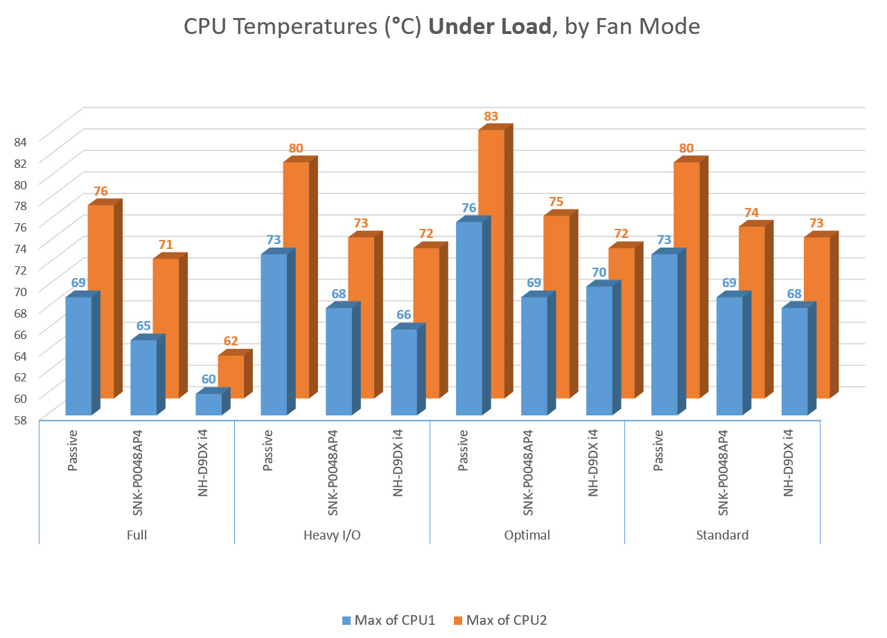

  • With that information under our belt, I present results from the what I would consider to be the single most important fan mode / load combination, if one were to be chosen: Full Speed, Under Load.
  • Here the Noctua NH-D9DX i4 / NH-D9L easily bests the SuperMicro SNK-P0048AP4 by 5°C and 9°C, CPU1 and CPU2, respectively.
  • As you may infer, the balance the results for the other fan modes Under Load agree with this snapshot.

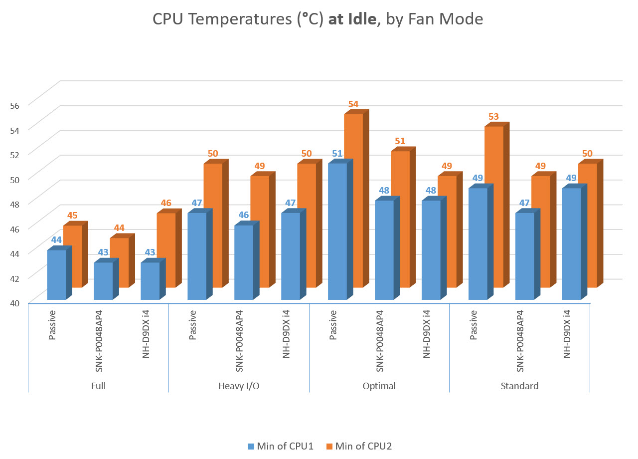

  • Here are our results for Idle:
  • For CPU1, nothing noteworthy for either solution, with the max variance between the fans and passive heatsink being 3°C. We do see the SuperMicro SNK-P0048AP4 post lower or equally low temperatures for all fan modes though.
  • For CPU2, again the SuperMicro SNK-P0048AP4 posts lower temperatures for 3 of 4 fan modes, the exception being Optimal.
  • Here are our results for Load:
  • For CPU1, the Noctua NH-D9DX i4 / NH-D9L posts lower temperatures for 3 of 4 fan modes, the exception being Optimal where it loses by only 1°C.
  • For CPU2, the Noctua NH-D9DX i4 / NH-D9L posts lower temperatures for all fan modes.
  • I find it interesting that the temperature variance between CPU1 and CPU2 is constant across all fan modes for the passive heatsink (CPU2 + 7°C) and always CPU2 +5°C/+6°C for the SuperMicro SNK-P0048AP4. It is a different story for the Noctua NH-D9DX i4 / NH-D9L though, with that variance being reigned in at CPU2 +2°C for the Full Speed and Optimal fan modes.

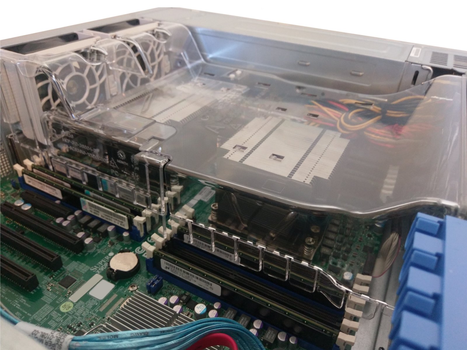

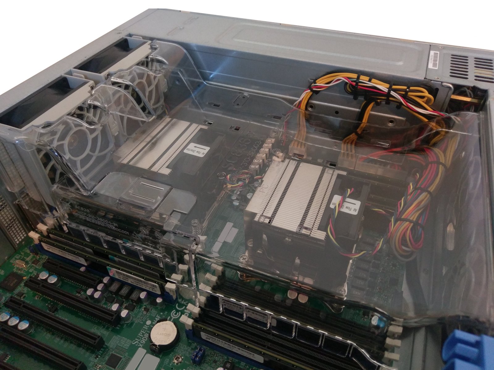

  • The results make me question whether active CPU cooling is needed for this chassis, motherboard, and CPU configuration. Surely not, if the server was located in a datacenter and the fan mode was left at Full Speed, as a passive heatsink keeps CPU temps well under 80°C. An active CPU cooling solution would likely not be desired with sufficiency of a passive solution as CPU fans present an additional component that could potentially stop functioning and CPU fans aren't exactly hot swapable. Even with the Heavy I/O and Standard fan modes, the maximum CPU temperature was 80°C. It is only with the Optimal mode that temperatures start to be concerning at 83°C.
    • Bear in mind that the test was conducted with the Rear Exhaust Fans assigned to Zone 0 and the Chassis Middle Fans assigned to Zone 1, which allows me to control fan speed in response to HDD temperatures. If a passive heatsink were the permanent CPU cooling choice, you would want all fans on Zone 0 and correspondingly you wouldn't see CPU temperature topping 80°C as the Chassis Middle Fans would be spun up to cool the CPUs. As the test was conducted though, the Chassis Middle Fans were connected to Zone 1 which fixes fan speed at ~30%. Indeed, upon reviewing the data for the passive solution to confirm (fan RPMs were also recorded), the average Chassis Middle Fan speed was 3,705 RPMs for Optimal (whereas they averaged 7125 RPMs for Full Speed, 5742 RPMs for Heavy I/O, and 5903 RPMs for Standard).
    • I believe the general effectiveness of the passive heatsink paired with the air shroud speaks loudly to the engineering acumen of Supermicro. With appropriate Chassis Middle and Rear Exhaust Fans (and connected to the correct fan headers), put quite simply: it just works.
    • Advantages: Best performance, Quietest fan.
    • Disadvantages: Most expensive solution, Cannot be run with air shroud in place, Fan cable does not reach FAN1/2 from CPU2.
    • Advantages: Can be run with air shroud in place, comes with thermal paste pre-applied.
    • Disadvantages: Worst performing fan, Loudest fan.
    • Advantages: Least expensive solution, Quietest solution.
    • Disadvantages: Worst performance overall (expected).
Photos
Noctua NH-D9DX i4:

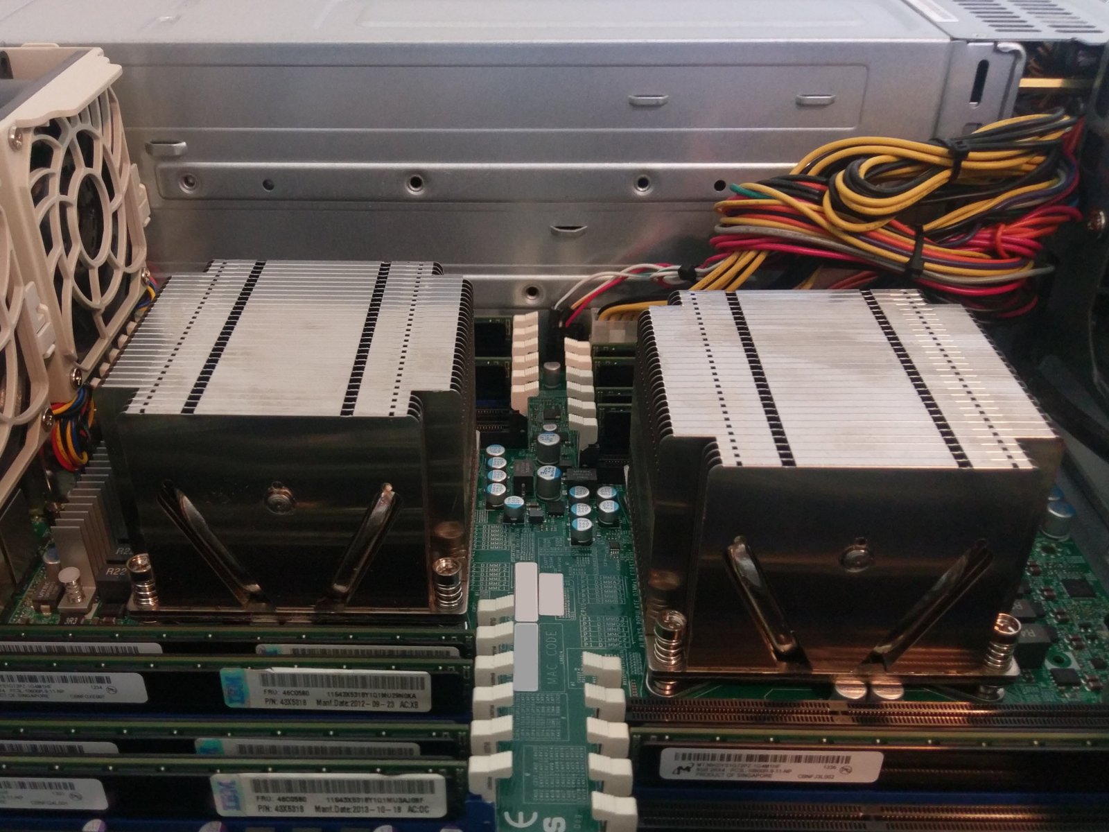

SuperMicro SNK-P0048AP4:
SuperMicro SNK-P0048P:
