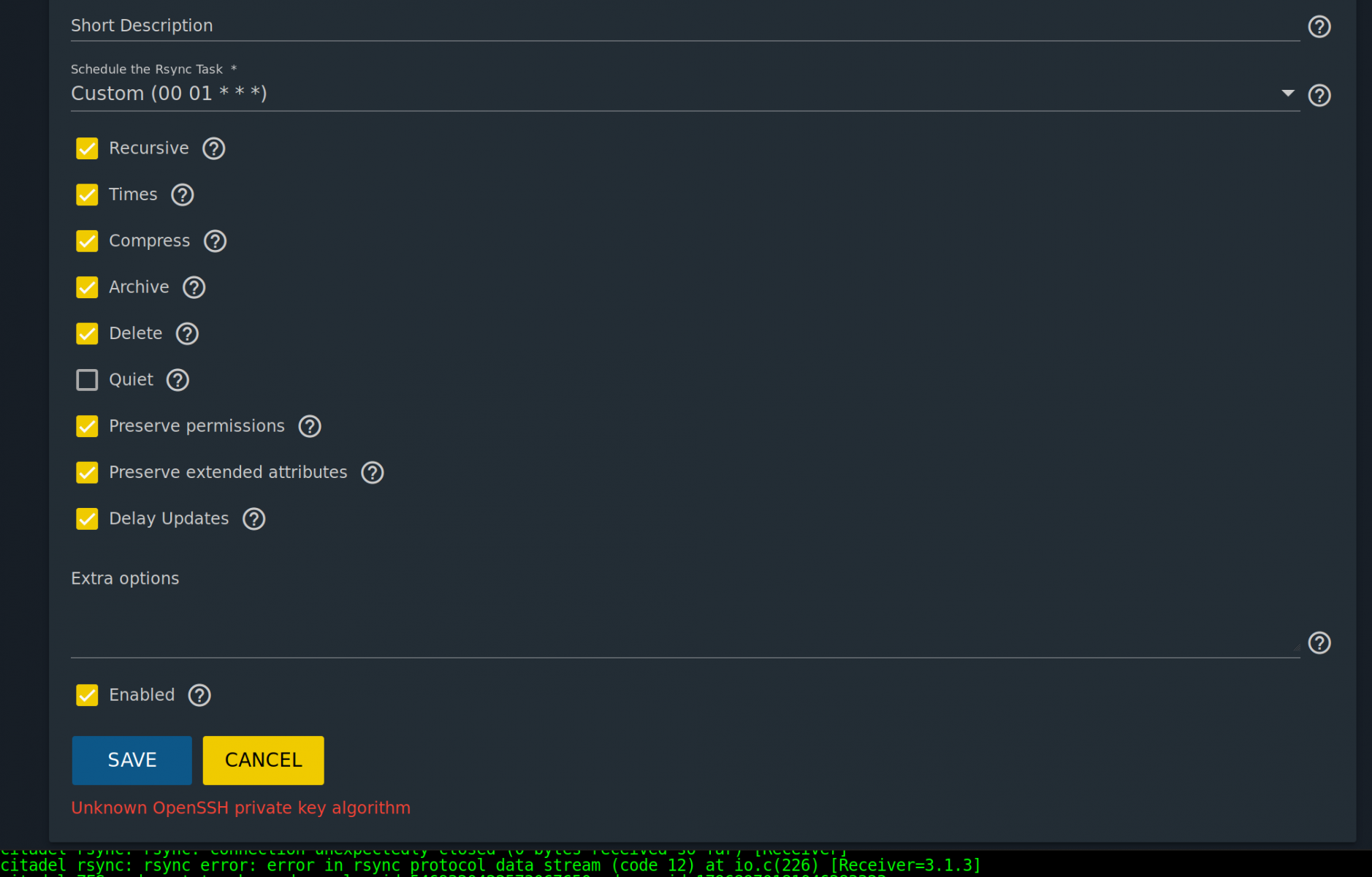

I'm trying to fix up my rsync backup tasks, since they stopped working when I switched to using `.local` for my home network.
I think I have it all set up right. I can SSH from the NAS to my desktop computer with a keypair. But the Freenas GUI says "Unknown OpenSSH private key algorithm"

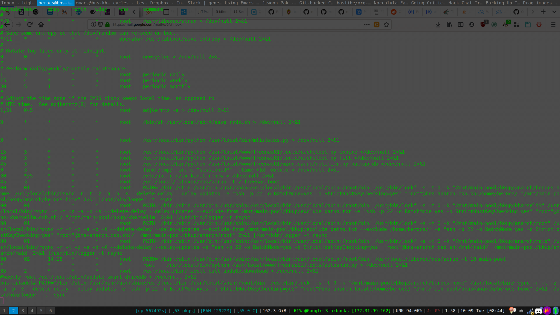

If I dig into /etc/crontab and take the old rsync task, update it to have .local for the hostname, and run it, it appears to work. So whatever is keeping me from saving the config on the GUI appears to be some sort of validation on the webpage..?

Disabling "Validate remote path" on the rsync task allows me to save the task, and the hostname is appropriately updated. But now clicking "Run now" has no effect, and nothing is written to the system log even though the "Rsync task started" popup appears...

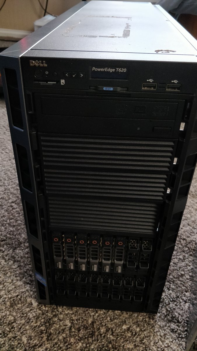

Oh, and I found a server someone had thrown out on the curb.
2x Xeon E5-2640 @ 2.5GHz and 12G of DDR3-8400 RAM.
It's running memtest right now.

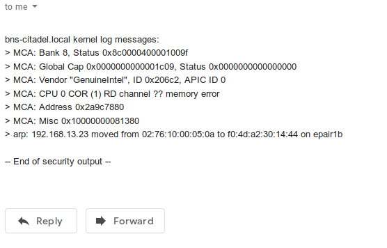

ctag
Jun 16, 2017
225
More memory errors.
bns-citadel.local kernel log messages:
> MCA: Bank 8, Status 0x8c0000400001009f
> MCA: Global Cap 0x0000000000001c09, Status 0x0000000000000000
> MCA: Vendor "GenuineIntel", ID 0x206c2, APIC ID 0
> MCA: CPU 0 COR (1) RD channel ?? memory error
> MCA: Address 0x2a9c7880
> MCA: Misc 0x10000000080381
> arp: 192.168.13.23 moved from 02:ad:10:00:05:0a to f0:4d:a2:30:14:44 on epair1b
-- End of security output --

So I was still getting the "Cannot validate remote path" error on my rsync tasks, and found that removing my ed25519 key cures the error... Which seems both silly and frustrating.
ctag
Jun 16, 2017
225
Now my rsync tasks are failing with:
  File "/usr/local/lib/python3.7/site-packages/middlewared/job.py", line 349, in run
    await self.future
  File "/usr/local/lib/python3.7/site-packages/middlewared/job.py", line 388, in __run_body
    rv = await self.middleware.run_in_thread(self.method, *([self] + args))
  File "/usr/local/lib/python3.7/site-packages/middlewared/utils/run_in_thread.py", line 10, in run_in_thread
    return await self.loop.run_in_executor(self.run_in_thread_executor, functools.partial(method, *args, **kwargs))
  File "/usr/local/lib/python3.7/site-packages/middlewared/utils/io_thread_pool_executor.py", line 25, in run
  File "/usr/local/lib/python3.7/site-packages/middlewared/schema.py", line 964, in nf
    return f(*args, **kwargs)
  File "/usr/local/lib/python3.7/site-packages/middlewared/plugins/rsync.py", line 609, in run
    f'rsync command returned {cp.returncode}. Check logs for further information.'
middlewared.service_exception.CallError: [EFAULT] rsync command returned 12. Check logs for further information.
And a log of:
rsync: This rsync lacks old-style --compress due to its external zlib.  Try -zz.
rsync error: syntax or usage error (code 1) at main.c(1578) [server=3.1.3]
rsync: connection unexpectedly closed (0 bytes received so far) [Receiver]
rsync error: error in rsync protocol data stream (code 12) at io.c(226) [Receiver=3.1.3]
The new log download feature in 11.3 is nice, and that quickly led to the workaround: uncheck "Compress" and add "-zz" to the CLI options.
