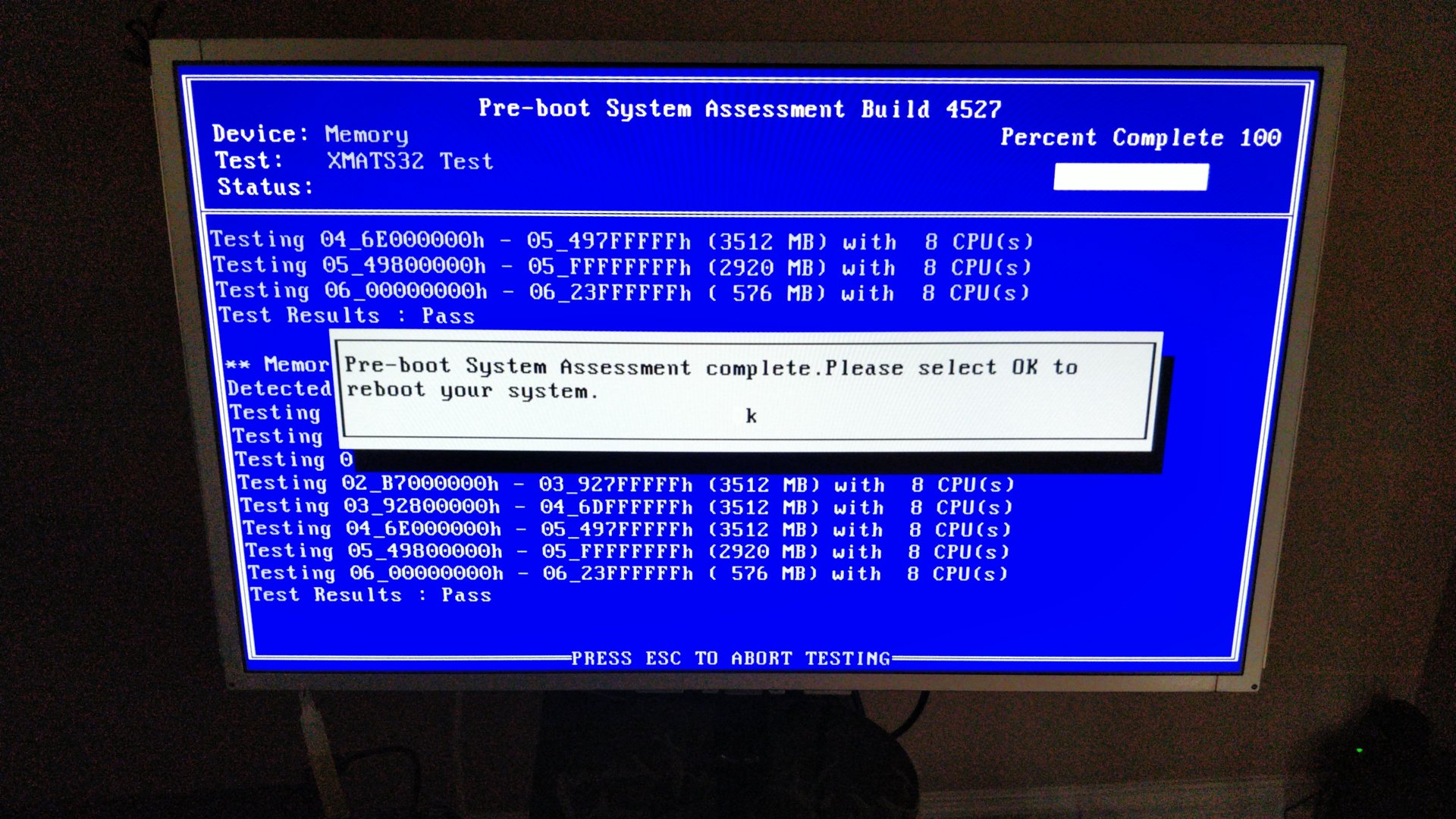

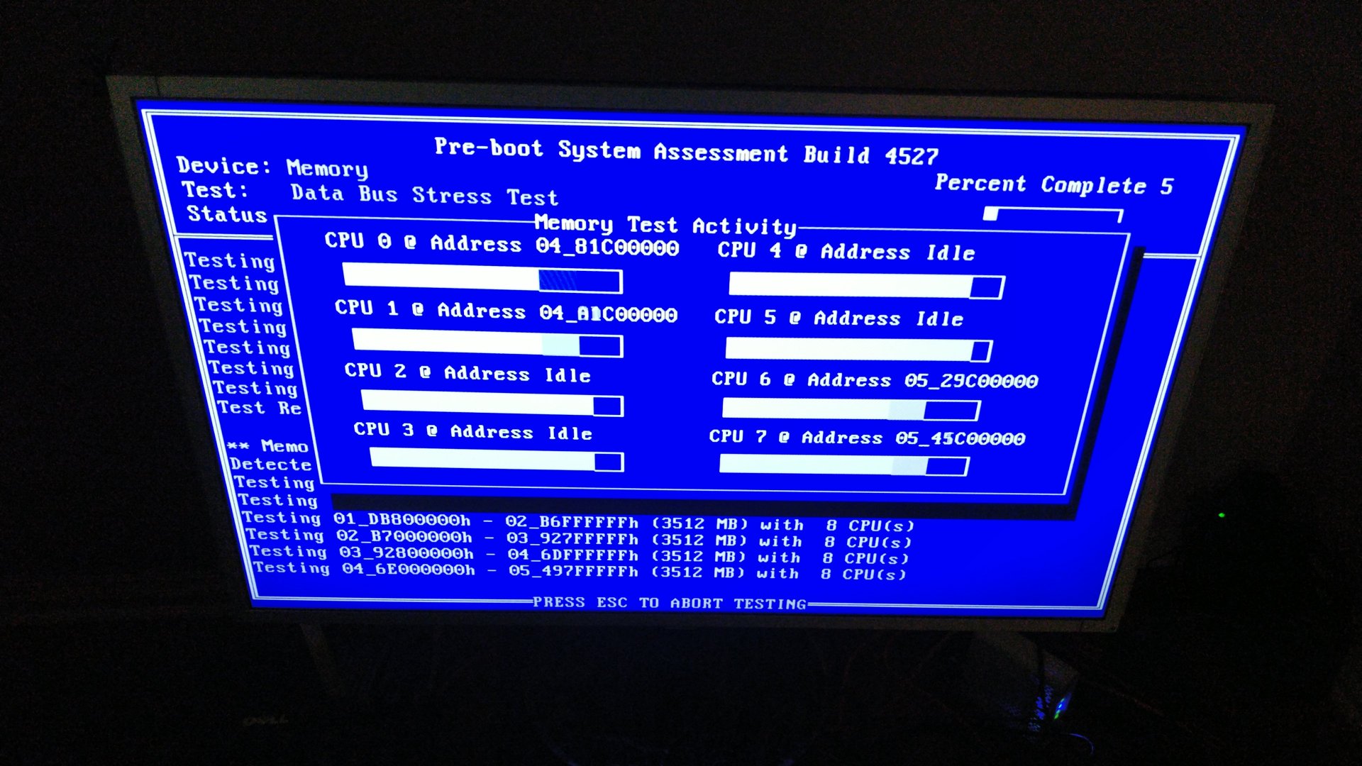

Thanks Chris.
I couldn't find any memory tests in the system BIOS menu. From this manual it looks like I'm missing a Diagnostics CD?
http://sivirt.utsa.edu/Documents/Manuals/precision-t7500_Service Manual_en-us.pdf

If it is the Precision T7500, if I recall correctly, you should be able to press F-12 during boot to get a boot menu and one of the options on the boot menu is to boot into diagnostics. I know that newer Dell workstations have diagnostics integrated on the system board and I thought that the T7500 was new enough to have it also. It is not accessed from the BIOS configuration, you need to boot from the diagnostics option of the boot menu. It is like you were selecting a different hard drive or CD drive to boot from.
ctag
Jun 16, 2017
225
Ah, I had to hit the key blind, the computer moves past that screen before my monitor wakes up.
The memory test took half an hour (which was much faster than I expected) and appears to have passed. I restarted the system and it booted up OK.
Thank you for the help!

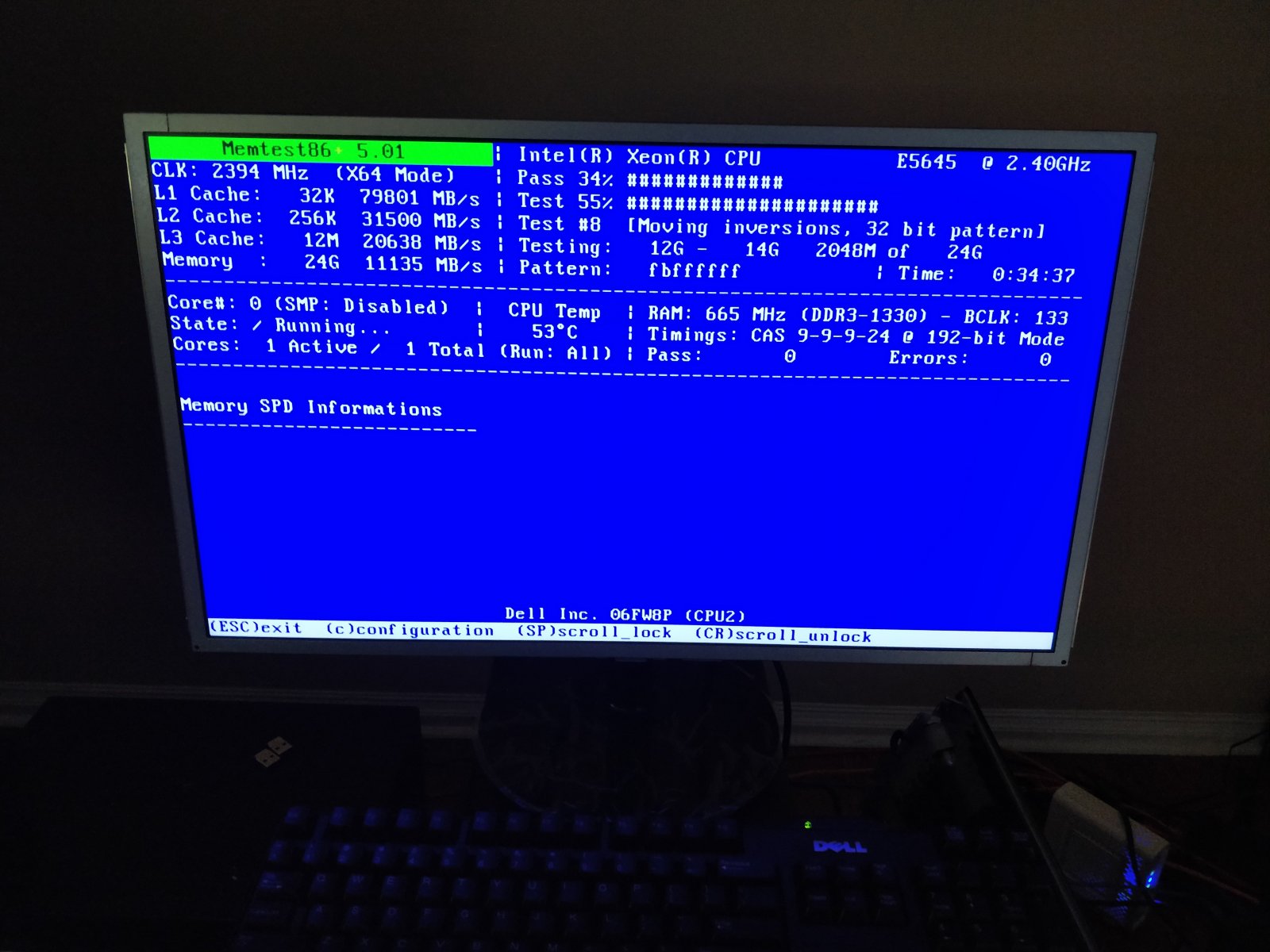

Should I go find a memtest disk and try a few passes of that?

OK, finally got memtest running again. I'm going to give it a few days worth of passes and see if anything comes up. Sucks to not have my services while the system is down though o_O

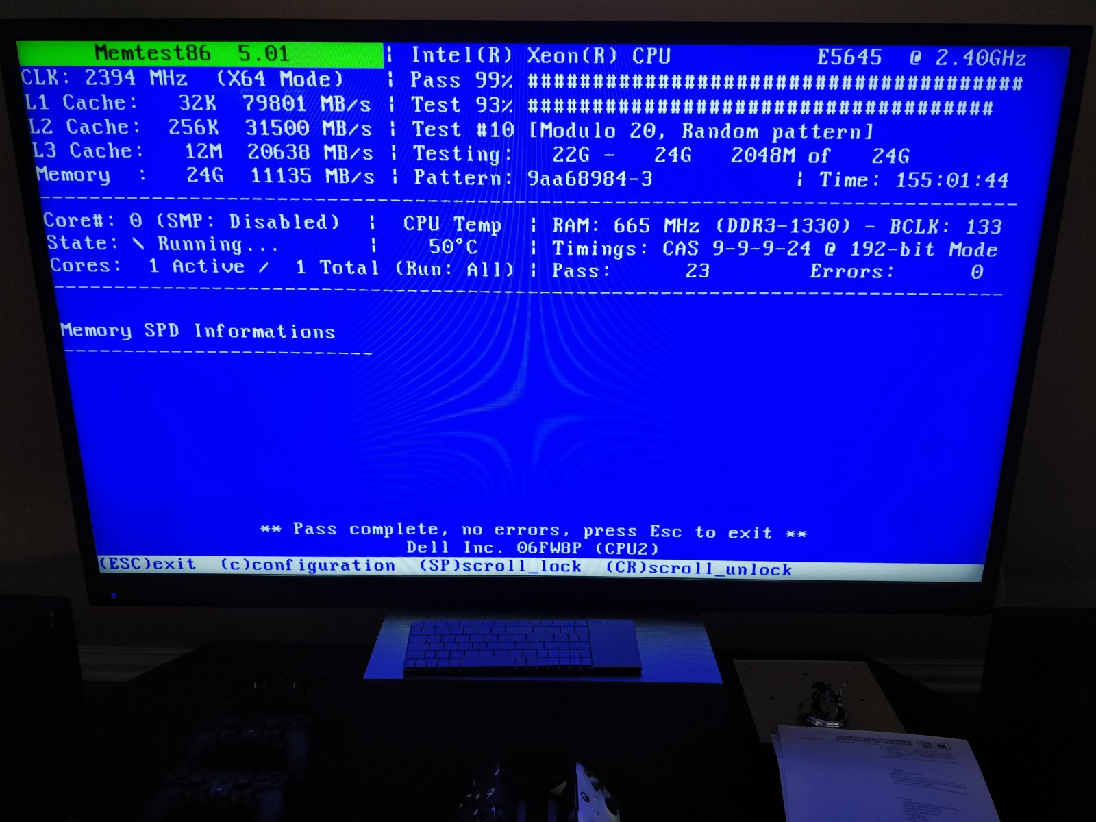

Two days of memtesting, 7 passes and no errors so far.
I'm going to let it keep running, but have some observations.
I've suspected previously that the case temperature was playing a role in the memory errors. I've gotten alerts previously because the hard drives have gotten too warm, and indeed the AC system in the house has been struggling to keep the building cool this summer. It felt like the memory errors were more common when the temperature was higher. That AC system died outright yesterday, and the temperature got pretty high as a result. Still no errors in memtest leads me to believe temperature, while an issue for hard drives, is not causing the memory errors.
My roommate informed me that the system, while it was running FreeNAS, had a high-pitched whine that I couldn't hear but was quite annoying to him. He promised it didn't sound like a normal computer, and informed me that something in there was probably getting ready to break. That sounds like either the hard drives or power supply to me, and I'm wondering if the power supply is going bad and is responsible for the RAM issues. It could explain why the memory errors only take place while the full system is running (6 hard drives included) but not with just memtest.

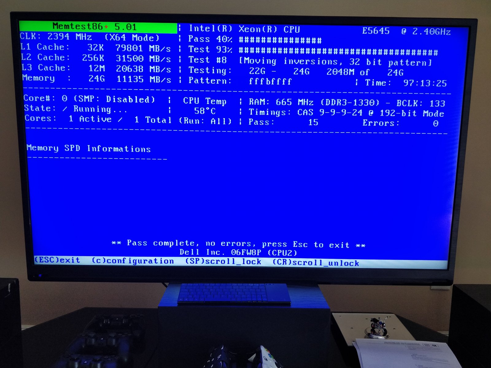

15 passes now.
AC is still out. Our rental company has been useless for over a week now. I'm starting to think I don't have an adequate environment to be playing with computers.

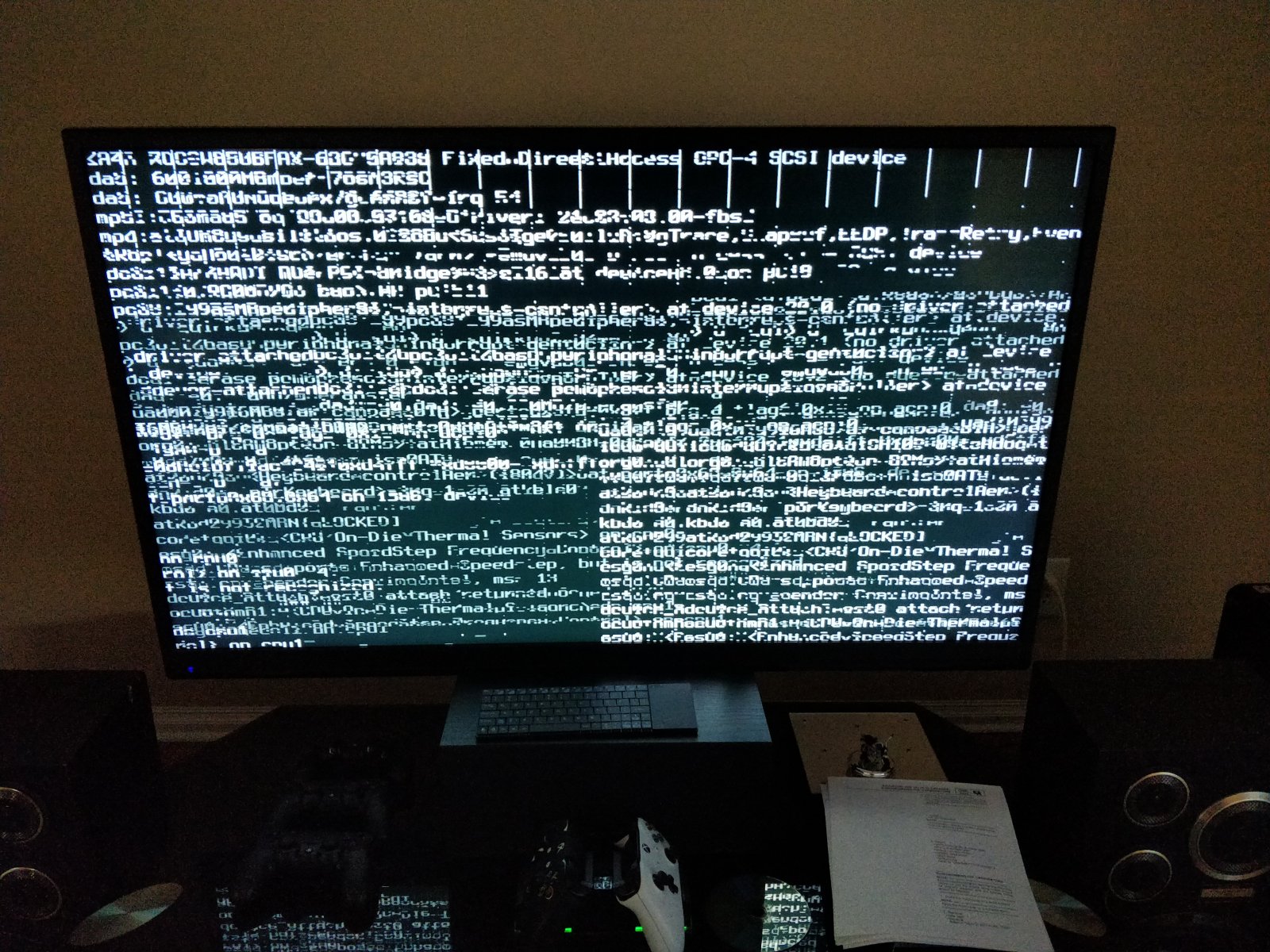

OK, final count: 23 passes, no errors.. The AC is fixed, and I've booted FreeNAS back up. If the MCA errors keep happening, what should be my next step?
Also, the first time it rebooted I got this crazy glitch screen, and it was unresponsive (no DHCP, no login). Rebooted again and it was fine.
