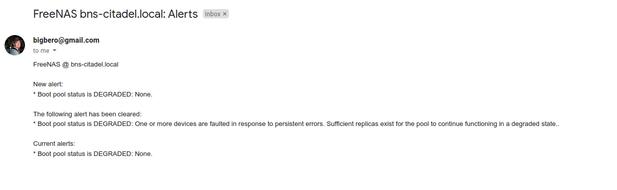

More boot pool notices.
ctag
Jun 16, 2017
225
A couple hours after getting that email, I tried to access a jail on the server, and found it was unresponsive.
As far as I could tell the server was totally locked up. No SSH, no ACPI shutdown, and no EMG shutdown when I yanked the battery backup (just to check). I wound up hard-resetting the box, and then it would not boot. I swapped the USB ports that the boot thumbdrives were in, and then it booted.
Since there was a checksum error on da7p2 again, I re-ran the `zpool clear` from earlier.
I bought another "SanDisk Cruzer Fit CZ33 32GB USB 2.0 Low-Profile Flash Drive" to replace this one that's errored out twice now.

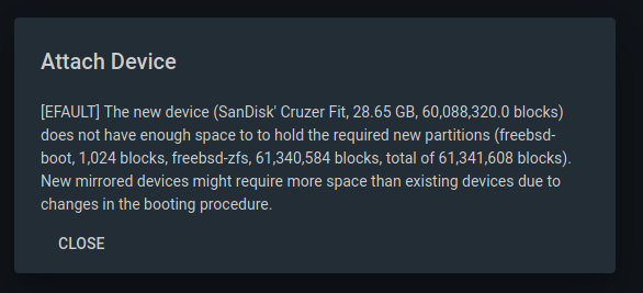

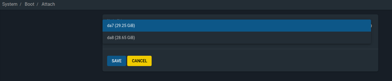

Replacement USB boot drive arrived today.
Noticed this when reading through the manual:
Good to know.
Since this is the first time I've done this, here's the process used:
  1. Shut down the box.
  2. Added the new usb disk. (good thing there's an extra USB port!)
  3. Booted box back up.
  4. Box won't boot.
  5. Reboot box.
  6. Still won't boot.
  7. Removed the new drive. Now box boots. (todo: find a monitor and check this someday)
  8. Hot plug the new drive and it shows up.
  9. Can't switch to the new drive because it's smaller.
  10. Give up to go whine about it online.
So I put the old, failing disk back into the mirror.
I super duper wish that I had somehow forced the original boot mirror to use 25 gigs instead of the whole ~30, so that this kind of discrepancy wouldn't be a show stopper.
ctag
Jun 16, 2017
225

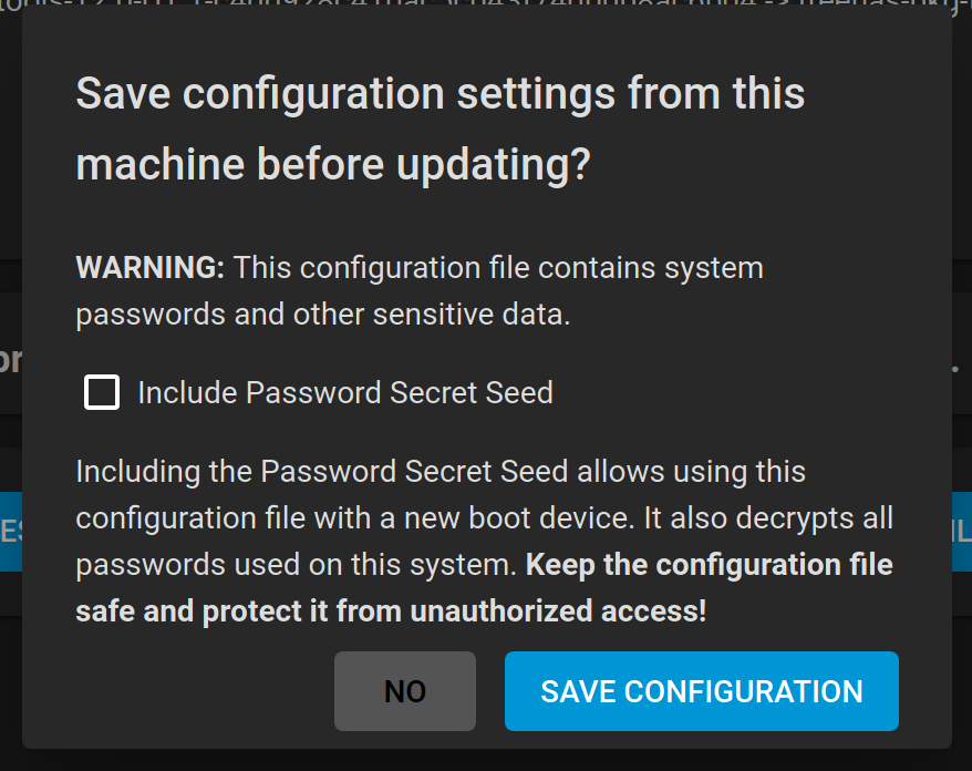

The obvious solution here is to back up the config and reinstall FreeNAS on the new mirror disks. And I'll do that, but first I noticed this in the manual:
To mirror the operating system device, move to additional devices and press spacebar to select them also. If all of the selected devices are larger than 64 GiB and none are connected through USB, a 16 GiB swap partition is also created.
That sounds pretty swell to me. On top of that there are posts I've made pretty far back in this thread complaining about USB boot drives, so it's definitely time to move on.

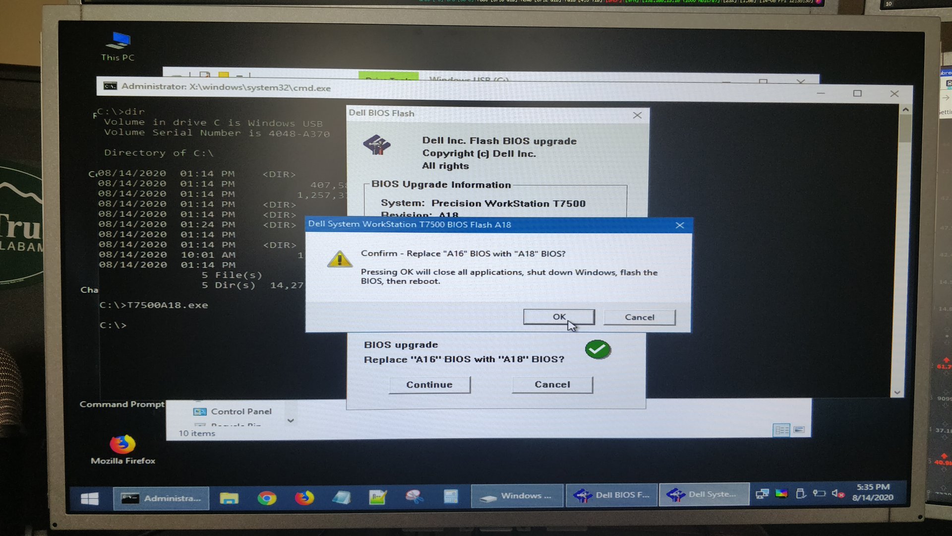

While digging around looking for documentation, I discovered that there was a new bios upgrade available for my T7500 server. There was a "Linux" download, so I thought to myself "how hard can this be?" and decided to dig in. I found a Dell support page that describes upgrading in a Linux-only environment, and from it's reading the Linux .bin upgrade seemingly isn't applicable to this server at all because it isn't UEFI... Instead they recommend making a live FreeDOS USB stick and launching the Windows .exe upgrade from there. OK... I dorked around with the FreeDOS stuff until finally it both booted and had the .exe upgrade file available, only to find that the executable returns "not compatible with DOS environments" and exits. Fantastic job there, Dell.
I wound up making a Hirens Boot USB drive (via MoeUSB) and ran the upgrade from there, which seemed to work well enough.
I also removed these weird SATA passthrough risers from the box. They kept the SATA cable's clip from being effective, and seemed designed for right-angle connectors anyway. One of them had a strange temperature probe thingy on it, which isn't configurable or visible from the BIOS and causes an alert on boot if disconnected. There's dispariginly little information about the probe or alert message online. I yanked it anyway.
Oh and here's a link to a shoddy operator's manual for my T7500.

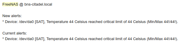

Last night, after dorking around, I put the side of the server back on. For a couple months now I've been running it opened to keep temperatures down, but I took a chance to rearrange the hard disks to try and improve air flow.
I woke up to this email:
New alerts:
* Device: /dev/da0 [SAT], Temperature 44 Celsius reached critical limit of 44 Celsius (Min/Max 44!/44!).

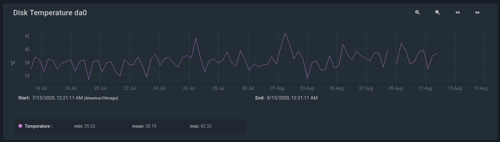

When I try to see what happened... It wasn't captured on the logging...
Sigh. I guess the spike up to 44 just missed the sampling point?
Luckily it was captured in the syslog:

So... Not likely a spike, but instead a sustained temperature... That isn't visible in the graphs (which show a maximum temperature of 42.3C).
I'm pretty frustrated with the Reporting tab in general too. Having each disk temperature on a separate graph makes comparisons less intuitive and more clunky, and some of the graphs refuse to populate at all. And my old friend, the scrolling javascript bug, is back:

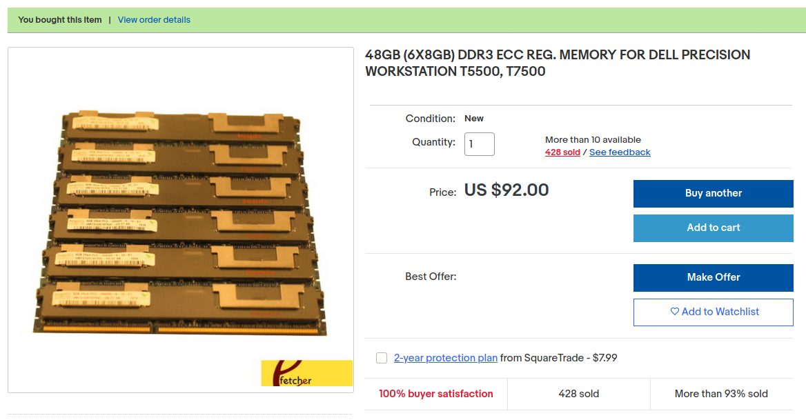

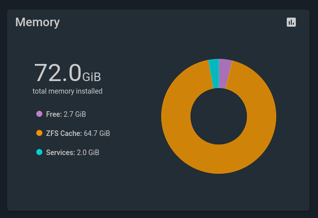

My new 48GB of RAM arrived! It's 6x 8GB sticks, and after completing the built-in memtest I found myself wondering "Gee, since I have this second CPU riser arriving soon.. And it has 6 additional RAM slots on it.. I wonder if I can combine my existing 24GB with this 48GB to achieve 72GB!" So I turned to the trusty (very) dusty manual for insight. On page 16 we see a review of supported RAM types, and then a breakdown chart of what RAM configurations are officially supported for both single and dual CPU systems:

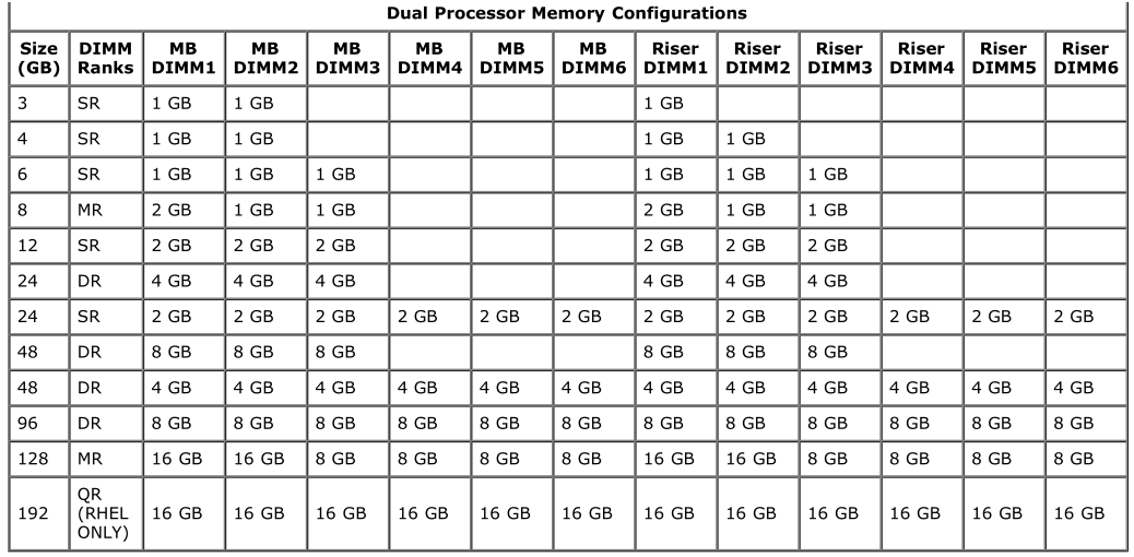

As you can see, none of the configurations deal with 6 8-gig plus 6 4-gig sticks like I want. But further down in the article there are Memory Population Rules:
Dual CPU configurations (6 DIMM slots on MB plus 6 DIMM slots on Riser)
If configuration contains DIMMs of all the same size, populate in the following order: MB_DIMM1, Riser_DIMM1, MB_DIMM2,
Riser_DIMM2, MB_DIMM3, Riser_DIMM3, MB_DIMM4, Riser_DIMM4, MB_DIMM5, Riser_DIMM5, MB_DIMM6, Riser_DIMM6.
If configuration contains DIMMs of mixed sizes, populate the larger DIMMs in the dual-processor riser.
So it looks like I'm going to be placing all 6 4-gig DIMMs back with the original CPU, and all of the new 8-gig DIMMs on the riser card. I'm glad I checked, because otherwise I was going to do a split arrangement with 36GB next to each CPU.

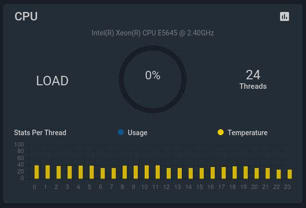

Installing the second CPU had a small hiccup. Initially the system failed to boot. It turns out the little plastic clip for the riser card gets worn out, and doesn't press the riser into it's motherboard socket well enough anymore. Putting the case side back on pushes on it and lets the system boot, but of course now the case side has to stay on.
It looks like I can use all of the RAM!

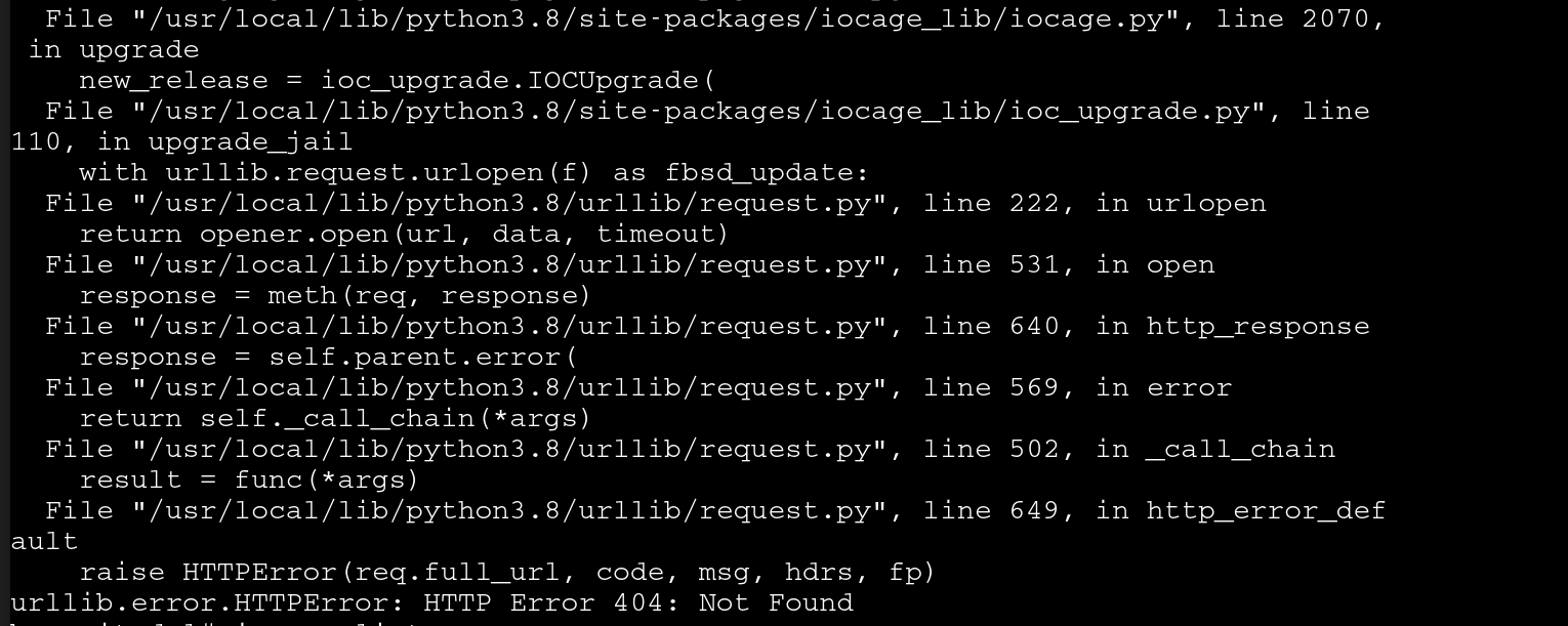

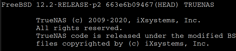

And one of my jails is failing to start after the upgrade. I get an error about devfs_ruleset not existing from iocage. Changing the ruleset from 5 to 4 in the jail edit UI allows it to start, but I'm not familiar enough with devfs to know what that did.

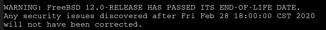

Upgrading jails to 12.0 to match the base system. Saw this line scroll past:
So 12.0 was EOL before TrueNAS 12.0 shipped? There's something unsettling about that dynamic where by the time IX is able to get a release out to the NAS users (which shouldn't be ultra-fast or anything, and they release plenty often enough for me!) it is already obsolete and not receiving security patches.
Upgrading jail failed.
Appears to be the same as: https://www.truenas.com/community/threads/freenas-truenas-upgrade.89655/
But I'm not sure I want to go editing iocage's files to get around it..

`iocage upgrade bns-xwing -r 12.2-RELEASE` still does not work though. AFAIK it's not urgent to have the jails match the base OS so I think I'm going to leave it until iocage is working again.

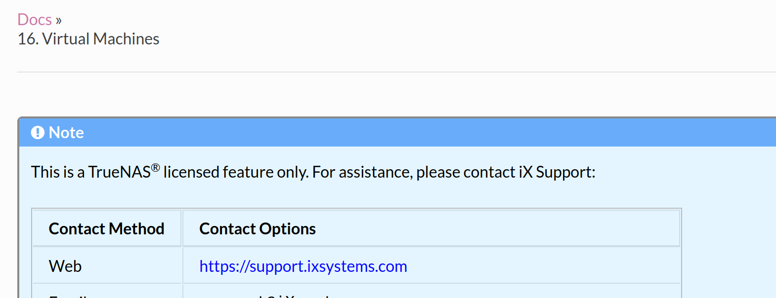

Trying to migrate a service from a jail to a bhyve VM so that it's newer version can have docker. Part of that migration is moving files, but I cannot seem to figure out what is going on with the VM disk, it isn't available mounted anywhere I've checked.
Went to the documentation to look for clues, but found this:
Is that an indication that VMs will be leaving the community version of TrueNAS?
9,700
You're confusing the old TrueNAS 11 documentation with the TrueNAS 12 CORE documentation... TrueNAS and FreeNAS are only the same product from 12.0 and the older TrueNAS (11 and before) was the Enterprise product (Now TrueNAS 12.0 Enterprise), which carries that limitation.
Check the FreeNAS 11.3 documentation instead. (the TrueNAS 12.0 CORE documentation is sadly not great to work with and the products have enough in common that you should be able to figure it out).
Since the guest VM disk is a ZVOL (block storage) TrueNAS can't see it and won't mount it.
You can connect from the VM to the host over NFS or SMB to copy files. The internal bridge for the VM should operate at 10Gbit, so should not be a bottleneck.

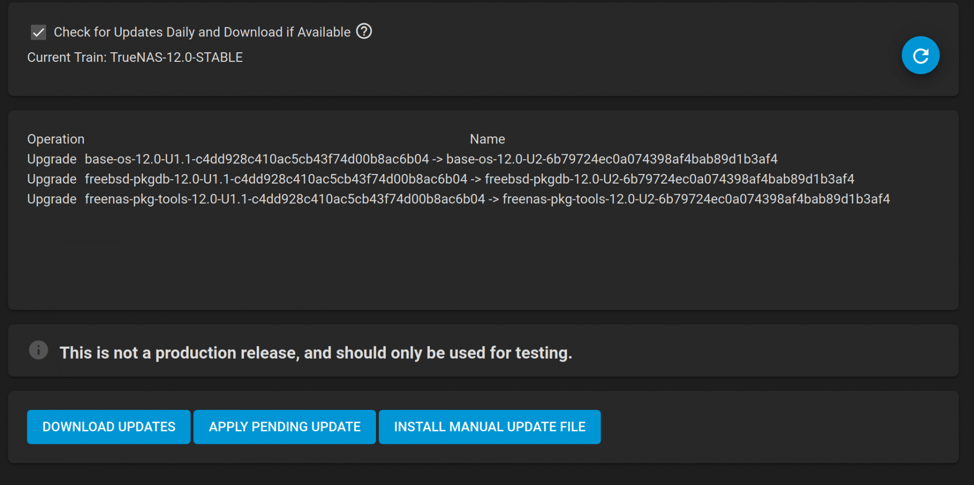

An update for 12.0-U2 is available. The release warning is still present though.
I thought that was just a temporary bug?

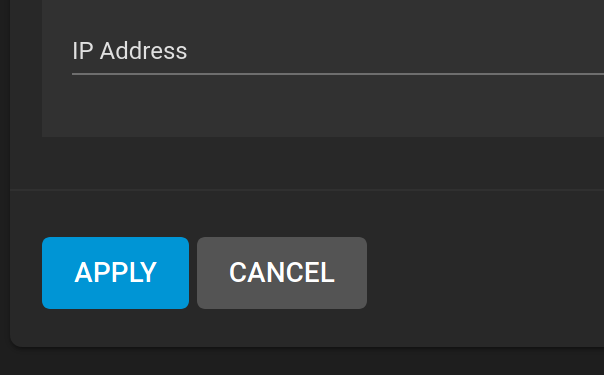

And I've noticed the web UI has a dangerous habit of theming buttons to appear as though they are disabled outright. Either disable the button or don't, the 'primary' color setting already allows the designers to be opinionated and highlight the default choice.
Here's another button that is not disabled:
And an actually disabled button for reference:
On a cursory glance I can't even find a disabled secondary button. It seems the web UI prefers to hide the button entirely if it is not actionable, which I don't believe is a bad rule in itself but it does lend to the maze-run that attempting common tasks can become.
